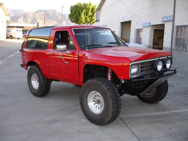

The Solo Motorsports Ford Bronco II is probably one of the better-known Bronco II prerunners built.
The Bronco II still has its 2.9L V6 and factory 5-speed, but the front axle was swapped out in favor of Solo’s 4-inch wider (per side) cut and turn Dana 35 and extended radius arms. A pair of King coilovers and bypass shocks at all (4) corners helps smooth out the ride across the desert. It all rides on a set of 35-Inch BFGoodrich Baja T/A’s.

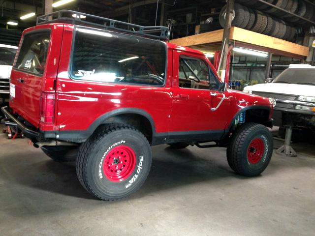

To balance out the weight distribution, the spare 35-inch tire was eventually moved forward of the rear axle, and the camping, tools, and recovery gear sits as close to the front seats as possible.
Solo Motorsports Ford Bronco II - Left Front
Solo Motorsports Ford Bronco II Prerunner

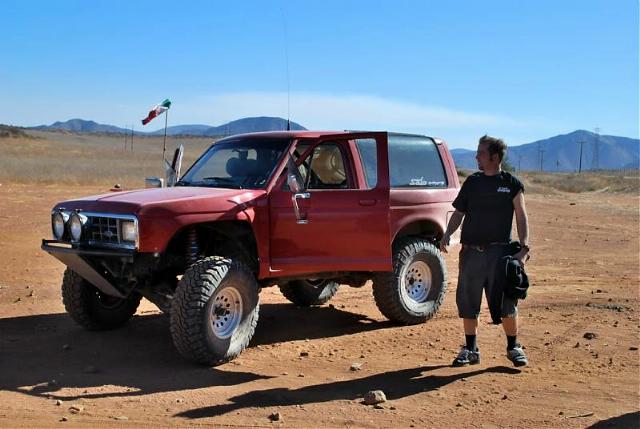

Ford Bronco II PreRunner

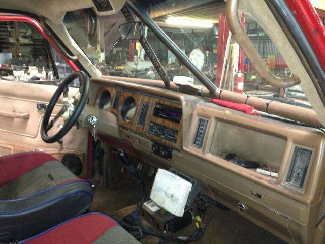

Ford Bronco II interior roll cage
