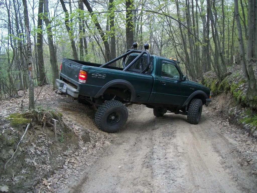

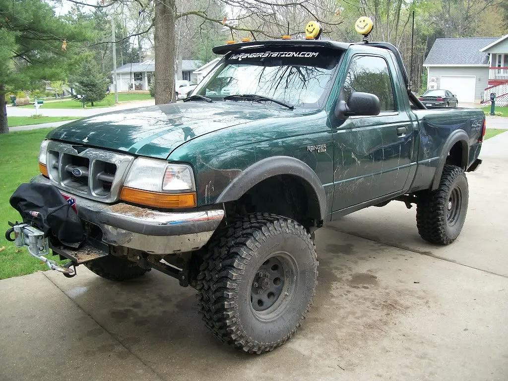

The first changes were relatively simple. A three-inch body lift, torsion-bar adjustment and two-inch rear lift shackles gave the Ranger more room for larger tires. He also added an external sun visor with running lights, giving the truck a distinctive look.

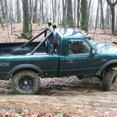

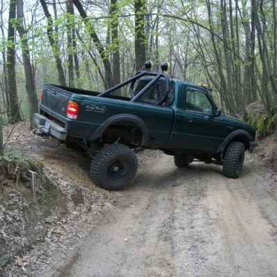

The next step was a homemade cowl-induction snorkel. Rather than simply buying accessories, ozziemo27 was willing to make things work for his own truck. That same approach showed up when he adapted a full-size GMC roll bar to fit the Ranger, doing the fabrication himself.

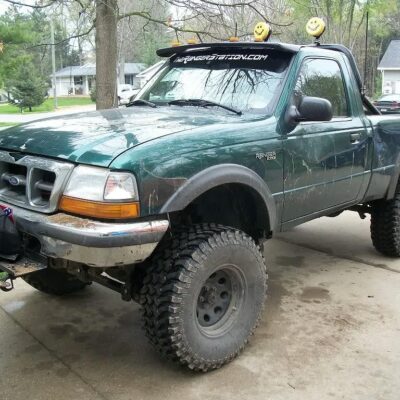

The truck eventually landed on a set of 33×12.50R15 BFGoodrich Mud-Terrain KM1 tires mounted on 15×8 Cragar Soft 8 wheels. The wider tires filled out the wheel wells and gave the Ranger the stance of a truck built to see more than pavement.
Suspension Upgrades
The body lift and torsion-bar adjustment were only the beginning. After rolling the truck onto its side during the winter, ozziemo27 acquired a used four-inch Superlift suspension lift from an Explorer that had been cut apart. He paid $460 for the setup, then sandblasted and painted the components before installing them.
The installation included new Moog upper control arms and lower ball joints, with tie-rod ends and brakes also on the list for replacement. It was a practical way to get a suspension lift without paying the price of a brand-new kit.

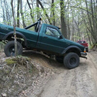

Out back, he replaced the factory leaf springs with a three-leaf setup using 63-inch Chevy springs. The longer springs provided additional suspension travel, and the truck’s trail photos showed the results. The Ranger was still running its independent front suspension, but the combination of lift, tires and rear suspension modifications made it a capable-looking trail rig.

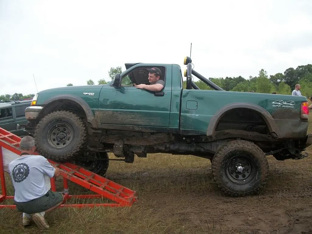

Ozziemo27 1999 Ford Ranger RTI Ramp

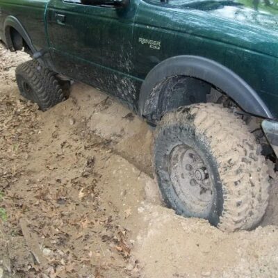

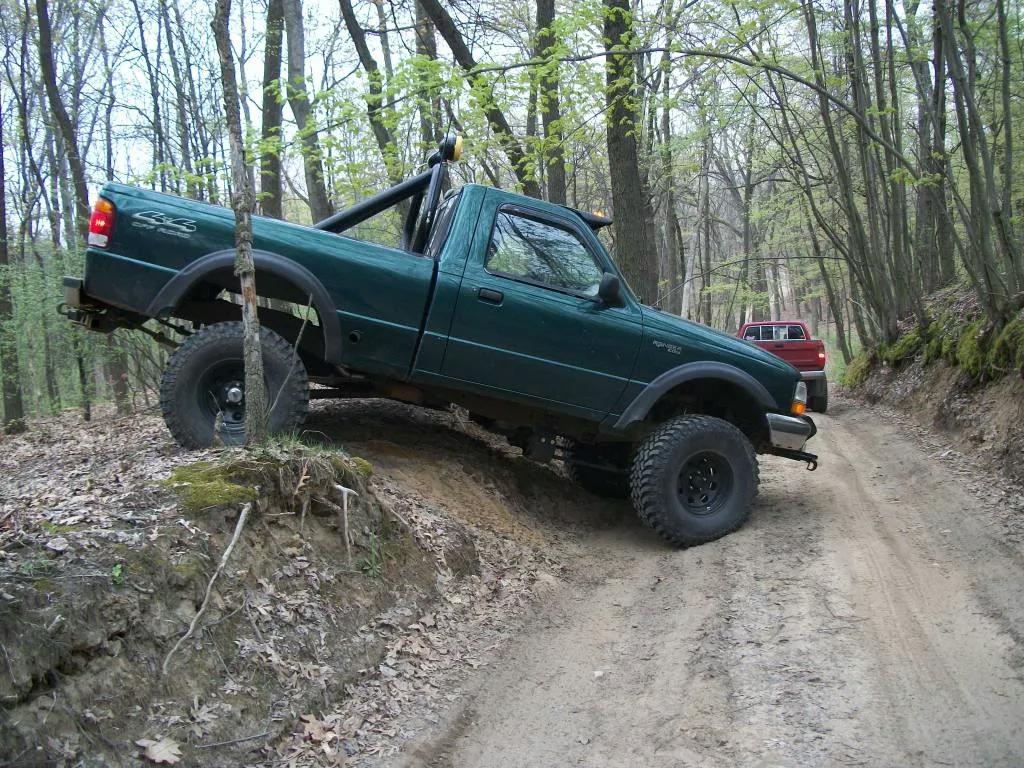

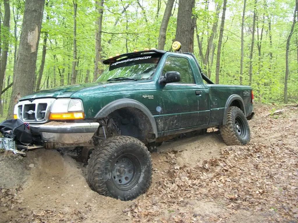

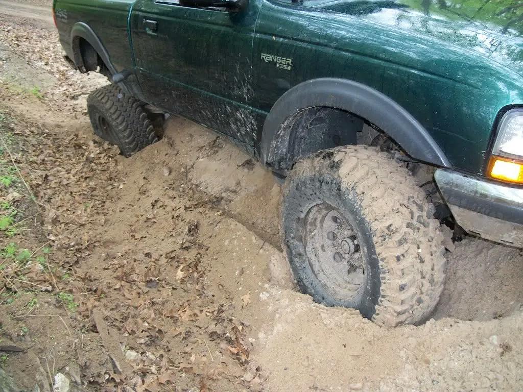

This wasn’t a show truck being kept pristine. The thread includes photos of water crossings, trail obstacles, body damage and the occasional mishap. The busted taillight and flooded interior were part of the experience, and even the winter rollover became another chapter in the truck’s development.

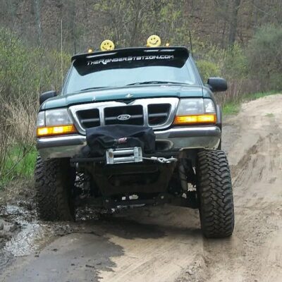

Other details helped make the Ranger more useful off-road. A Smittybilt XRC8 winch provided recovery capability, while a Flowmaster Super 44 exhaust with a 2.5-inch cat-back system exited at the side to keep the exhaust tucked out of the way. A homemade roll-bar installation, KC Daylighters, auxiliary gauges and a Cobra CB radio rounded out the truck.
