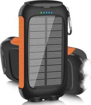

Cell Phone Charger – If all you’re concerned about is keeping your cell phone charged while camping, then you can get a Portable Solar Cell Phone Charger.
(Portable Solar Cell Phone Charger)

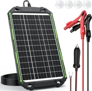

Battery Tender – A Solar Battery Tender (Maintainer) will help keep your battery charged if you plan to let the vehicle sit for extended periods of time. They work by plugging in to your cigarette lighter, or some also come with cables to clamp it directly to the battery.
Important: The style that plugs in to your cigarette lighter will only work if the lighter works when the key is off. If your lighter jack only works with the key on, then you’ll need to use the battery clamps, or either rewire your lighter jack so it always has power, or added a secondary jack.
Also, not all solar battery tenders have a voltage regulator to keep it from over charging.
(Solar Battery Tender)

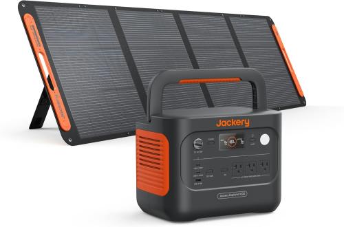

Portable Solar Power Kits – You can buy Portable Solar Power Kits that you can set up anywhere to offer either 12-volt or household AC current.

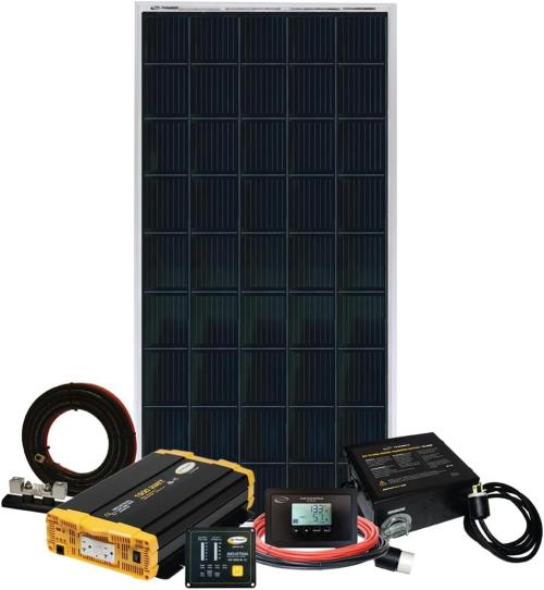

What You Should Buy:
You’re better off getting a complete system than trying to piece something together on your own. This will ensure that everything is compatible and you get the best performance.
For me, the Go Power 160 Watt Weekender SW Complete Solar Kit With Inverter looks to be the best setup for me. It’s a complete kit (minus battery) that includes an inverter
