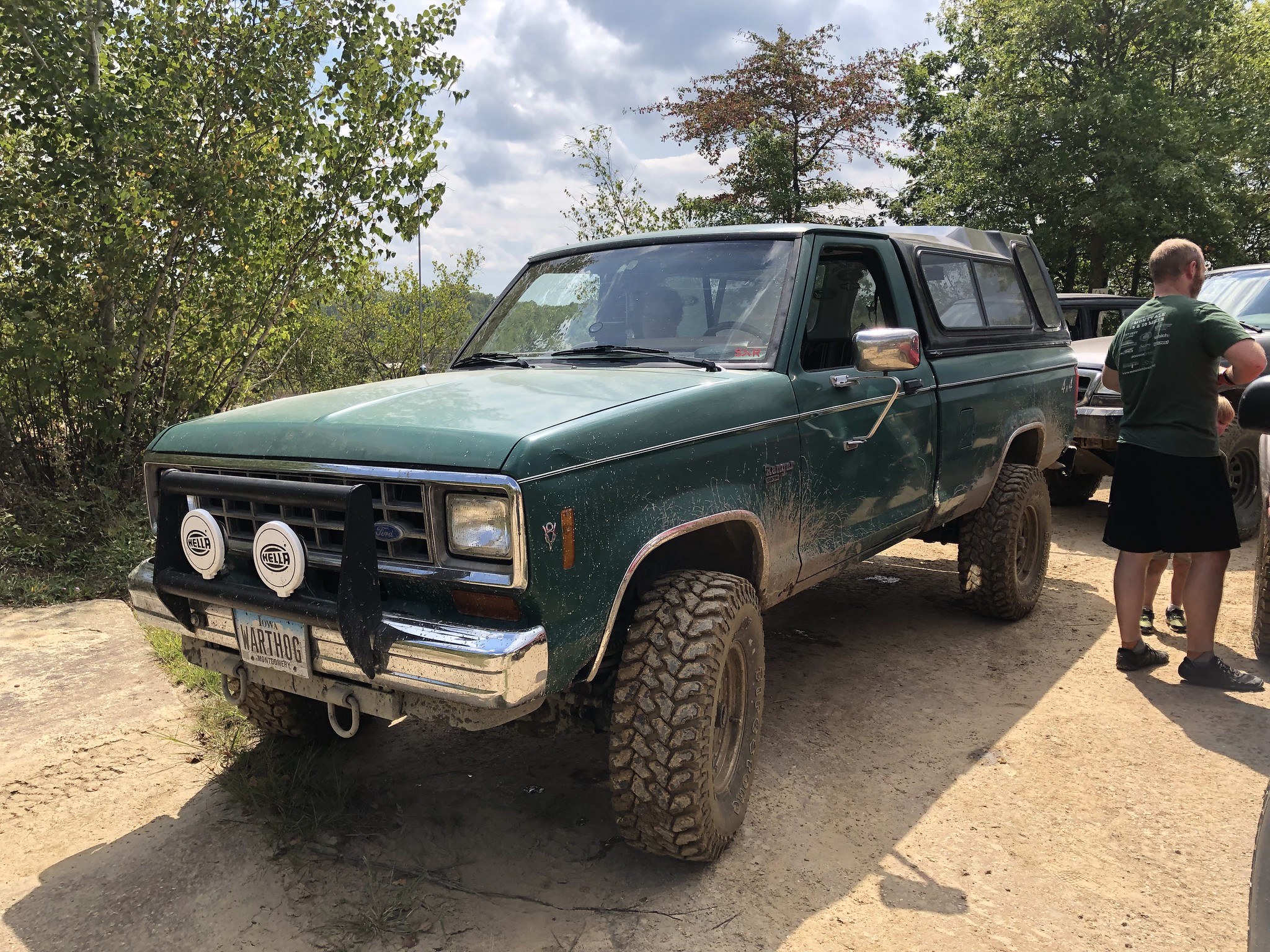

Justin Russell (85_Ranger4x4) is one of our forum moderators, and has been a member since 2002. Justin got this 1985 Ford Ranger 4×4 while in high school, and has owned it ever since.
As you can see on the license plate, Justin calls the Ranger the ‘Warthog’. A Warthog is defined as “A symbol of being vigilant. It’s ability to sense the presence of danger and the courage to face it.”

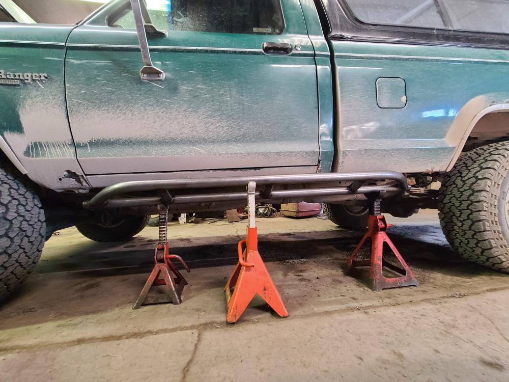

  • Custom rock sliders

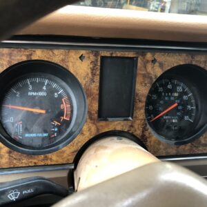

  • Ford Ranger overhead console with map light and clock

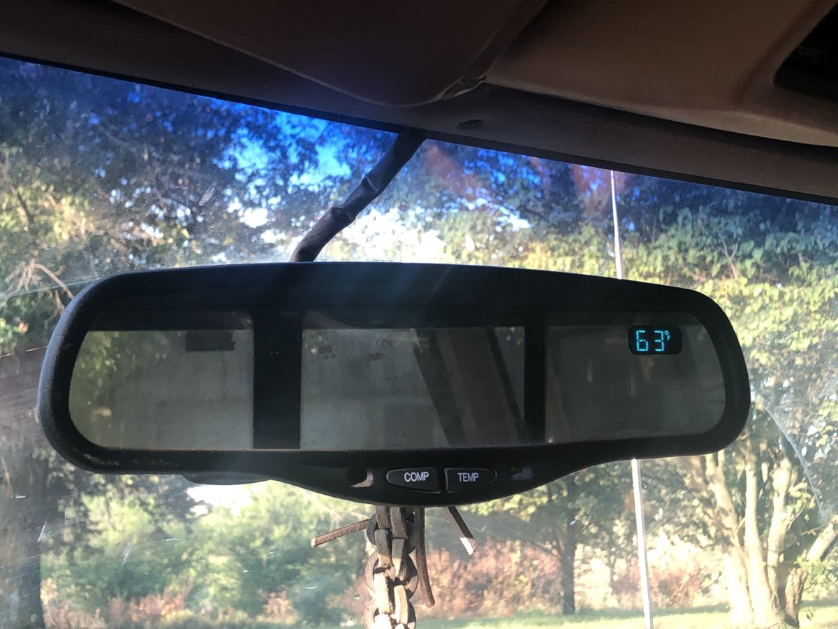

  • Dimming rear mirror with temperature display

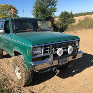

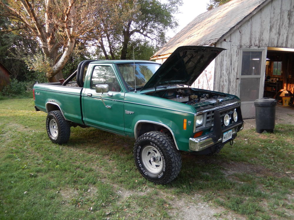

Looking at the list of specifications you suddenly realize that there’s much more to this Ranger than what you initially see. As Justin has modified his Ranger, he’s done so in a way to make it look like it could have came from the factory that way. His V8 swap is another example of that.
Justin found the proper air cleaner and inlet hoses along with the distributor cover to make the engine look period correct for 1985.
He also managed to locate an early Ford Ranger overhead console with a map light and clock. Also note the updated rear view mirror that displays the outside temperature.

But he also has the roll bar for the bed for the classic early Ranger look if he wants to shed the camper shell.

The first time I had the chance to see this Ranger in person was when Justin drove it from Iowa to Ohio for our 20th Anniversary Trail Ride. Having owned a 1983 Ranger 4×4 that I converted to a V8, I expected to see this truck overheating on the trails. It didn’t. It didn’t break anything either.
Then I saw it at our Fall Round-Up in Attica Indiana in 2020. Again it never overheated, and never broke anything.
The fact that it performs so well and that Justin has driven it so far to off-road it and drive it back home has impressed me. The fact that it’s a 1985 and they’re becoming more and more rare makes me happy to see it show up for events.
