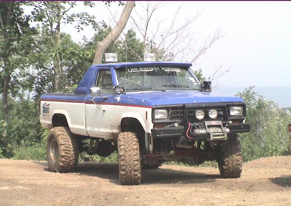

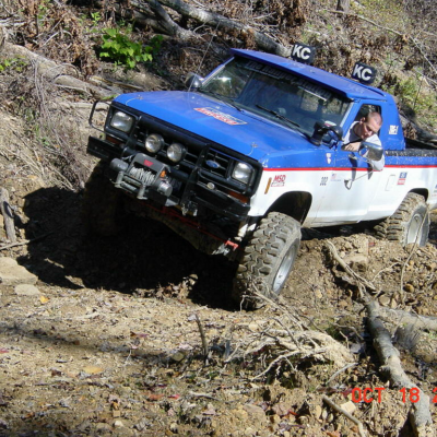

I added a Performance Accessories 3-inch body lift and Skyjacker 2-inch front leveling coils to the Ranger which made room for some 31×10.50×15 Trailhandler Radial A-T tires on 15×8 chrome modular wheels. I made a template for a grill guard and a friend of my father’s made it for me out of 1/4″ steel plate and two steel tubes. I mounted a pair of 6-inch KC off-road lights to the grill guard.

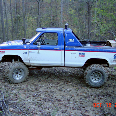

I didn’t like the Rangers stance, so I decided to install a Trailmaster 4-Inch suspension lift. The 4-inch lift made room for 33×12.50×15 Sentry Sport tires. I knew they wouldn’t fit on the chrome wheels I had, so I mounted them on a set of used 15×10 white ‘Wagon Wheels’. I also decided to ditch the rear step bumper for a Lund Tailmate which was basically a fiberglass panel that filled in the gap between the bedsides under the tailgate.

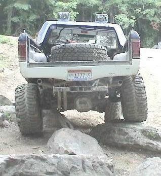

The steering received an upgrade thanks to a Superlift Superrunner steering setup, and the suspension gained more wheel travel thanks to a pair of Skyjacker extended radius arms. I changed out a dual front shock mount I had for a pair of Desert Steel shock hoops and Skyjacker shocks. There was also a dual shock kit on the rear, so the Ranger had 2-shocks at each wheel. It’s funny because multi shock setup use to be common, but you hardly see them anymore. The Ranger now had Trailmaster, Superlift, and Skyjacker components under it.
I managed to get a deal on a Warn XD9000i winch and needed a place to mount it. My friend Bob Osborn and I took a rear step bumper, added a receiver hitch under the front of it, attached my grill guard to it, and mounted the whole thing to the front of the Ranger. We then mounted the winch onto a winch plate welded to a receiver and mounted it to the truck. I used 1/0-gauge welding cable with quick disconnects so that I could remove the winch, and added a receiver hitch to the rear so I could winch from the back if I wanted to.
The 302 had come with a 2-barrel carburetor and intake, so I decided to rebuild the engine again and install an Edelbrock Performer intake manifold, Summit Racing camshaft, Holley Avenger 4BBL carb and an MSD ignition. I also installed a Griffen aluminum radiator and Flex-A-Lite electric fan to keep it cool. I also removed the hood scoop and added a snorkel made out of PVC. I didn’t like the hood scoop because it created a vision obstruction when I would drive over embankments.

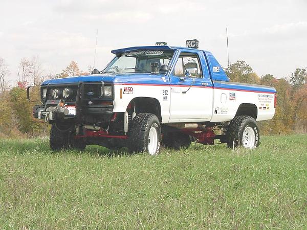

It’s funny, but I started referring to the Ranger online as TRS-1 even though there wasn’t a TRS-2, or any plans for one. Now that I had The Ranger Station, I removed the Ford Motorsports logo and added TheRangerStation.com to the truck.

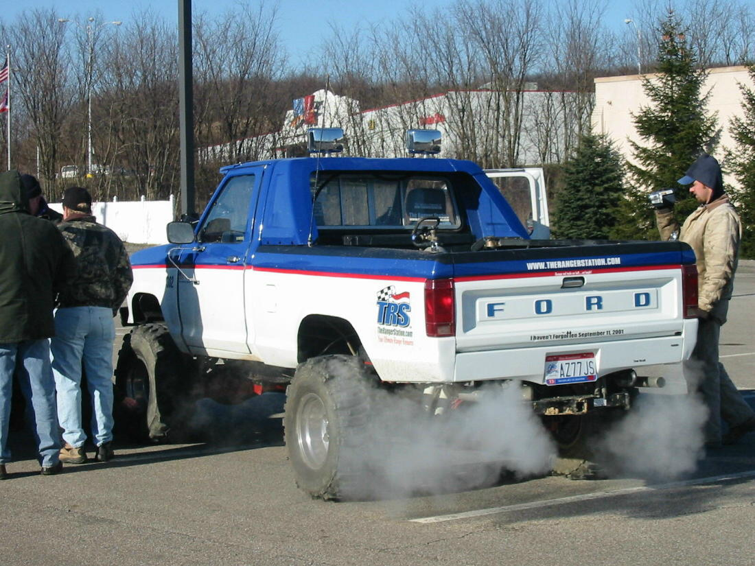

In 2002 I had a sign shop help me come up with the TRS logo and eventually added it to the Ranger’s bedside. As the owner of The Ranger Station, I was hosting spring and fall ‘Round Ups’ which were weekend off-road gatherings. One of the friends I made online that came out to these events sold me a pair of Interco 33×12.50×15 Super Swampers and a pair of Interco 33x14x15 Boggers on Mickey Thompson Baja wheels. I had also ditched the Dana 28 front axle and Ford 7.5-inch rear axle for a Dana 35 front and a 31-spline Ford 8.8-inch rear. The rear came with a Trac Lok and my friend John Steinbinder installed a set of Yukon 4.56 gears. He also installed a set of Yukon 4.56 gears in the front with a Lock-Rite locker. The combination of the V8, 4.56 gears, and those Boggers made this a really fun truck to play in the mud with. I ended up trimming an inch out of the fenders because my tires kept hitting them.
