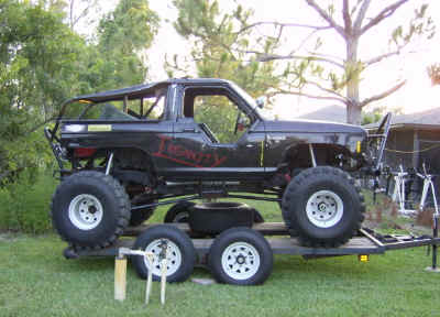

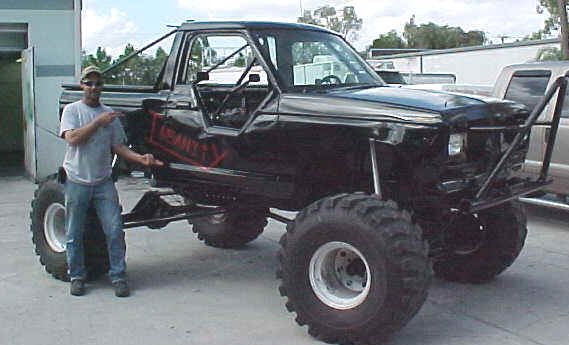

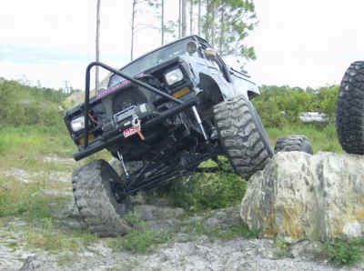

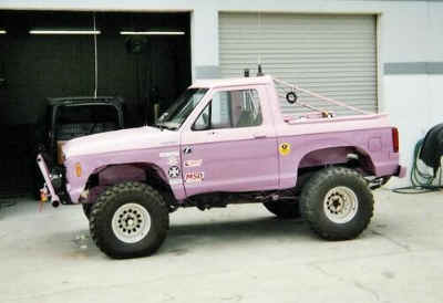

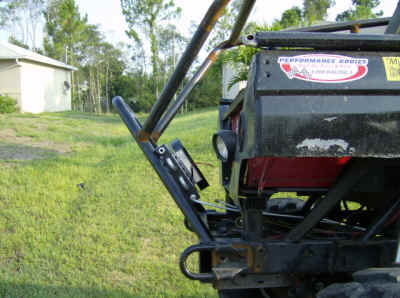

After some looking, I came across Ted Harmon’s (redneckwelder01) 1988 Ford Bronco II that he named ‘Insanity’. Ted bought the Bronco II in 1995 for $300.00 to use as a mud truck. He cut the fenders to fit 33’s and wheeled the truck for 7-years. A few of his friends got involved in rock crawling in 2002 and invited him on a trip to Tellico. Ted quickly found out that there was a big difference between mud and rock crawling. His first problem was the lack of articulation and power. On that first trip to Tellico Ted backed into a tree destroying the rear hatch. After returning home he cut off the back half of the top with a gas-powered concrete saw. He also added a 3-inch body lift and 4.10 gears. A friend at a local body shop offered to paint the Bronco II for free. When Ted went to pick it up, he found that the Bronco II had been painted pink and lavender. It was meant to be a joke, but Ted got him back by driving it that way for the next 4-years. In 2005 Ted ripped a hole in the gas tank and decided to replace it with a 33-gallon fuel cell in the ‘bed’ of the Bronco II.

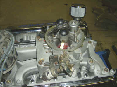

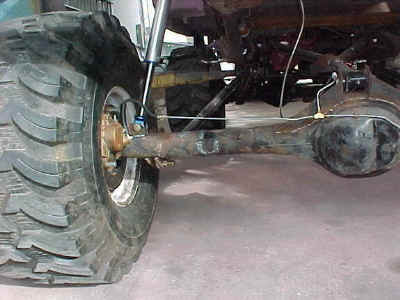

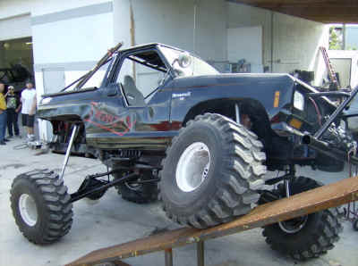

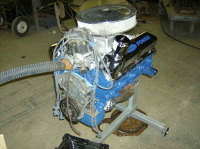

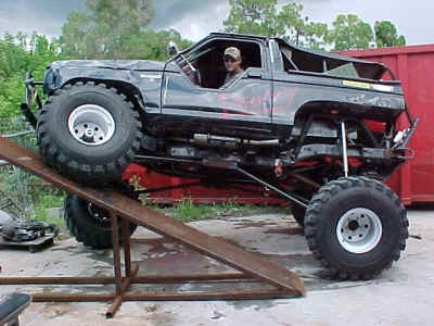

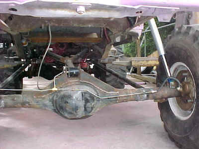

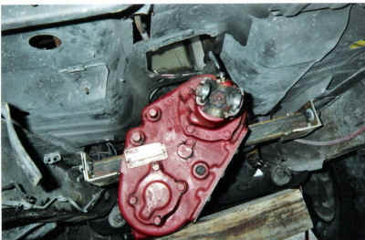

In 2006 he destroyed the front ring gear and snapped a rear axle. It was then that project ‘Insanity’ began. Bitten by the rock crawling bug, Ted started gather parts to turn the Bronco II in to the insane creation pictured at the top of this page. Ted got a 302, C4 automatic transmission and Dana 20 transfer case from a ’76 early Bronco. The 302 sits on custom mounts made to mount the motor up in the frame so that only the transfer case is exposed. The transmission shifts using a B&M Z-Gate shifter. A Dana 44 from a ’78 Bronco and a Ford 9-Inch from a ’77 F250 were all gathered up. Ted went through the axles with new bearings and seals and installed 5.13 gears. The front axle has a locker, and the rear has a mini spool. The rear 9-inch also received a disc brake conversion.

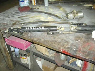

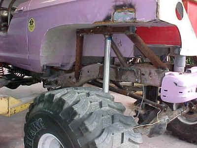

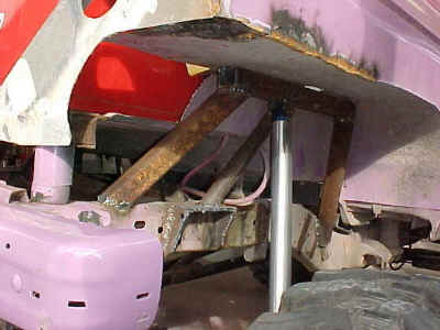

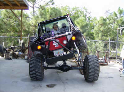

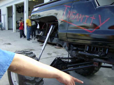

The front suspension uses ’77 F250 radius arms that were extended to 50-inches. At first, he used 6-inch lift coils for an early Bronco. Ted didn’t like the setup and replaced the coils with Fox 2.0 Air Shox (Nitrogen filled). The front Trac-Bar is from a Jeep TJ. The rear suspension is a 4-link wishbone setup with 56-inch lower bars and 40-inch uppers. The upper bar is a basic Y style, one point on top of the pumpkin, and two points on a crossmember on the frame. Ted did some tire trading and scored a set of 17/40x15LT Ground Hawgs.

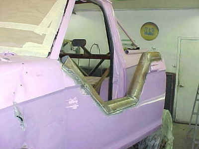

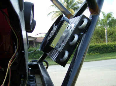

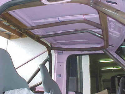

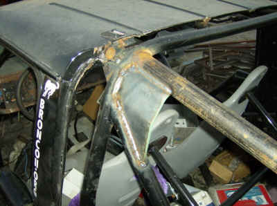

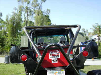

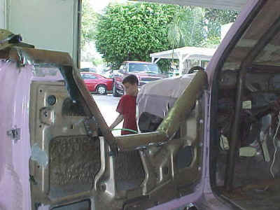

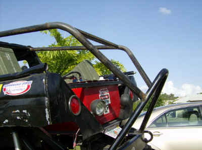

The Bronco II’s doors were cut down and capped off with 4-inch exhaust pipe cut in half. The tops of the rear tubs were enclosed to create storage compartments. The Interior sports a 12-point Jegs cage, racing buckets and Simpson 5-point harnesses. Tunes are provided by a Jenson double DIN Marine stereo w/ removable face, CD, cassette, a 6-disc changer and a remote that works both. Two West Marine 100w 5-1/4″ sealed round speakers and two Sony 5-1/4″ 60w speakers (not waterproof).
We look forward to seeing more photos of Insanity on the rocks in Tellico. Teds got a nice rig and claims to only have $4,500 invested in the truck including its initial purchase price. Insanity should inspire others that they can build a capable trail/rock crawling rig on a wallet friendly budget. Rigs like this are what can come from trading parts and shopping using resources such as Ebay.
