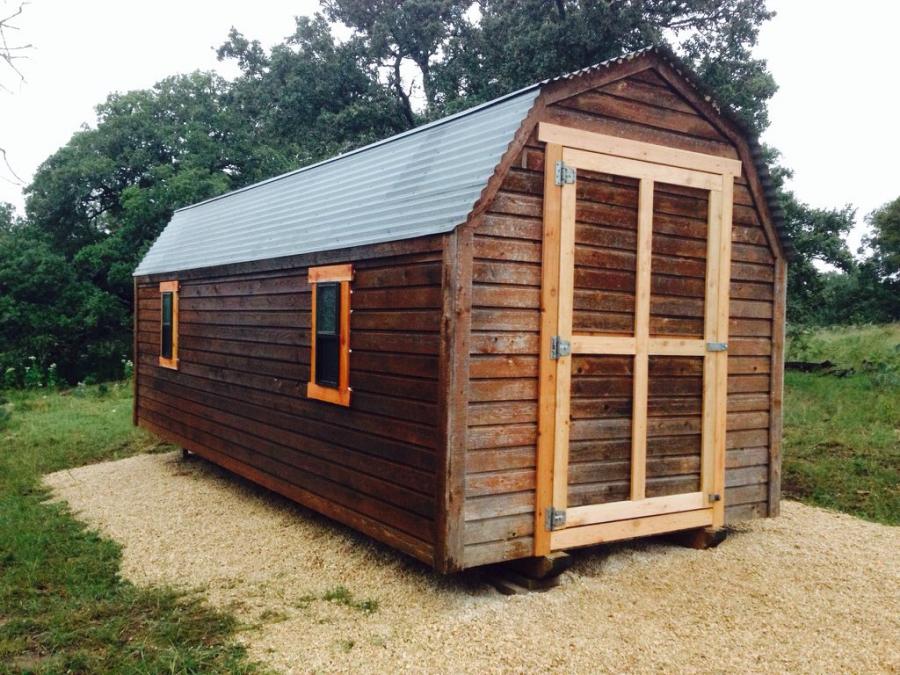

Havent had time to jack with anything been busy rebuild this shed for my grandma
