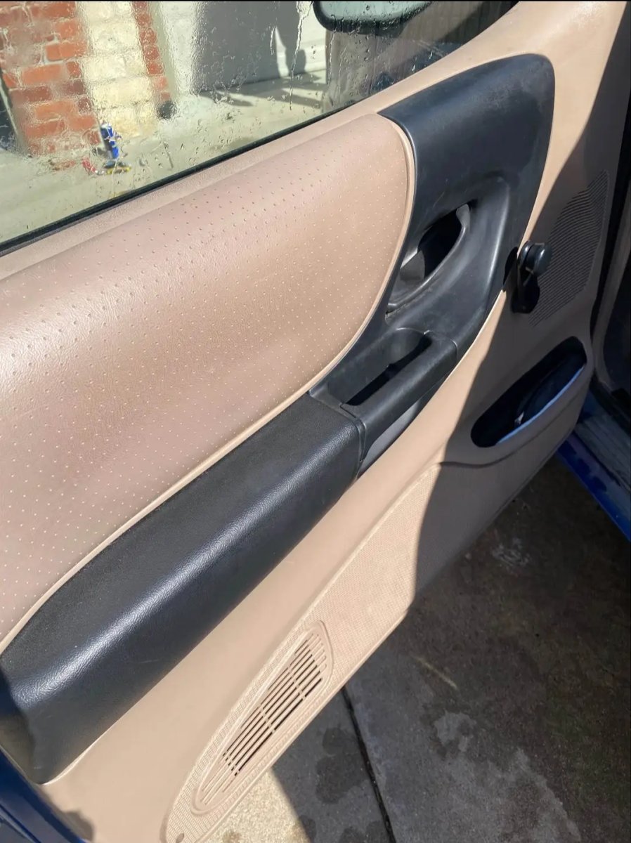

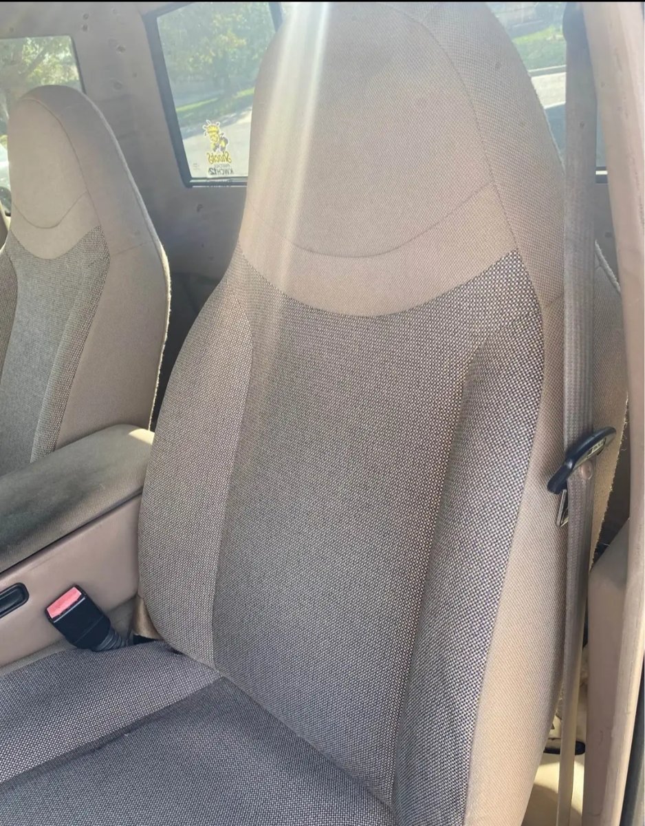

The truck needs a deep clean on the exterior and the interior will be a breeze, I love to detail/clean my vehicles, but this is very clean as it sits. Already removed and cleaned the armrest, it looks new now. I'll try and do better with more pics in the future!

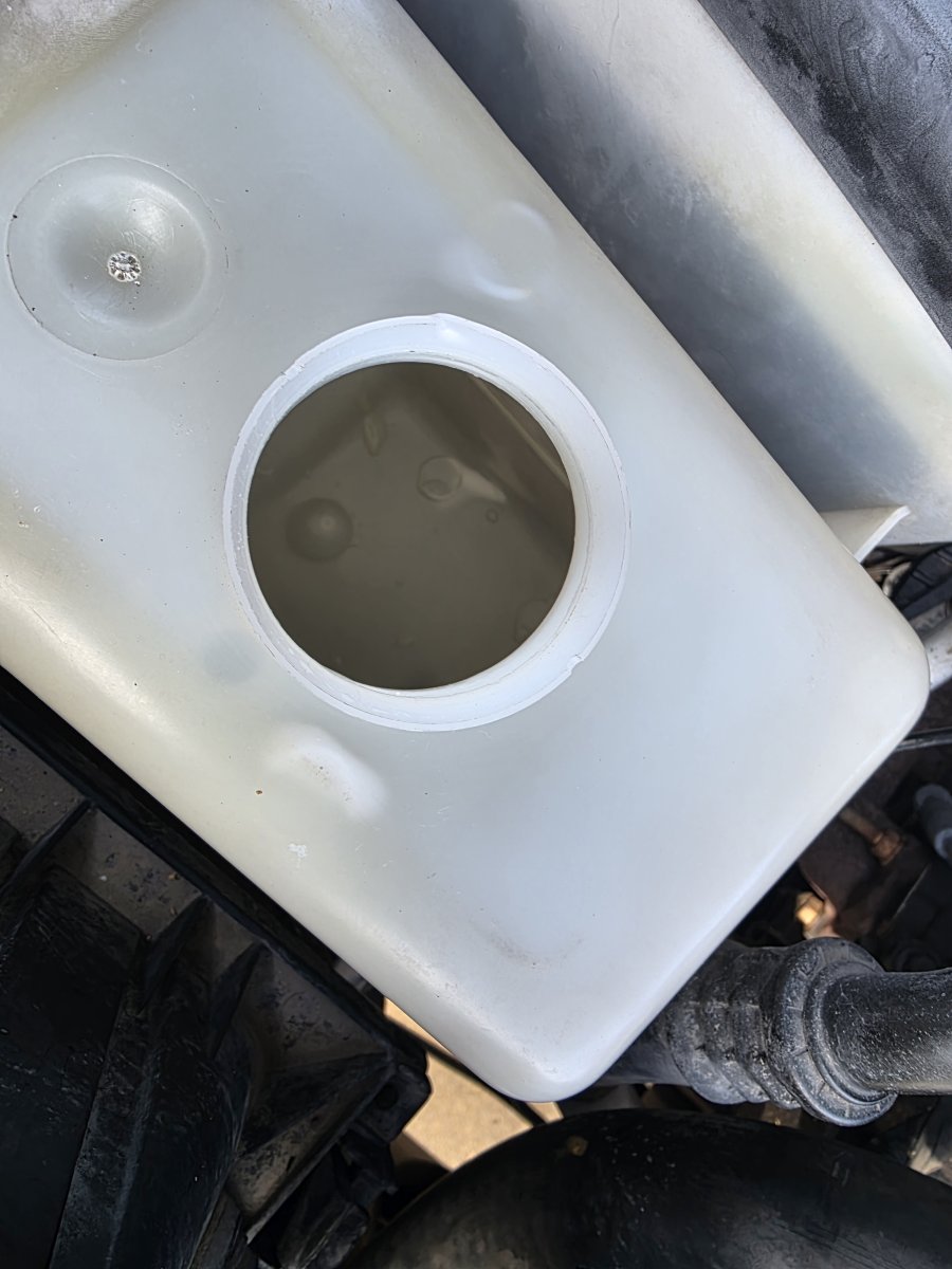

Coolant flush today, system was filthy. Took 4 flushes using distilled water, 1st flush I used the Motorcraft VC-1 coolant flush. 2 gallons of Prestone green concentrate, Motorcraft thermostat and temp sensor were replaced as well. Got the 24 year old overflow bottle pretty clean ;)
