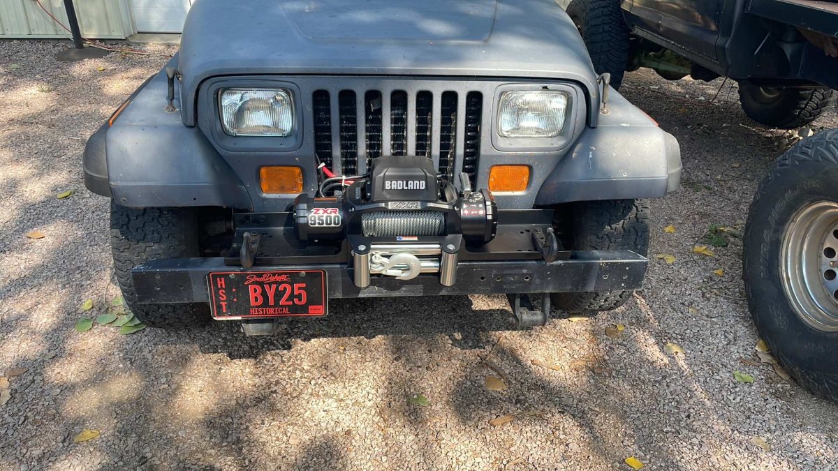

So that dumb vacuum CAD thing on the front axle apparently has not worked since I got this thing... our offroad event over Labor Day was somewhat awkward in 2wd, I found out about that when I couldn't make it up a hill. One of the nipples on the vacuum thing was rusted off.
I did the normal thing and instead of fixing it I bought a winch.

I've been away a long time so I might be missing an obvious joke and/or reference, but is that a real antique plate?
When I look at that Jeep my brain says "new Jeep"... does that mean I'm just old? 😬😬
