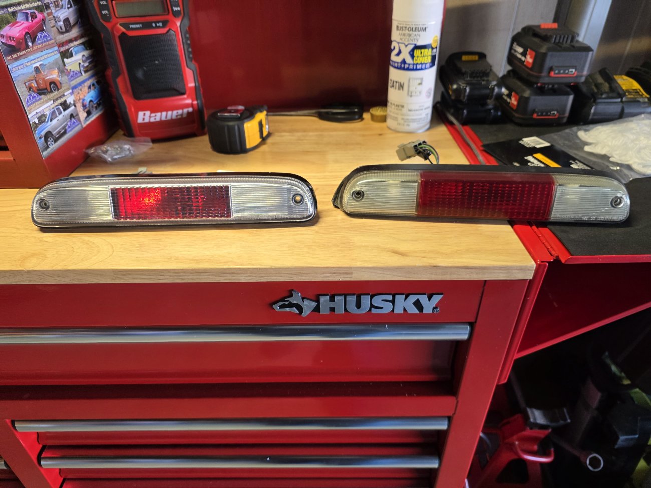

Recently installed a Pioneer Dmh-1770nex and 4 Pioneer 6x8 speakers. Also did new AVS ventvisors and ordered a new third brake light off ebay. A guy has a bunch on new oem old stock for $39.99 or make offer, I offered $20 and they took it.

New old stock CHMSL vs old

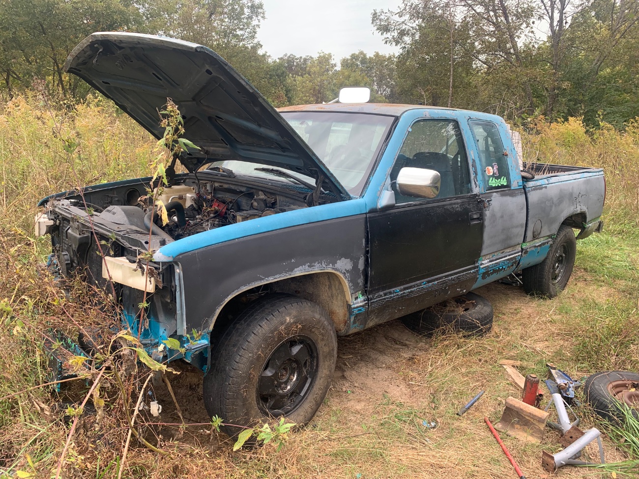

Heather’s ended up being my $300 (buddy deal) 1992 K1500 ecsb, complete with a 335rwhp 350. She was terrified behind the wheel of my wife’s 06 Pontiac Vibe. She was a cross of Mario, Mickey (Thompson, but Mouse would fit too) and Dale in that beater Chevy… And yes, she fubar’d the truck…
He fubars it, he's walking to high school for 4 years, lol
Getting ready to harvest the 350 for a Squarebody lowrider build. Transmission, t-case, rear axle, LCAs and frame are all pretty much destroyed. Can’t even open the driver side door enough to get in. She apparantly was playing “Dukes of Hazzard”, into a 3’ diameter tree… Only reason she walked away was the 6” structural I-beam front bumper.
