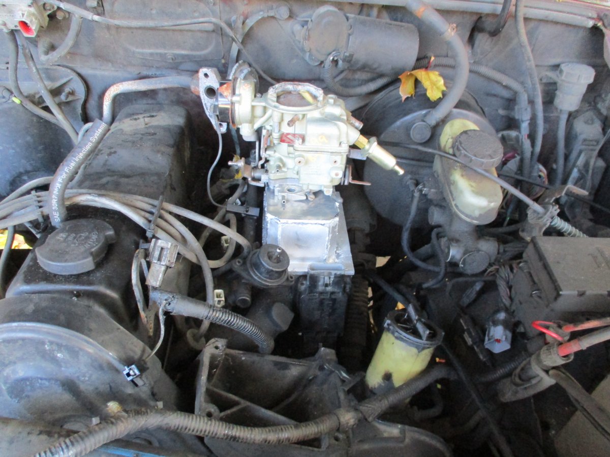

Too cold. Keep breakin' stuff. I pulled the carb that broke at the flange and discovered the intake manifold was cracked as well. The temps have been in the 20-35 degree range so there's no way I split several inches of aluminum with a 3" little weenie wrench on my own.
Last weekend I went back to the junkyard and got a new manifold, carb, and a carb spacer with PCV since the new 2100 doesn't have a bung for it. This carb is out of a Granada and the spacer is out of a VF100 van. The manifold is a couple years newer, out of an '87 Ranger with a feedback carb I'd never seen before. I did not get the feedback carb because I didn't want to mess with it.
I solved a major fuel pooling issue - drank a ton of beer when I ordered the intake manifold gasket and didn't look twice (duh... the head I took from that '84 Ranger wasn't an '84 Ranger head...) so I bolted a round-port gasket into an oval-port head. Made some big lakes and big smoke signals...
So, long story short, second manifold and carb are on as of tonight. Still have vacuum leaks. The motor pulls maybe 10-15 inches vac in the first few seconds of running, then vac just tanks and she sputters out. I think it has to do with my PCV spacer hack so if I go get the right tool I can get a plug out of the manifold I can route the PCV into instead.

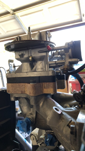

If you want to do this conversion, this is for you. The 2100/2150 really aren't designed for the 2.3 even though the ubiquitous "Scheffield" manifolds have the same flange. It doesn't fit. You do need spacers and you will need to pull the choke housing & run a manual choke conversion kit, else you're hitting the lifter cover with the choke and it won't bolt up. Also, don't do this in below freezing temps like me, you'll break the extra brittle pot metal used in these parts and you'll be mad as hell that you have to do it all over again. MAKE SURE your carb has all the vacuum ports that you need or you have a vac breakout or else you'll be stuck trying to hack things together.
I spent a lot more time out there today. It no longer leaks out of the gap between the spacers and the manifold, it leaks out of the throttle plate itself. If your kids ever had those wood carved train whistles, that's the sound it makes when it puffs and quits. It seems to blow its fine misty carbed fuel-y goodness right out of the hole where the main throttle shaft extends on both sides of the shaft indicating a major leak. Seems this carb may also be shot... Even the carb with the broken flange ran better than this one. They're rare enough as-is in the yards here. I'm debating whether to hit the busted flange unit with JB Weld or to get another carb & kit from the yard.

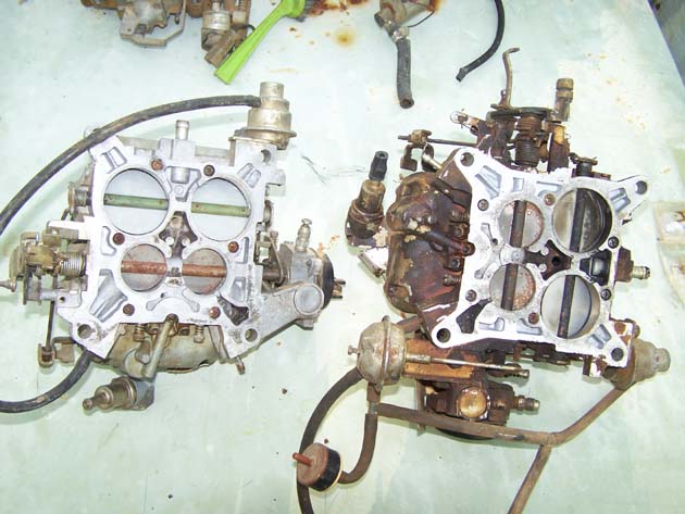

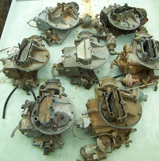

I've got some old carbs in a shed out back, been there a long time and likely rather oxidized by now.
Here's what they used to look like

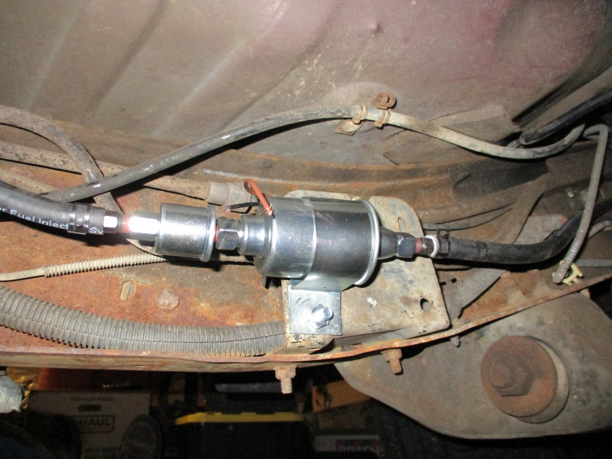

Fuel Pumps
34773
Two Barrels
34774
Four Barrels

Bottom side
34776

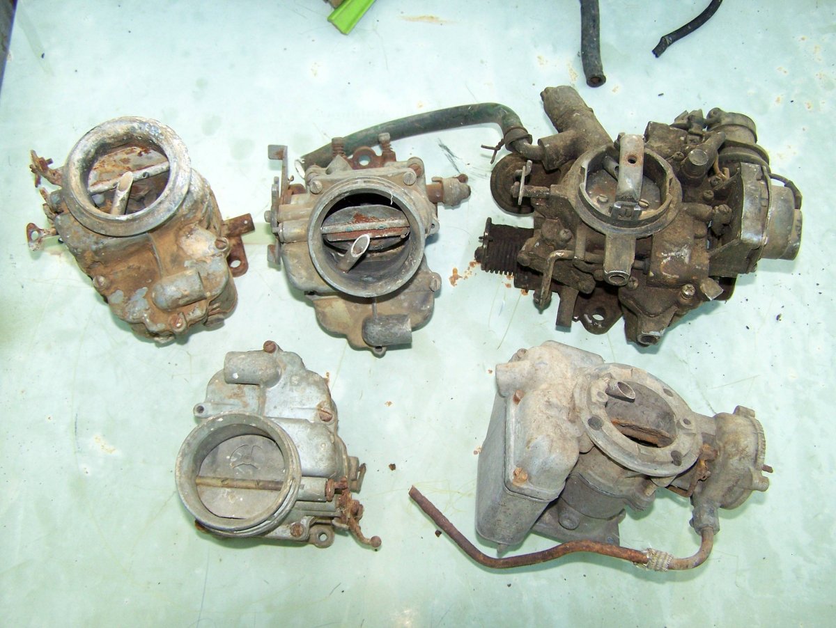

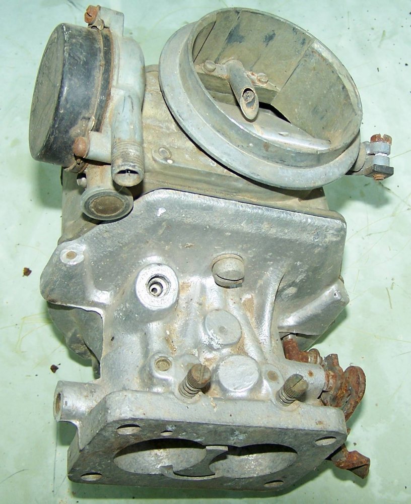

One Barrels
34777
And an oddball lookin one<two barrel
They probly all came off of Fords because the guy who's sheds I was cleaning out for his wife was a lifelong Ford mechanic at the local dealership

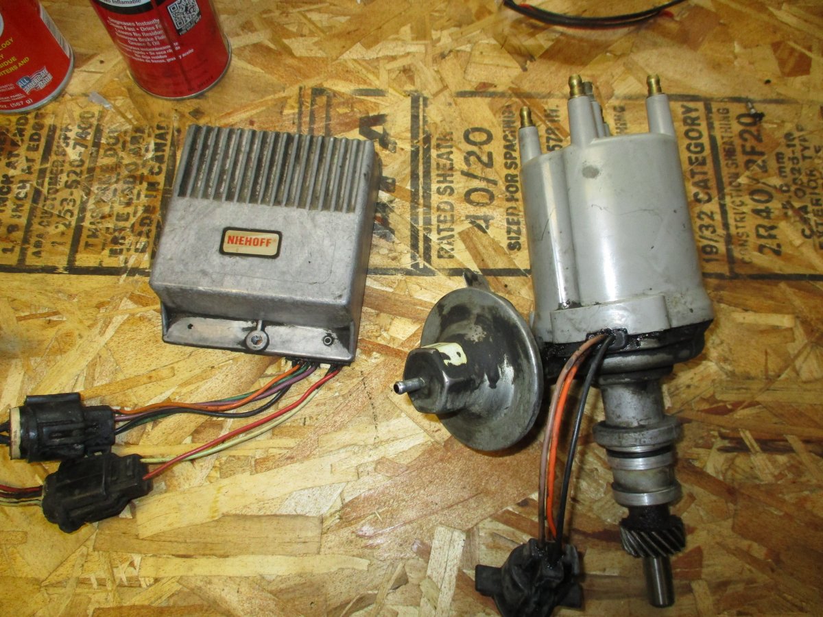

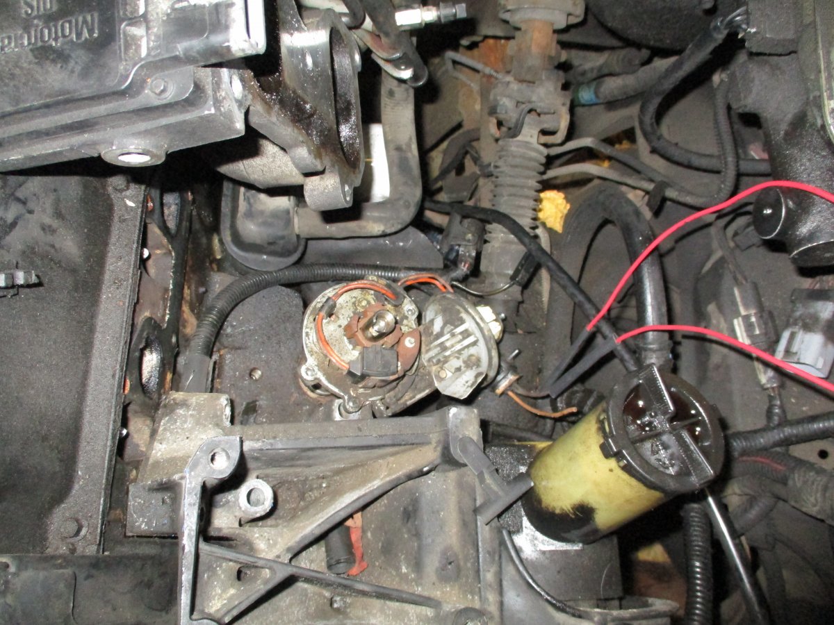

It is *possible* to carb a 2.9, tom morana makes an intake, but im not sure what you would do about the TFI stuff because 2.8 parts dont exactly bolt on a 2.9.
HEI conversion. Like 40-50 bucks iirc
PJ is right, HEI. I stumbled across some VW/Solex 1bbls at the junkyard and had another crazy idea. Remove the upper EFI log style manifold on that 2.9 and fab some adapter plates and/or spacers for the lower intake runners. 3 groups of 2 runners each sticking straight up just asking for triple 1bbl carbs... Wouldn't take too much work (not as much work as getting other dual carb setups to work that is.. *cough* EDELBROCK) to get all 3 in sync. Most guys used to run dual 1bbl carbs on those air cooled VWs and they are purportedly easy to match.

Building on my last post: I went out and got a kit for this carb. I checked for play around the shaft and found so little that its negligible so I decided to rebuild this one. Now it runs, but only around 1500RPM or so, and still sounds like a big leak, even with all new gaskets & a freshly re-cleaned carb.
Reaching behind the carb, I was able to find a leak in between the spacers. I removed one spacer and it cut the leak down considerably but I still can't get the thing to seal.
Timing: 6* BTDC
Jets: 49F
Venturi: 1.08
I am stumped. My O2 gauge reads rich, about 11.5-12.5 on startup, then I watch it lean out as vac drops (expected effects of a vac leak) then it stumbles out. Next thing I'll try is hitting the gaskets with RTV.
It also once again smokes considerably. No oil in the coolant & haven't dumped the oil yet so I can't be sure of head gasket or valve seals yet.
I found the leak! She runs! :icon_bounceblue:
This was totally my doing too. I put the air horn for a 2150A on a 2150 because it was handy on the bench. The air horn gasket on the 2150 provides a vacuum seal on a passage at the rear left corner of the carb. The 2150A does not have that passage or it is relocated to the rear center where the altitude aneroid/solenoid goes. My cockeyed homebrew spacers and gaskets had nothing to do with it.
With the timing and mixture dialed in, she runs nice and smooth. Just a little tick at mid throttle that I'll work out soon enough, likely jetted too big. Haven't driven it far though because it soots up the block.

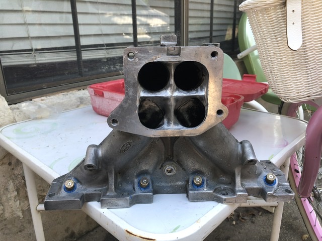

85 ranger 2.3, kept the lower intake and adapted to a motor craft 2100. I did some calculations on what the appropriate cfm for a carb on that motor and it was something to the tube of 190cfm. Found a chart on 2100 Venturi sizes and the .98 was the right one. It’s somewhat of a unicorn but you can find them. Mine came off an early 60s falcon I think. Whatever it was it had a tiny v8. Distributor came off a early 70s mustang with duraspark and vacuum advance. I went with Chevy hei for the ignition. After I got the timing ballparked I got it cranked up yesterday. I also have a roller head off a 94. Are you saying I can just switch the guts from it into the 85 head? Seems too good to be true. Here’s some photos of mine. Still needs a ton of work. It’s going in a 49 Willys cj3.

I’m doing the same thing you are.

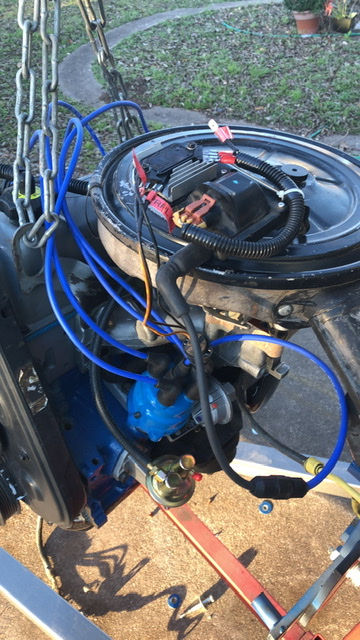

Looks really good so far! Your D-port head/intake combo should flow much better than the oval port & Scheffield intake I'm running currently. I nearly went HEI but I wanted to keep as much Ford as possible. HEI conversions are really good setups however and it'll treat you well.
I have that same intake on the shelf in my shop. Someday I'll build a big power D-port head with a high lift roller cam. What venturi size is your 2100? As far as I know you'll be fine with a 1.08.
As for the cam conversion - yes, everything swapped over from my '94 head to my oval port head. If you have a California '95 or 50-state '96 you're out of luck, the '94 is the last head to use the same size cam. I kept the old springs, I really don't like the sheaths on the '94 springs. While you're in there, don't do what I did and neglect the seals! I ended up pulling my head again and lapped the valves too while I had the chance. Real easy trick, use a hose & drill bit instead of the junk lappers from the parts store.

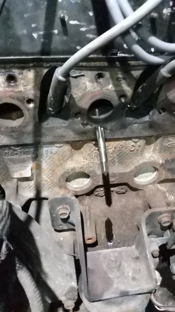

On another topic, found the ticking. Reason #1 I ended up pulling the head is it was making this chuff-chuff-chuff sound from one cylinder. Sounded like a burnt valve but smelled like a pretty bad exhaust leak and it was messing with my o2 gauge. I didn't notice this until the head was already back on...
There were holes drilled up at approximately 45 degrees into each of the 4 exhaust ports. Probably some sort of emissions thing. Three of the four ports had JB Weld packed in by the PO of the head, while the 4th had burned out its JB weld while I was driving. If your head has these and you want to run the shorty header, use a 5/16 drill bit to clear the holes out & tap them with 3/8 standard. All thread from Home Depot patches it, just grind it down with a peanut wheel and that's it. The manifold will hold them in place.
