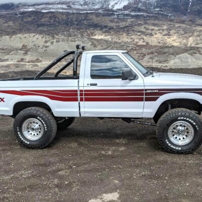

BlackBII completely rebuilt this Ranger and performed all of the work himself. The result is a truck that combines carefully selected upgrades with the look and character of a period-correct Ford Ranger.
One of the most interesting features is the custom steering system. Superlift discontinued its Superrunner steering system years ago, so BlackBII developed his own improved version. The setup uses dual pitman arms and custom “GM 1-ton” K-Link steering to provide a unique solution for the truck’s modified suspension.
The attention to detail throughout the build is equally impressive. BlackBII gave the Ranger a period-correct appearance with a NOS Rally Bar, lights, and a NOS STX stripe package. Combined with the fresh Oxford White paint, the finished truck looks like something that could have rolled off a Ford dealer’s lot this way.
Our forum members liked it so much that they voted it the January 2024 Truck of The Month. It later went on to tie for the 2024 Truck of The Year.

BlackBII’s custom steering system uses dual pitman arms and a custom K-Link steering arrangement.
