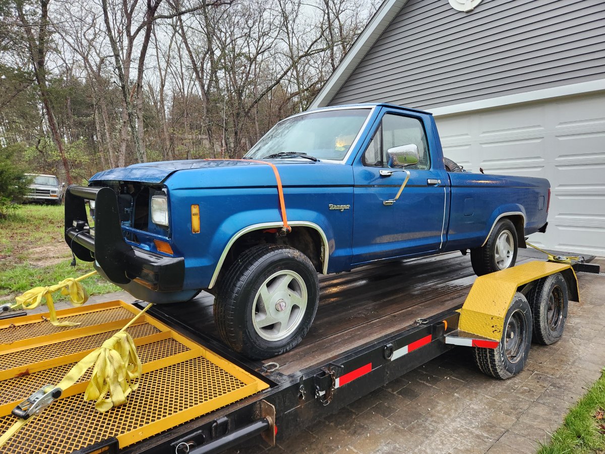

I had another 83 a few years ago. I really loved that truck, but sadly severe frame rust did it in. Ever since, I've been keeping a loose eye out for another. A little over a month ago, facebook stuck this very blue little 83 in my marketplace feed for a hard to pass up price. The previous owner had bought it as his first truck and pulled the original motor after it lost compression in one of the cylinders. He bought another 2.3 out of a mustang, but lost interest before installing. Unfortunately for me, he left the "good" motor open to the elements and it was full of water when I pulled it out of the bed and put it on my engine stand. It was locked up tight. I found another motor via the wanted section here, and made the long trip from Missouri to Michigan to pick it up. I brought my brother and niece along for the ride. We drove the 4 hours from my brother's place to our hotel with my doors off, and the next morning we got to see one of the Great Lakes in person for the first time. Picking up the motor was a great experience. The PO and his brother were great to talk to and very helpful. They were very happy to have part of his truck being saved from the scrapper, and I was very happy to be able to help keep a piece of it on the road.

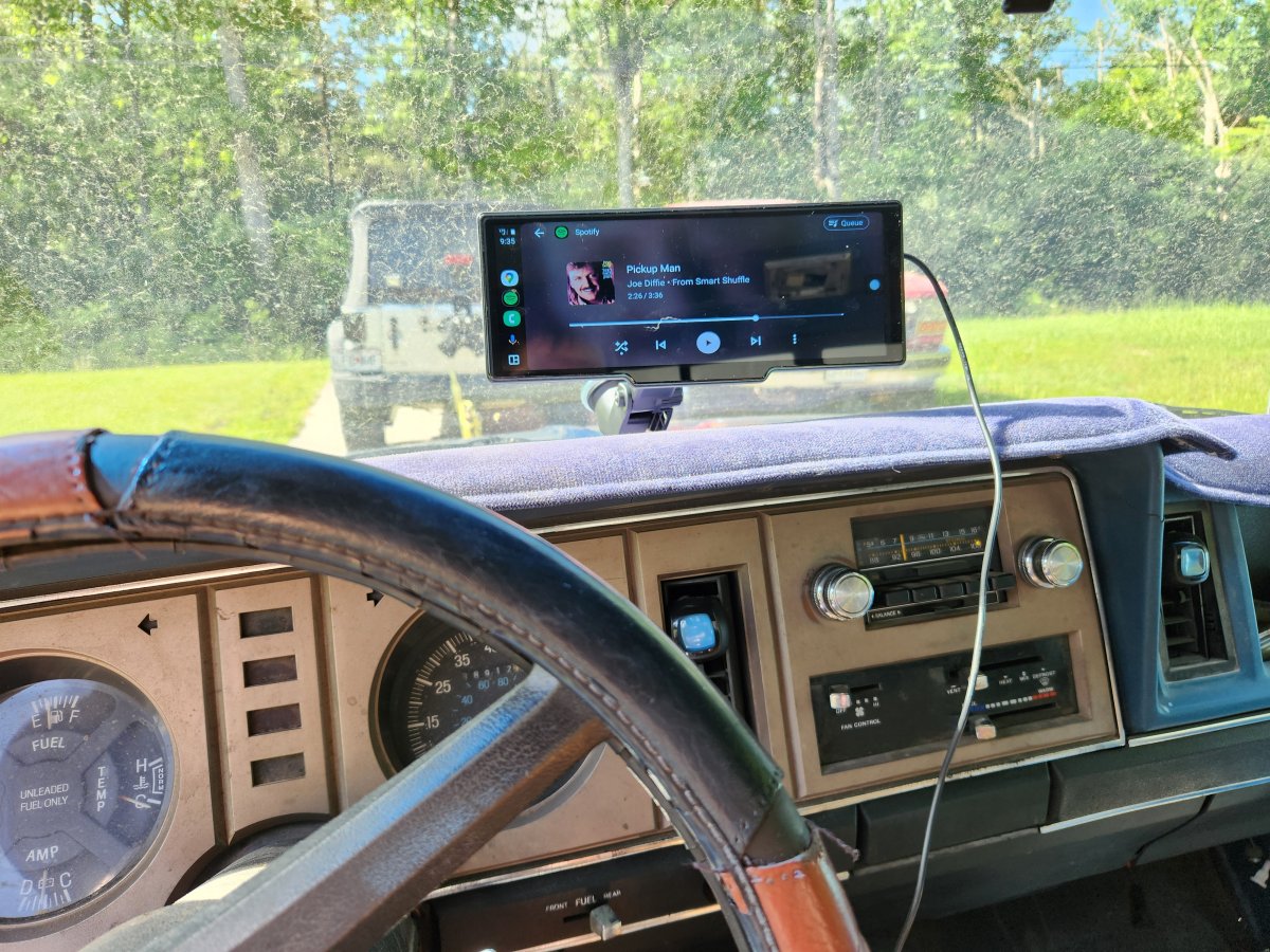

Thanks :) I don't plan to cut up the dash. This is how I'm upgrading my tunes:
Cool!
For some reason . . . that gives me the urge to go see a drive-in movie.
Reminds me, that I used to have a pretty good collection of the old cast zinc drive-in speaker boxes; which I used to forget about until I was driving away . . .

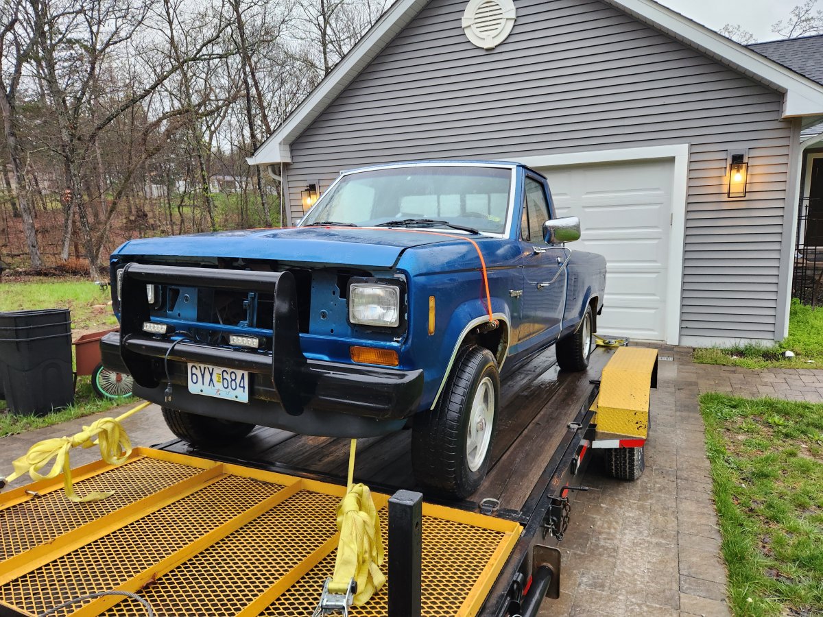

Instead of doing anything that gets it closer to running and driving, I spent my evening getting this:
Ray's 83 Build Thread
Bought it from a really nice kid with a 2000 4.0 that has some nasty sounding electrical gremlins. He was selling the bar to fund repairs. I hope he gets it going.
I wasn't sure if it would fit my 83 without modification, but it went right in. Ford really didn't change much with these trucks. Even looks like my truck had one before, which explains the rust on the wheel wells.

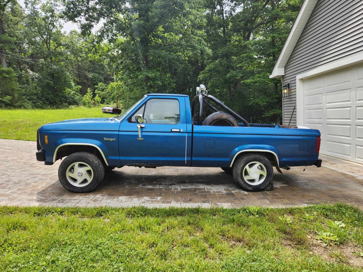

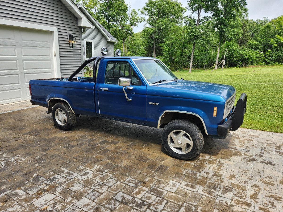

I bought some Blazer International 100W off road lights to finish off the look and they arrived this morning. Gotta love that one day shipping. Not bad for 23 bucks a piece. They're really just for looks anyway. I might paint them eventually, I hear they like to rust. I also picked up some "inspired by KC" smiley face hard covers for them off eBay. I figured knock off KC covers for my knock off KC lights was fitting.
I drug the truck out into the light to see how it looks. I'm pretty happy with it. The camera makes the lights look small from the front, but it's just the fisheye effect. They look better in person.
