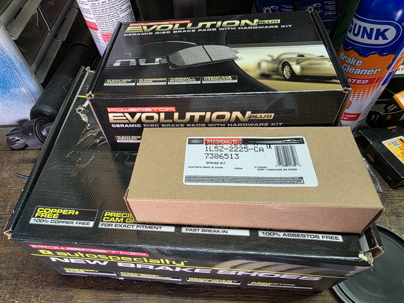

New rotors with new Timken bearings, races, wheel seals and even Timken grease. Having surgery tomorrow and waiting to prep, so took advantage of staying busy since I can't eat.....thats all for now. Next Saturday hopefully I can get it all installed. Bonus pic of shoes, pads, spring kit, etc.
