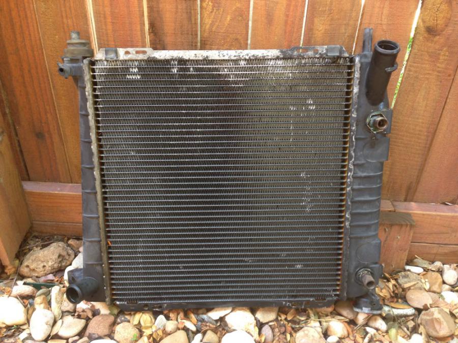

UPDATE:
Rain cats and dogs last night, was planning on going back to pick-n-pull to pick the one complete 2.8 tbi i found within 20+ vehicles, i believe it had the complete wire harness but the ecm was for an auto. need a damn manual ecm :annoyed: anyways i really don't feel like becoming a pig in mud just to get the parts, so i will continue my pick somewhere between tue-friday.
some pics of currently pulled parts. Mark_88 i will definitively do that first.

rained again making the picknpull muddier :sad:
most of the parts will be in tomorrow, but the build will have to be put off a week due to finals coming up. having the radiator pressure tested with my dad Friday. ill keep yall informed :)

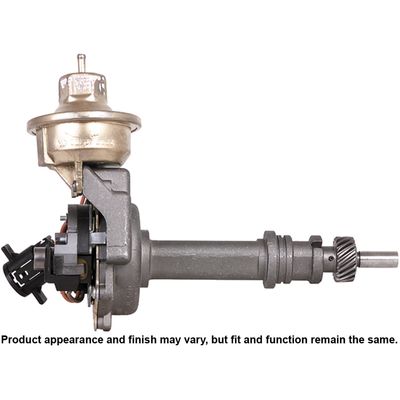

walked out side earlier today and saw a whole bunch of packages on my doorstep:yahoo:
all the parts except the carb/manifold gasket have came in,
started ripping open the boxes to realize the fuel pump came with a filter, and JEGS sent me the wrong damn size fuel hose :annoyed:
called them up, im waiting for them to call me back, sending the fuel hose and the extra fuel filter back. will be going to pick in pull tomorrow hopefully to get the tbi, wiring harness and ecm. i hope 10psi is enough to run the tbi, ive read from some che*y forums that is need like 50-70psi and ive read it only need 7psi, idk trial and error i guess

don't do a 10psi pump, that won't be high enough (gm tbi needs more than 11, that pump will always be maxed out, and will fail), on the 3 total i have done i used the inline, high-pressure pump from the EFI bronco II, it can do way more than is needed, and the regulator just sends the excess pressure back to the tank. new they are $80.00, from a J/Y like $20.00
they already have nipples to clamp hose on and everything. they work great
