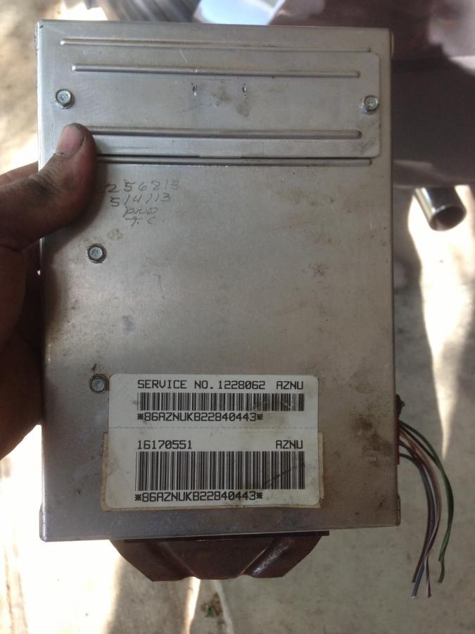

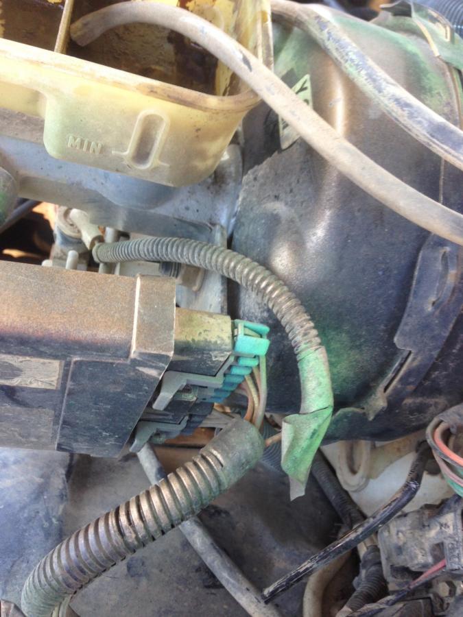

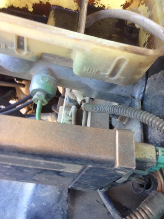

added some pics to previous post also have no clue what this module controls didn't know if i need and couldn't figure out how to remove it, was getting tired by that time. spent 4 hours in the sun:annoyed: also forgot the module under the distrubtor:annoyed:
aghh this is a pita

Youre good you don't need that.
It looks like you still need the throttle body, dist. Module, and coil. It's also nice to use the chevy air cleaner housing.

that module that rico said you don't need btw, is the abs module. and no, you don't need it
but you do need the "EST" module. it is a flat square with a connector plugging into it, i don't see that in your mess of wires

the module that is bolted to firewall above the distributor, i got that little box its in there,
