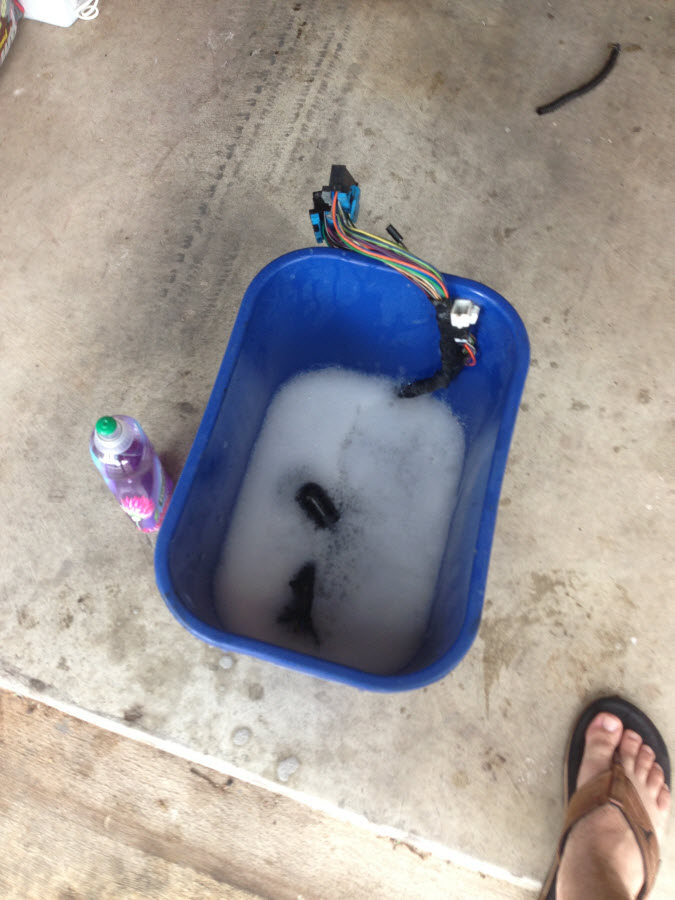

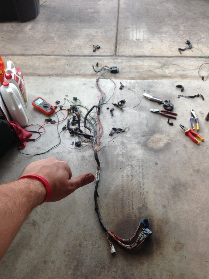

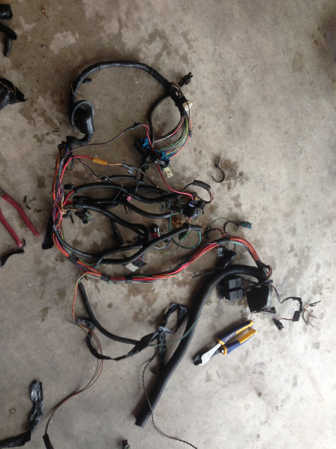

Update:
still searching for a damn tbi
started pulling apart the wiring harness and removing the junk, hope i didnt need the AC signal and control since mine already works
