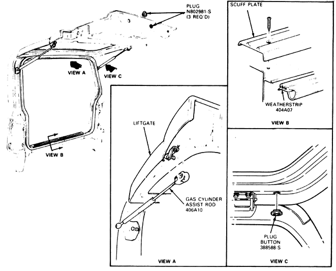

- Support the door in the open position and disconnect the liftgate gas cylinder

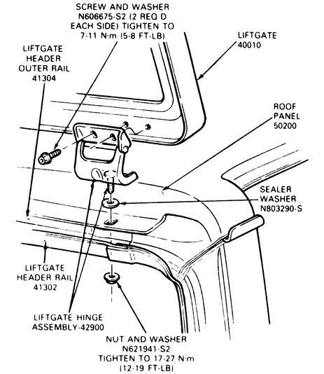

assist rod assemblies. - Carefully move the headliner out of position and remove the
hinge-to-header panel attaching nuts. - Remove the hinge-to-liftgate attaching bolts and remove the complete liftgate assembly.

The liftgate can be adjusted slightly in or out and side to side by loosening the hinge-to-header nut or bolt. Some up and down adjustment can be accomplished by loosening the hinge bolts on the liftgate and moving the gate up or down.
The liftgate should be adjusted for even and parallel fit with adjoining body panels before tightening all fasteners.
