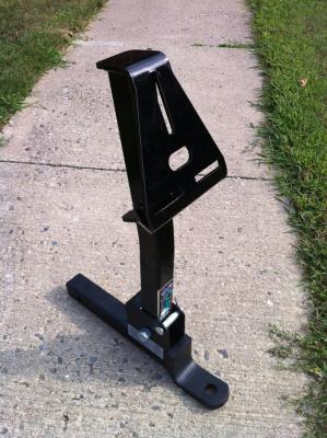

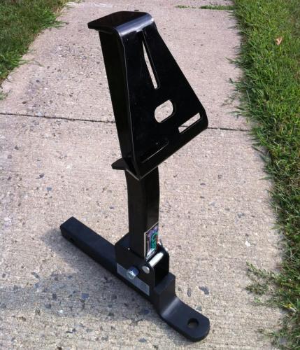

The folding receiver bar is shown below with a receiver mount hitch haul tire carrier attached to it.
Folding receiver bar - up
Folding receiver bar - down

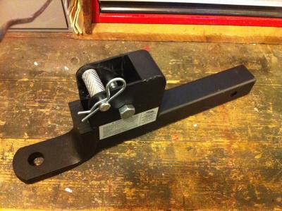

You’re going to modify the tire carrier by cutting the receiver bar off if it.
Cut the receiver bar
Once you cut the receiver bar off, you’ll need to drill a 1/2-inch hole up 2-inches from the bottom.
Drill a 1/2-inch hole up 2-inches from the bottom
Once this is done, you can bolt the tire carrier into the folding receiver.

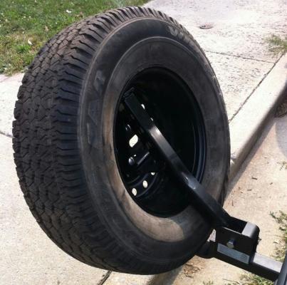

Once the receiver is mounted to the vehicle, you’ll need your (3) carriage bolts and hardware to bolt your spare tire on to the mount. You may want to cut off the section where a hitch ball mounts if your tire hits it and keeps your rear hatch from opening all the way.
Folding tire carrier with tire mounted - 1
Folding tire carrier with tire mounted - 2
