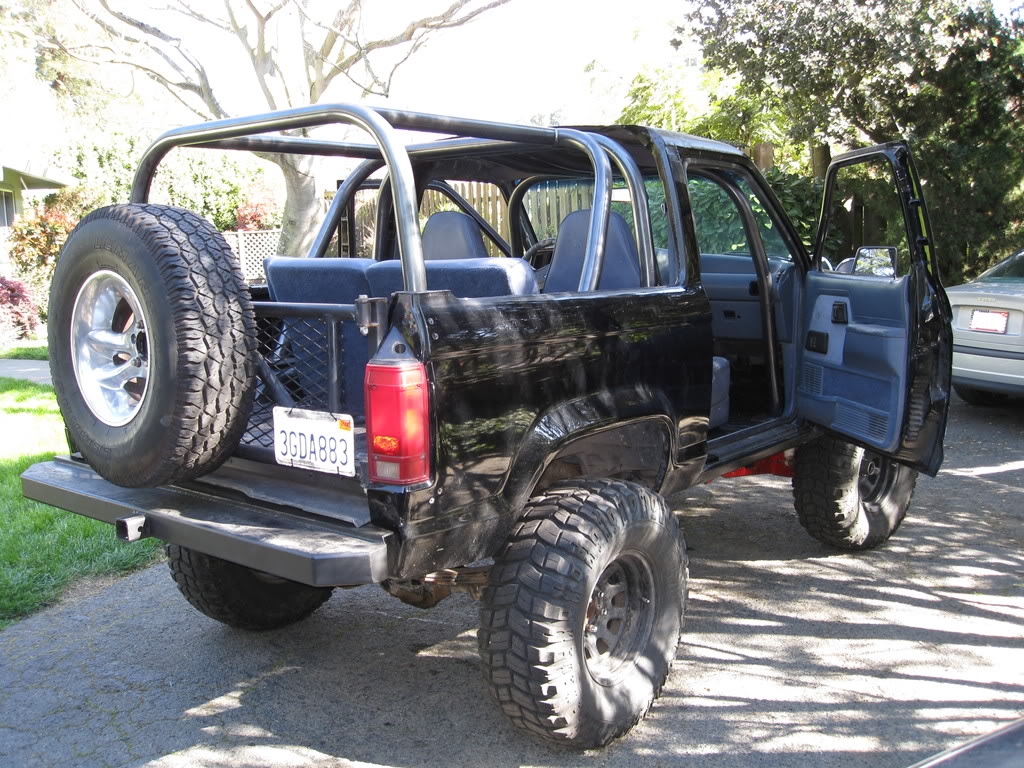

(Photo of smash9002’s 1989 Bronco II)

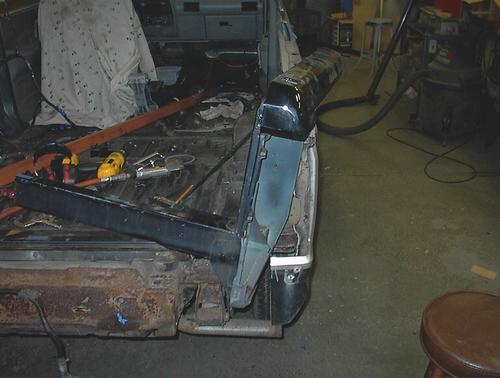

Most people who chop the top leave the back open. If you would like a nice clean factory look, go to a salvage yard and get a used early Ranger bed. Remember that the Bronco II and the 1983-1992 Ranger had the same body lines. In the photo below, you’ll see where someone has cut out the top of the bed rail and retained the rear corner for the taillight from a Ranger bed. This section will be welded in to replace the same area that will be cut out of the Bronco II for a nice clean factory look.
Ford Bronco II choptop rails
