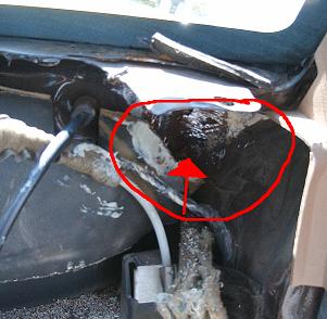

5: Area behind top of rear hatch. Once again, seam sealer is the problem, but this time there is a bunch of it. symptoms are wet rear headliner and wet cargo carpet. There really isn’t a good temp fix for this because there is so much seam sealer that you’ll spend more time smearing silicone over it than it would take to break all of the seam sealer out and replace it.

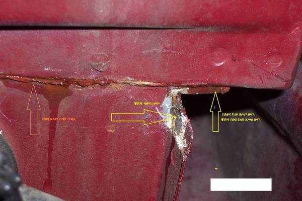

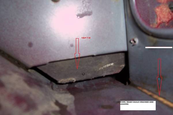

After searching for the source of the water, I found the cowl to be the problem. The caulking where the floorboard and the cowl seam is dried and cracked.
I slipped my camera into an access hole behind the clutch reservoir, so this picture was taken from the inside. It also shows the rubber flap that covers the drain hole and the caulking where it leaks. Here’s an older picture of the bronco.
rubber flap covering drain hole
The cowl also has about an 1-1/2″ down grade from the passenger side to the driver’s side. And there is no drain on the passenger side. Here’s 180* from the 1st picture
view inside cowl

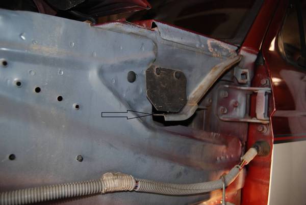

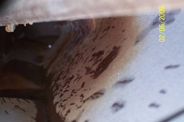

I took the driver’s side fender off to see the outside of the drain hole. when I ran water in the cowl, I could see the water following the sheet metal back under the hood.

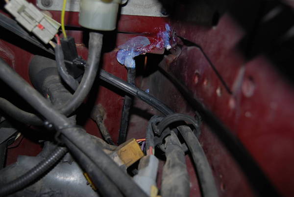

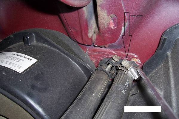

It would follow the edge back to where the firewall meets the side kick panel and gets inside there too. Here you can see where the water can run down the seam at the kick panel. And also, the leak between the cowl and firewall.

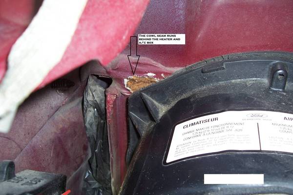

The cowl to firewall seam also goes behind the A/C, heat and fan Plenum’s and can leak into the passenger side floor. When I parked the Bronco II, it was leaning so that the passenger side was lower. Causing the water not to drain out properly, and leak here.

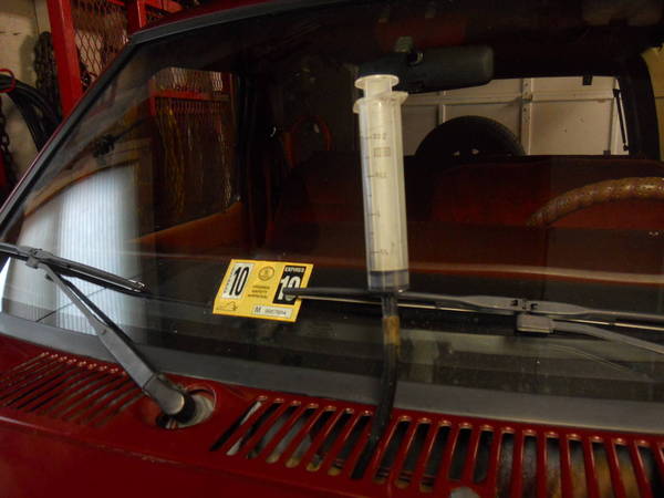

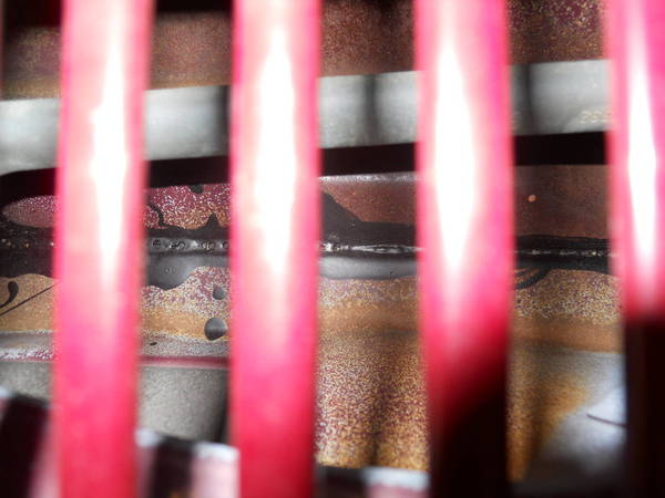

I stopped the water getting through the cowl to firewall seam by injecting rubber sealant that I thinned out, by putting a rubber hose on a big syringe. Through the antenna hole and the grate.
View of rubber sealant

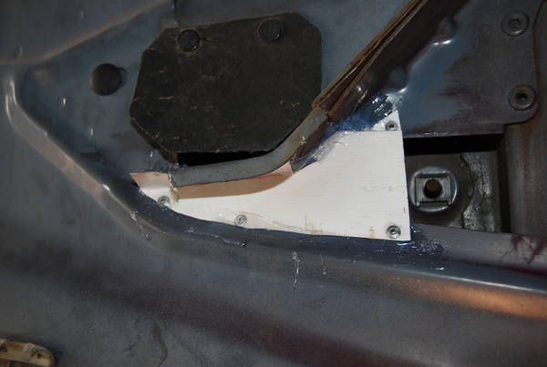

I stopped the water getting into the kick panel to firewall seam by blocking off the area below the drain hole (behind the fender) with a piece of aluminum and adding silicone to the seam in the engine compartment.
Area blocked below drain hole
