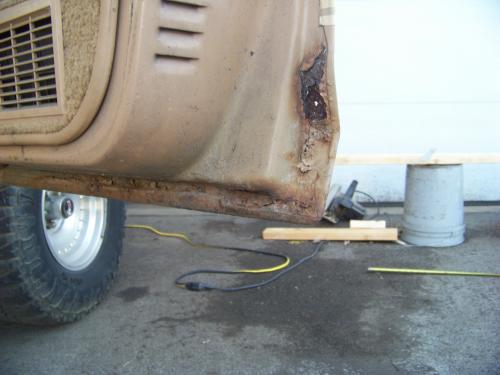

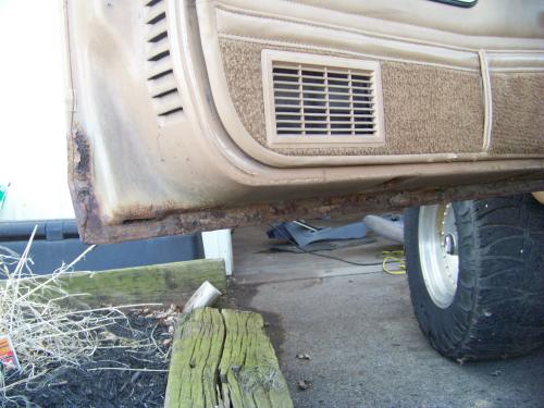

The lower section of both doors on the Bronco II project had more rust than I cared to fix, so I went to some salvage yards to search for replacements.
Lower section of door had more rust than I wanted to fix
Here's a look at the rust on the drivers door

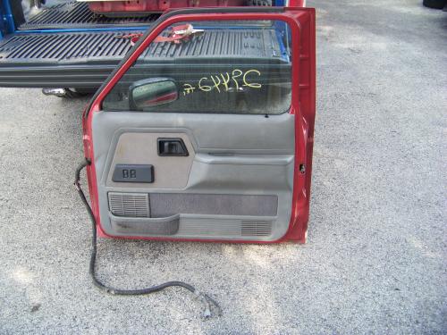

I managed to find a pair of matching doors off of a 1989 Ford Ranger that came with power windows and locks. The doors are held on with 13mm bolts. The hardest part about removing them is the wiring harness. T

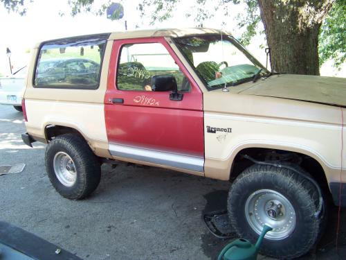

Here is the 1989 Ford Ranger door.
Bronco II Door Swap / Upgrade - Passenger door from a Ford Ranger with power windows and locks
Here is the Ford Ranger door mounted on the Ford Bronco II.
Bronco II Door Swap / Upgrade - Ford Ranger passenger door mounted on the Bronco II

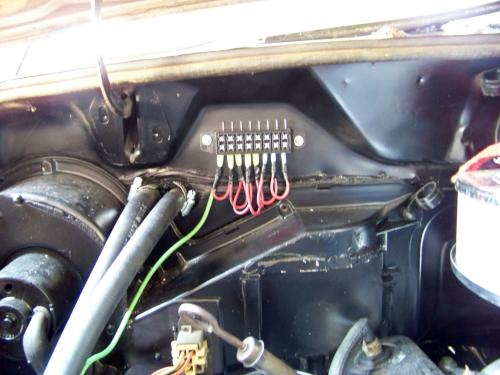

I will not be wiring these into the existing fuse block. Instead, I have added a fuse block to the passenger side of the firewall. I will be wiring the doors and windows to that on separate circuits. You can see the fuse block below. The wires on the bottom feed power to each block. The connections on the top are where you attach the new circuit. The block comes with a clear plastic cover that snaps on to protect it.
Rather than tying into the factory fuse panel, I installed a dedicated fuse block on the passenger side firewall. This keeps the power window and lock circuits isolated, simplifies troubleshooting, and avoids overloading the original electrical system.
Bronco II Door Swap / Upgrade - Fuse block mounted to fire wall

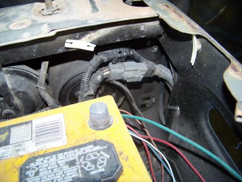

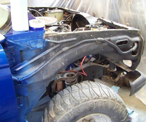

Below you can see the harness running along the inner fender on the Bronco II.
Harness for power windows and locks attached to inner fender
Here you can see where the harness comes in just behind the headlight and plugs in to another harness.
Harness entering engine compartment

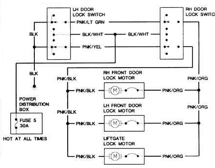

Power door lock diagram prior to 1989
(Power Door Lock Diagram Before 1989)
With the power door locks, all you really need to do is add power to the BLACK/WHITE Wire and ground the white wire.
Note that the door locks prior to 1989 DO NOT have a lock relay.
Ford Bronco II / Ranger Power Door Lock Diagram prior to 1989
(Power Door Lock Diagram Prior To 1989)

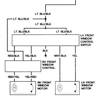

(Power Window Diagram)
With the power windows, you just need power going to the LT BLUE/BLACK Wire and ground the BLACK Wire.
