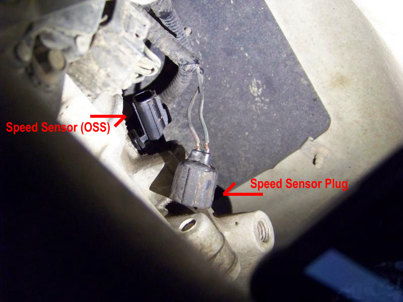

If you lay under the truck and look up towards the top rear of the transmission from the driver’s side, you’ll see the speed sensor (OSS). It’s shown in the photo below. The photo was taken with the plug removed to show the sensor and the plug.
As you can see, the wire insulation was removed at the plug. This could cause a short in the sensor circuit.  When this sensor was replaced, the wire was coated with a brush on liquid electrical tape to insulate the bare wires.
Ford Ranger speed sensor
The speed sensor is held in place by a single 10mm bolt and is a simple repair.

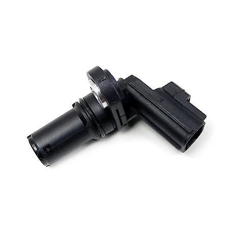

The speed sensors aren’t very expensive. Here are some part numbers with prices as of 04/2017:
ATP Output Speed Sensor Part No. FE-18
Power Torque Transmission Speed Sensor SC370
Ford Ranger Speed Sensor
