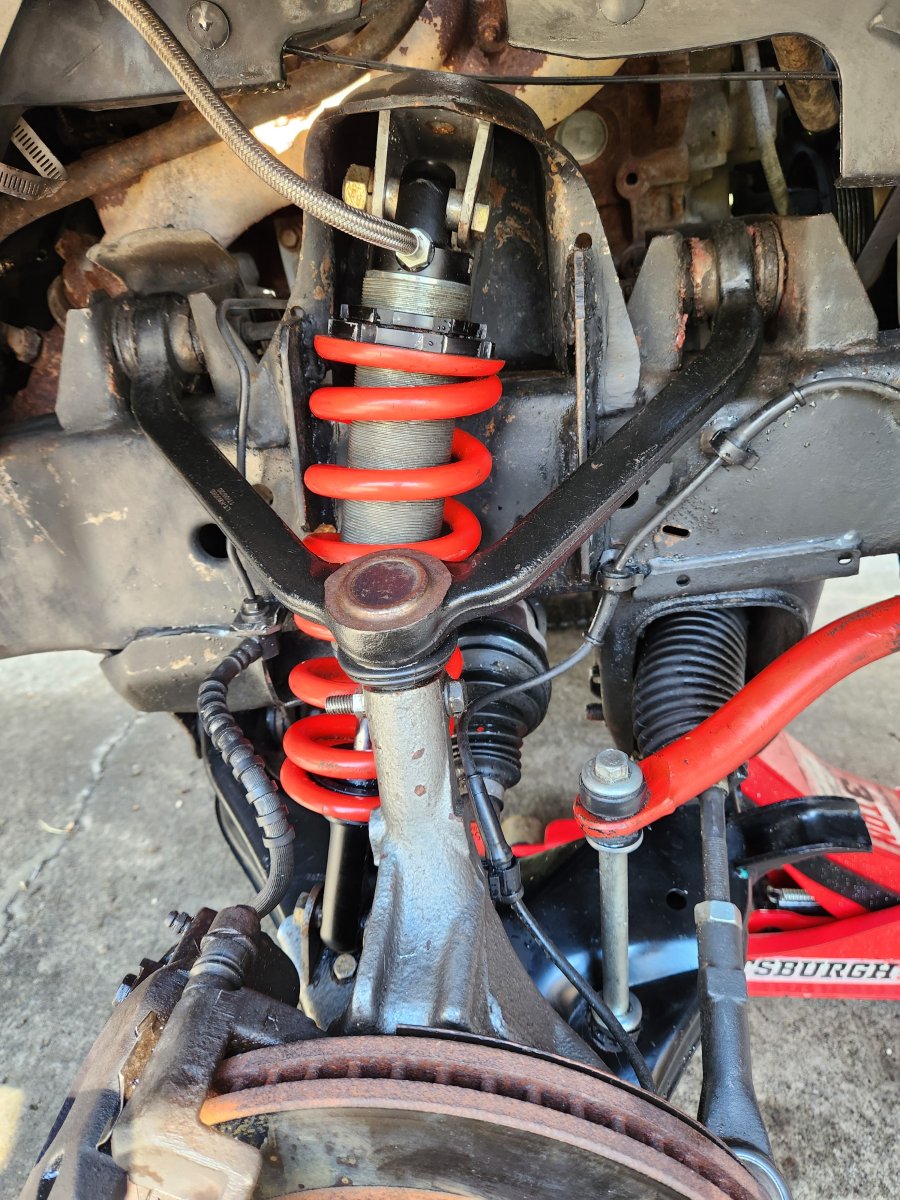

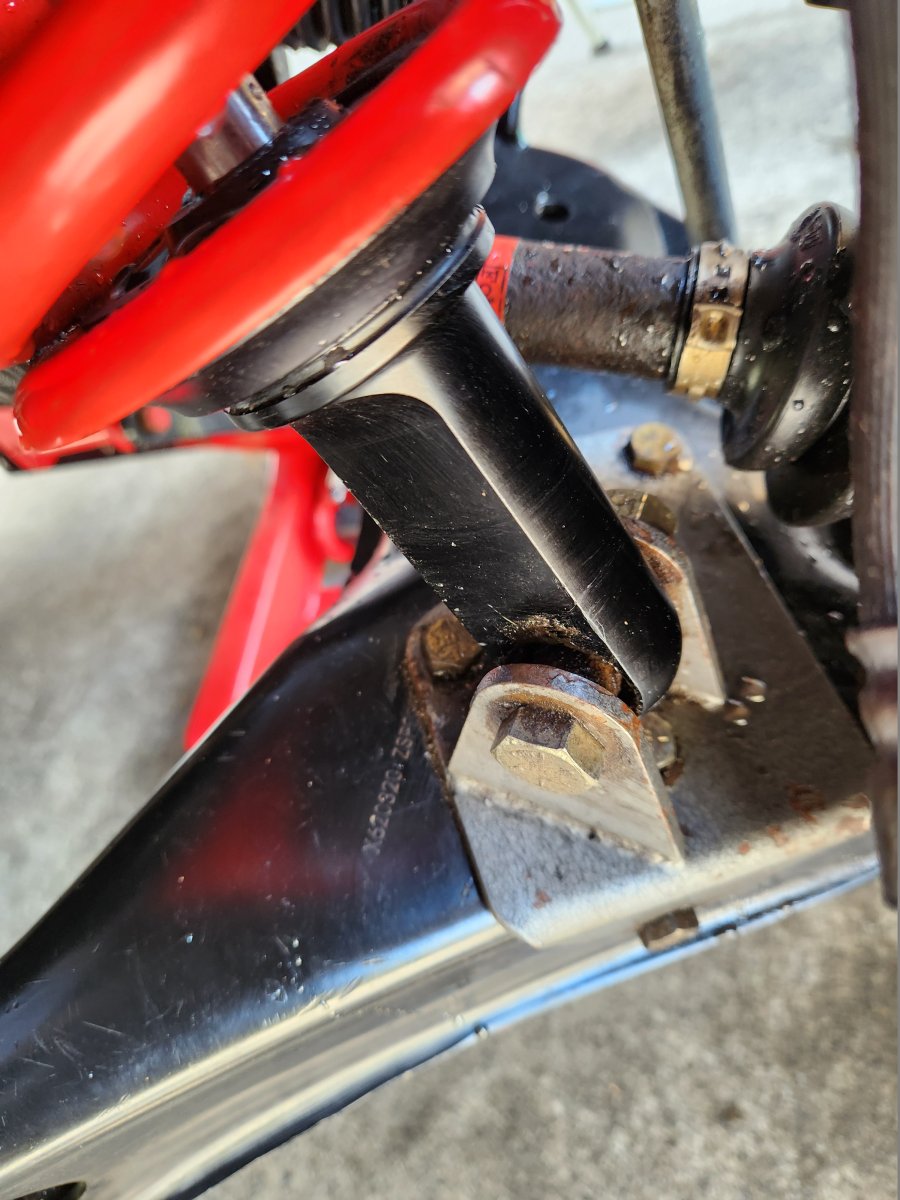

Hello from another Doug! I leveled the truck, & enjoy at least 3 inches of up travel, about 1 1/4 inches at the shock. Have a look at how I did it & let me know what Q's you have. I'd be glad to answer any, as everyone here will too! SWEET truck you have. Looks like Alaska.

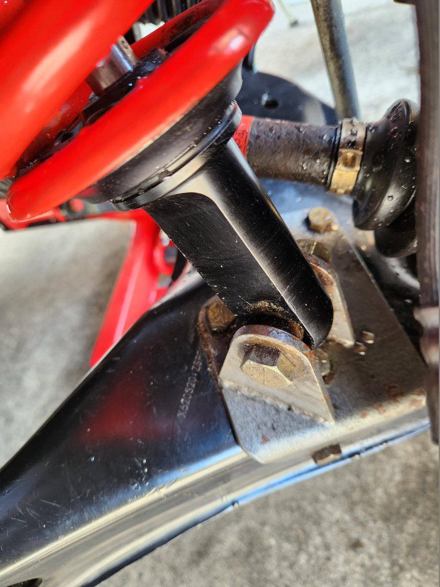

You will require the extended eyelets only if you have 4wd. You need these to get the lower shock & spring away from the axle. Even with the smallest diameter shock (2.0 inch shock combined with 2.5 inch spring), links below.........

Study the links I posted........the ride, night & day better. Not simply a bolt on mod, you'll need to add in some shock tower gussets as described in the link I posted.
Here is what shock I used, a Summit link, best price. New old stock (2 yr old) Now special order 28 days out.
FOX 2.0 shock body, coilover
Extended Length (in.):
19.35
Collapsed Length (in.):
12.85
The 800 lb Eibach spring link
Eibach PN# 1000-250-0800
Eyelet Extension, 3.75"
Fox PN# 213-01-238-A
Soft jaws for installing the eyelet extension
Soft Jaws
Adjustment wrench
wrench
Ahh okey perfect. I'll look into these links. Im not too worried about welding or doing some fab, got some experiace with building my patrol. Just looking for something simple for now for the ranger. Is it okey if I send you a message if some other questions arise?
  • What coilovers should i buy? and more info about the coilover conversion kits
Sure Doug, but if it can be instructional, it would be a good idea to have it here for others to read. Feel free to ask anything. While you're in there I would strongly sharing the experience for yourself by rebuilding the front end, CV axles included. Upper & lower ball joints, tie rod ends, & boots. That's all there is to it. Not much $$ there, but you'll be in there anyway. Take care. - MaicoDoug
Yep will do. ill be doing the conversion some time this summer so will be putting on fiberglass fenders and 37" tires. I'm wondering though about spring rate you have 800 pound springs most from what i've read recommends about 700-750 how do they feel the 800's ? do they feel stiff or are the 800's good ? I've also seen that the spring you are using is 10" long while the forum mentioned a 12" is that done to make it a 2" lift instead of the 4" with the 6.5" travel coilovers?
There is some math involved here.....a 10 inch spring is what Fox say is what that specific shock requires for a stock to 2 inch lift. Remember that this is with the stock track, that is the stock front axle width. I use this to pass other vehicles on tight trails. Mall crawlers normally dirty their drawers at the Starbucks. At 2" lift the CV angle is just about at max for on-road reliability and daily driving. Keeping this baby happy is not doing her too much wrong. She was born & bread as a Level II, so I have to respect her for what she is currently. In the future, when everything finally falls apart, it will be not from what I did to her.
The 800 lb spring rate; I can normally get full travel on back roads going the speed limit with the coilover adjustment at about 20-25% preload. The shock can't take a taller spring because the stack up height will limit the down travel. Currently I am enjoying about 5-6" of total travel. With about 2" - 3" of UP travel.
If you elect to go with a wider track, things start changing quickly. If I had to do it all over again, I would of gone with a Twin I Beam (TIB) front end. Kept the track width the same. NOTE: if you go wider, yes the spring rate should go down if the ratio of where the shock attaches to the lower A arm is further outside. Which will be less of a ratio. Remember the stock mounting point is halfway up to the hinge point. So with Apx. 3.5" of shock travel, the tire gets about twice that. Do the math. If you elect to go wider with longer A arms that mounting point will (may) change, and so does everything else. I don't know what the other forums are stating but what I'm doing is 100% stock, simply only a shock change with some shock tower gussets. As you can see I have no added front weight to speak of. I would try a 750 lb x 11" spring if I could find one, or go dual rate where the ring that separates the springs would take up the unused 1/2" on the shock body. Either way it's all in the math. Stack up height numbers are available at the Eibach website for any of their springs. You can take other's words to the trail, but what you can do for yourself with your own pad & pencil will decide. The best resource besides this website is Kartek & Fox Motorsports Tech desk. There was another desert racing forum called "too many trails, too many something, I forget.

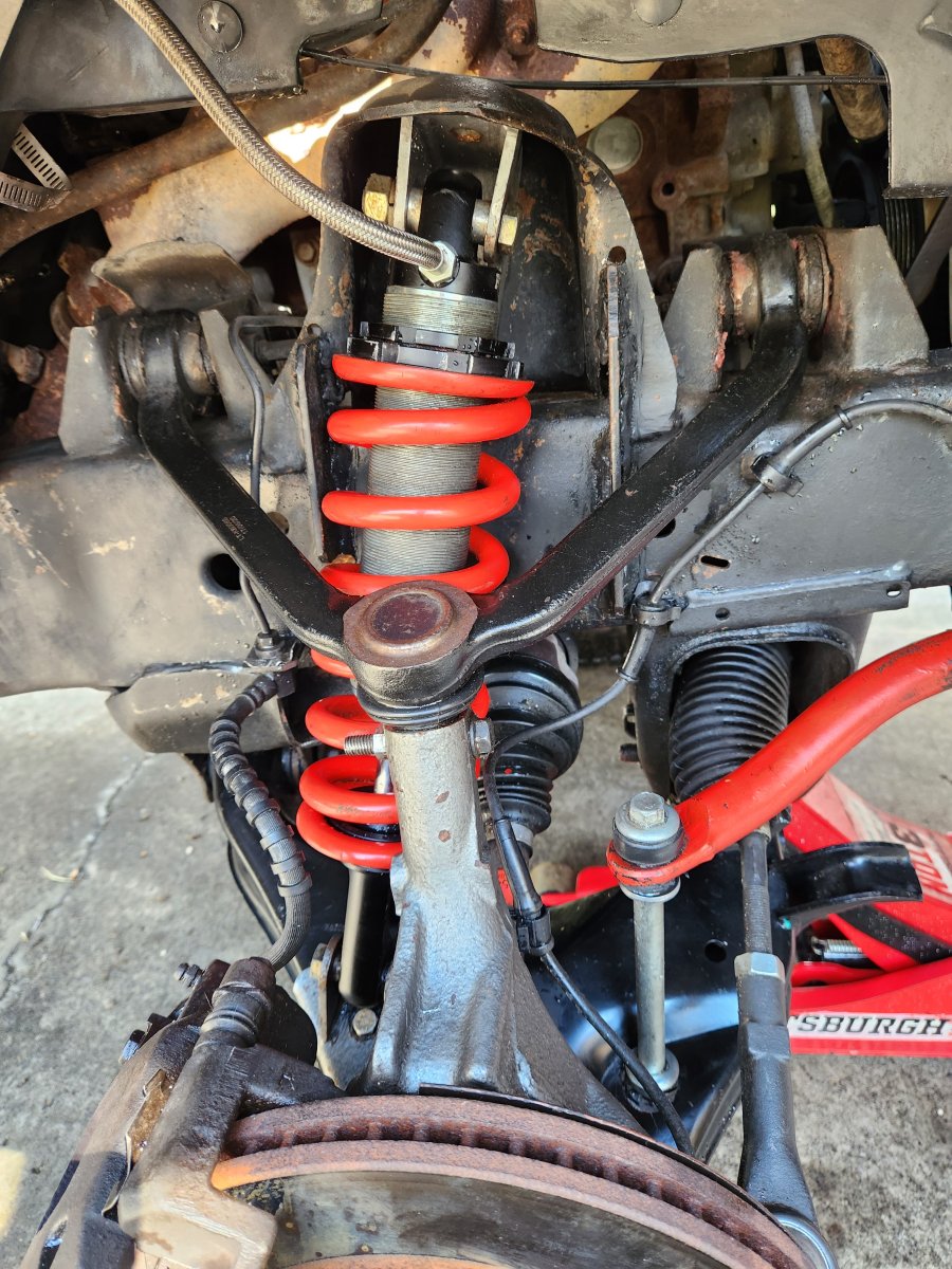

The 980-02-006 is the shock I recommend. It will level out the front. The ride is superb with not alot of spring preload, I would stick with the Eibach 800 pound/in spring. Relocate the brake hose mount an inch away as so you may build up the tower gussets. If I had to do this mod again, I may consider a shock hoop & longer shocks because things get very tight up in there. This is one of the best mods I've done as the ride is pretty nice considering the short A arm & related geometry. Remember, you don't want that A arm too deep (too far down). The shock pressure is NOT adjustable. The first 2 inches travel is nice & soft making the expected difference one can expect. Good luck & post your ongoing progress when you can. -Doug

Still trying to get this one together for myself. I think you said your setup was the one slightly over stock height, correct?
Comfortably just over 1/2" higher than the Ranger ever was at a "non-Cranked" front height. Half inch to 3/4" over stock height at maximum with a livable geometry & with non harsh ride.
