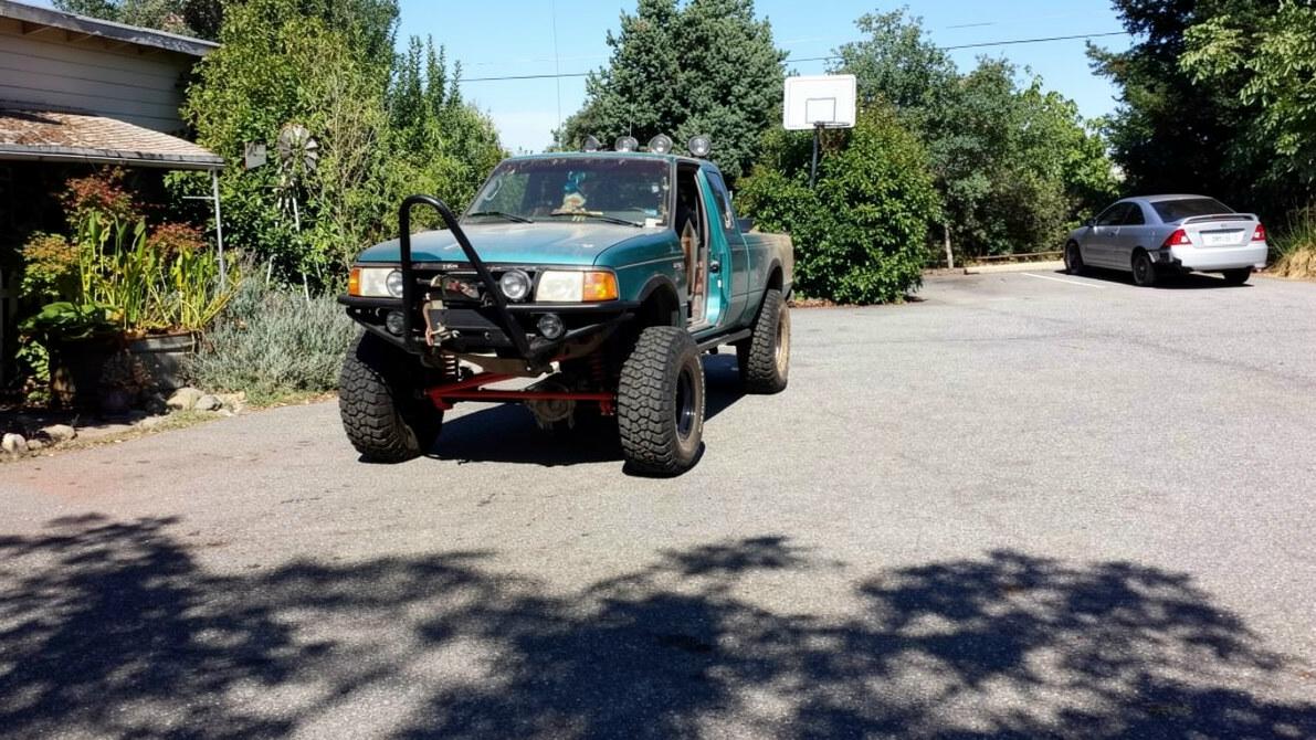

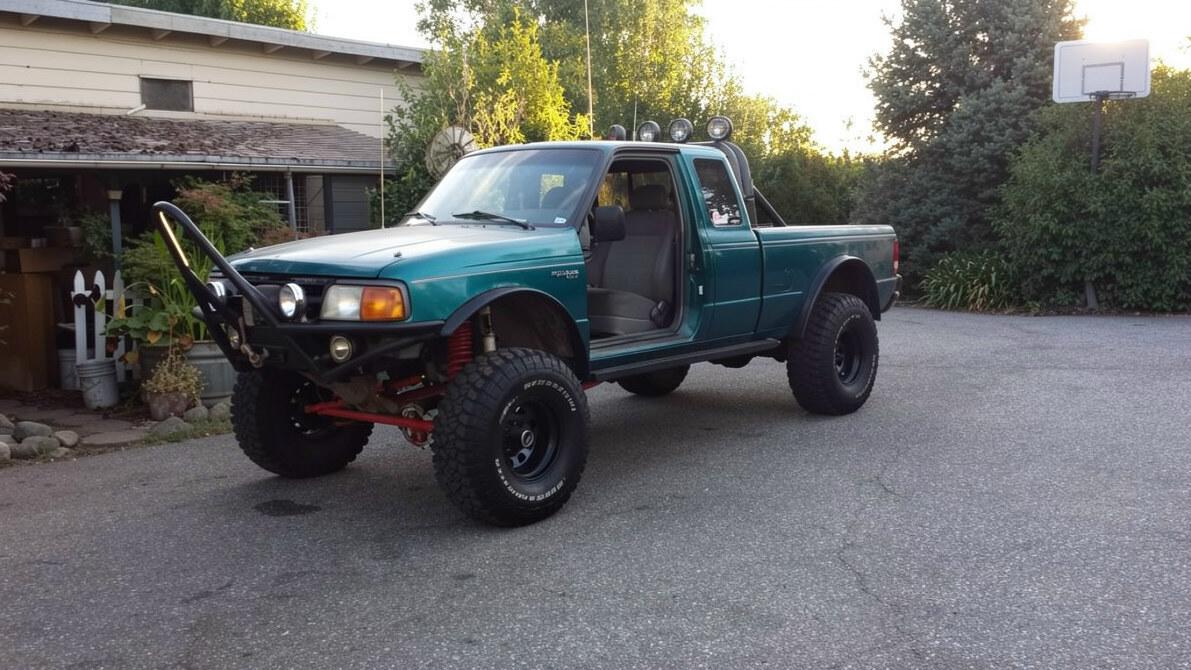

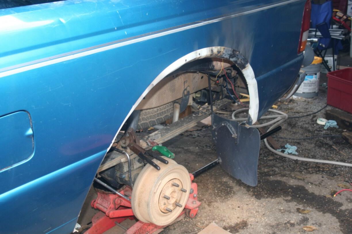

Take your truck from this:
Home Depot Fender Flares
To this!

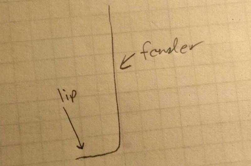

1) First, we will need to prepare your cut fenders for attaching the lawn edging. If your fenders do not already have a “lip” at the bottom then you will need to add one. This can be done simply by using your pliers (or sheet metal pliers) to gently fold over the bottom inch or so of fender. This should be done in small increments to avoid wrinkling the fender.
Fender Flare Diagram #1

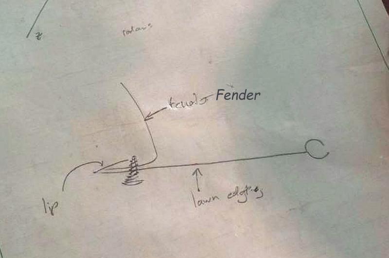

The general idea how the edging is attached to the fender is shown in this diagram:
Home Depot Fender Flare Diagram #2
As you can see, there is a lip on the bottom of the lawn edging (at least there was on all the different types I saw at Home Depot) and you will hook that on the lip of your fender all the way around.
You can then run a sheet metal screw through the lawn edging into the lip of the fender to hold them secure. Be careful not to over tighten the screws as it will deform the plastic flares and possibly pull a screw right through the plastic.

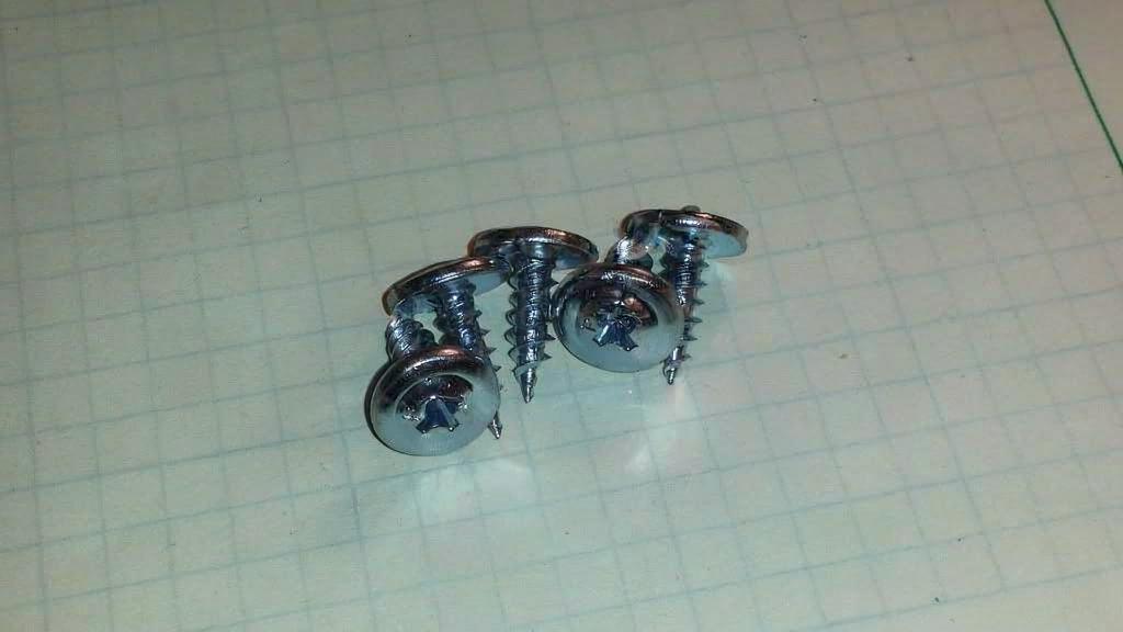

I chose to use screws like this for two reasons:
  1. Because the head was large so it wouldn’t slip through the plastic fender flares.
  2. Because the heads are rather flush so it wont chew up your tire if you happen to stuff one all the way into the fender.

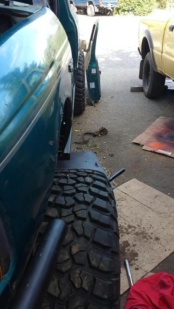

The tricky part is on most Rangers, the fenders are not straight up and down, as seen here:

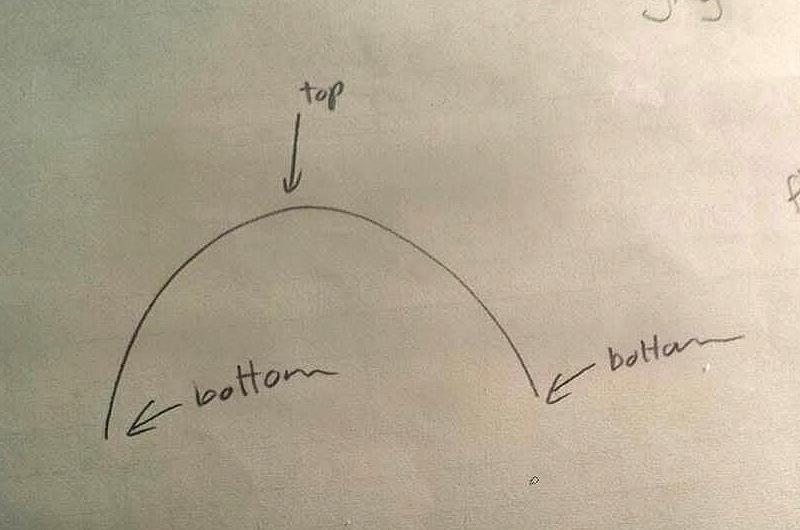

If you pull the edging out as far as you can so that the lip of the fender is right up against the lip of the lawn edging, it will cause the fender flare to take on a funny shape as seen here:
Front fender flare
It is rather flat in the front and the curve comes to a point at about 2 o’clock of the wheel well.

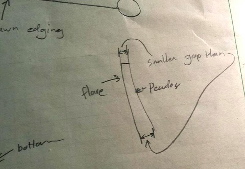

In order to counteract that, I pushed the fender flares in slightly at the top, and cut the lip off at the bottom of the fender, so that I could pull them out slightly (see diagrams).
Home Depot Fender Flare Diagram #3
Home Depot Fender Flare Diagram #4

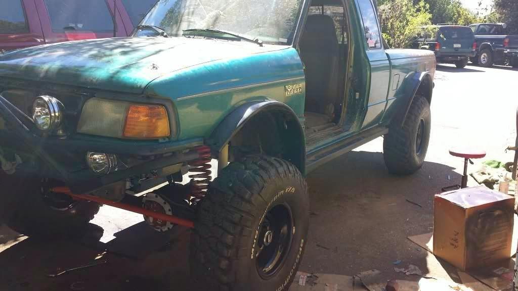

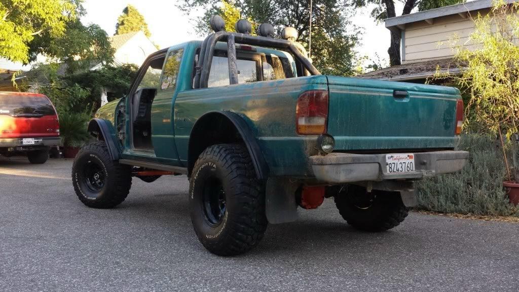

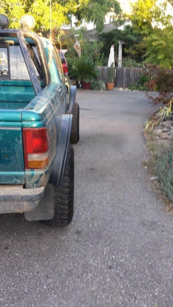

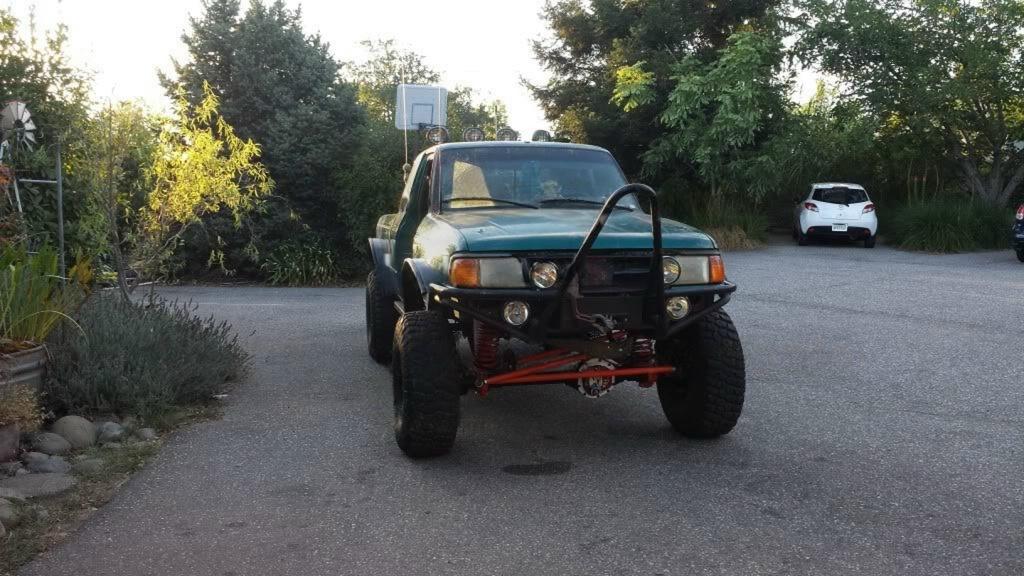

You can see the results of what I am talking about in these pictures.
Side view of installed fender flares
Finished results
Home Depot Fender Flares Installed

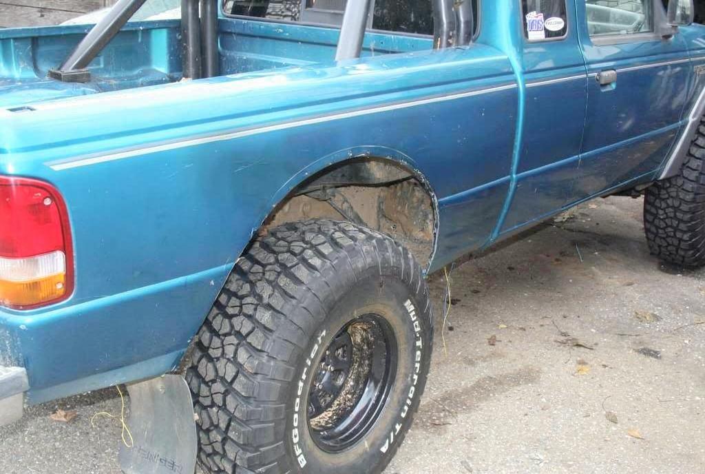

Something to note is that the rear fenders have an inner fender that comes out to meet the outer fender. When I cut my fenders I cut into the inner fender so I was able to slide the lip of the fender flare in between them. This however may not be the case with your application, and some modifications may be necessary.
