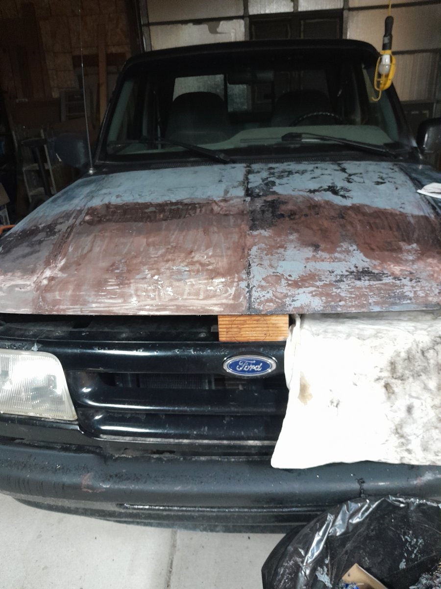

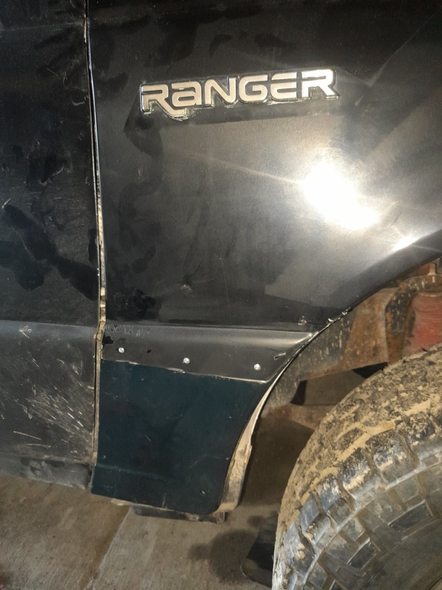

Been slowly working up to doing this re-paint. Being my first time I've been collecting equipment and things I need to complete the job. I have a ton of pics which I will start to post as I move through this project. It's black with a clear coat. The clear was pealing pretty bad on the hood and fenders were beginning to rust down at the base by the back of the wheel here's a couple of pics from the beginnings..
Finally getting round to some body work... Finally getting round to some body work...
Plan is to do the fenders and tailgate (picked up a new one) off the truck, do the the hood on (too heavy to move around easily). Remove the bed and do some repair work. while that is off, I'll paint the cab. Not sure about the bed yet. May be able to do some surface work to make it passable for now -- plus, I'm sure I'll run out of time before winter sets in.

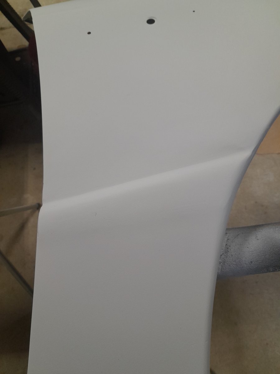

This has been a long process that I started way back in May, but slowly making progress. Prep work is very time consuming. The fenders received their final prime coat yesterday. Here ae some pics of the process:

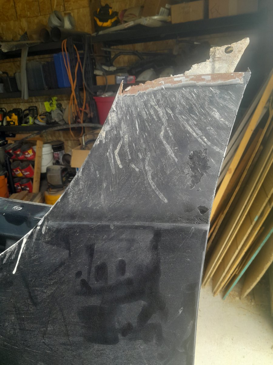

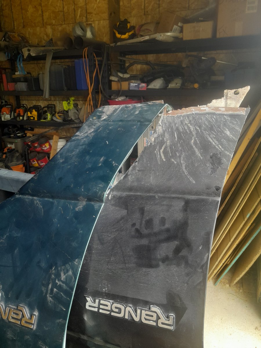

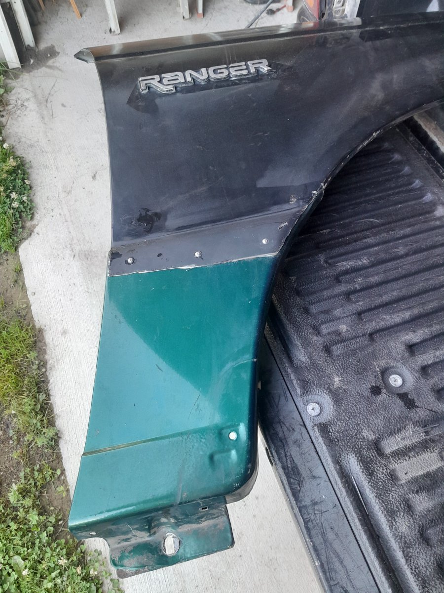

I replaced the driver side fender with a pull yard replacement last year. Earlier this year I picked up another pull yard fender they labelled as a 96. Turns out it was a 97. So I just cut off what I needed from the 97, matched it up with the 94...
Some subtle differences but it's ok for now.

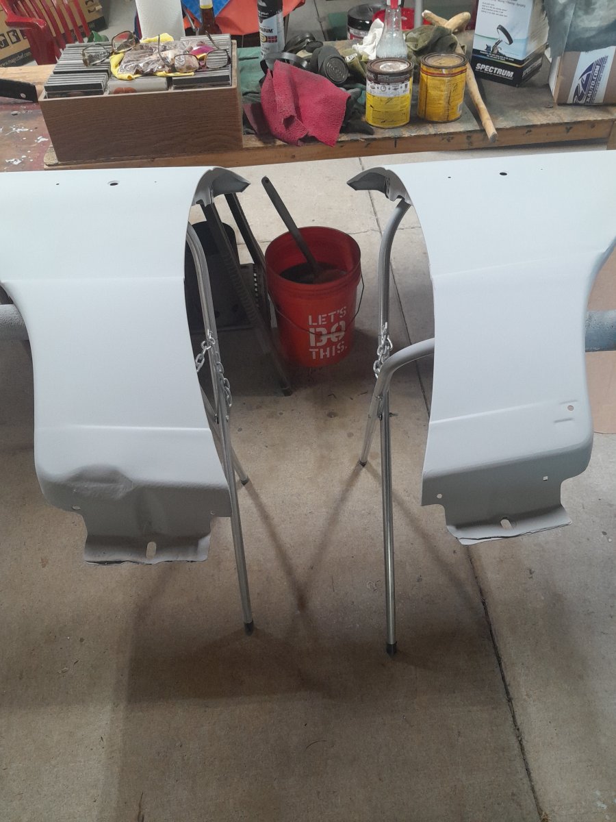

Both fenders with final prime.. The driver side has a dent at the base that I couldn't get to because of a bracket on the backside - I may try to fix this, but ..The 97 portion at the base also has a couple of differences. .
Hood's up next.

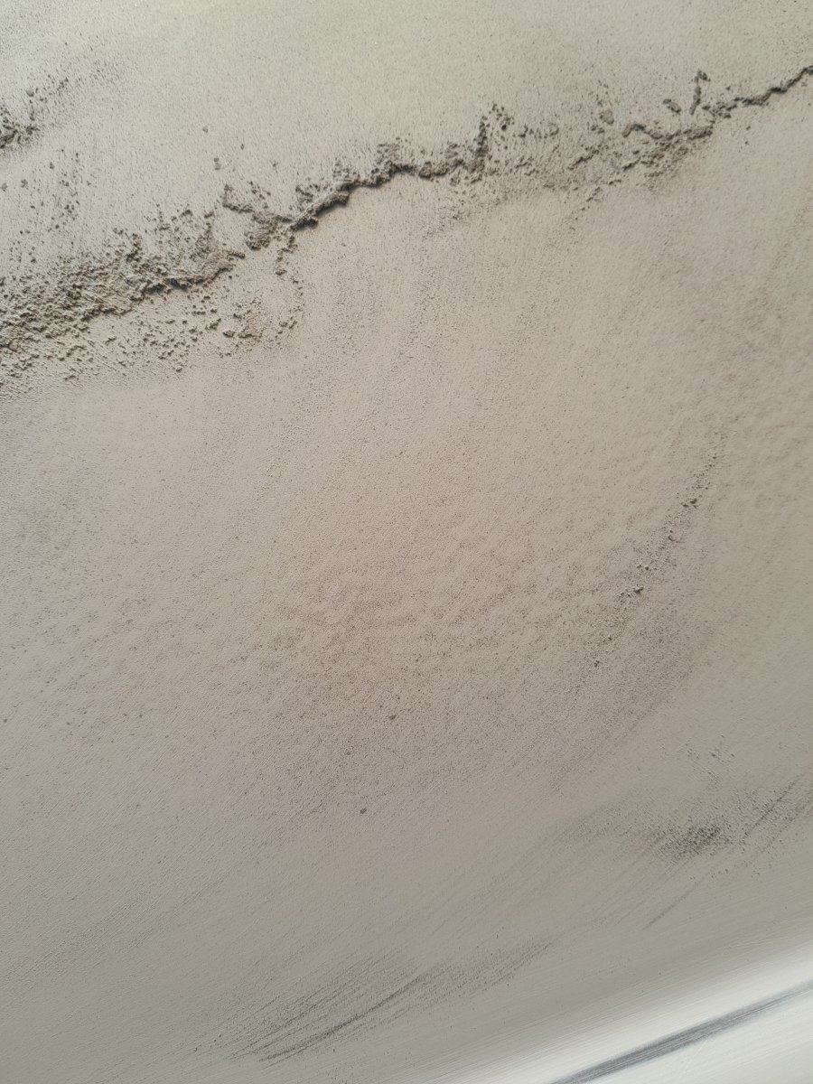

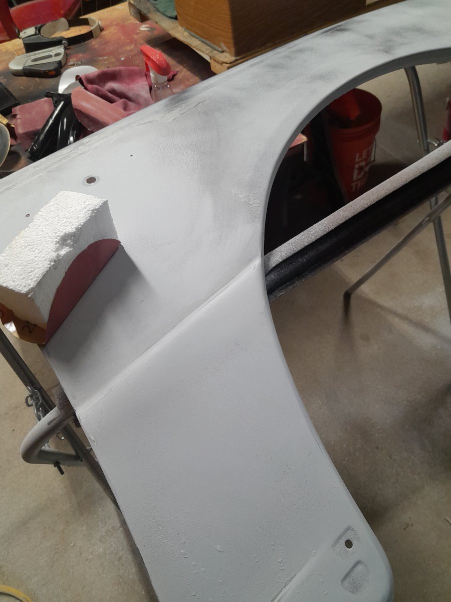

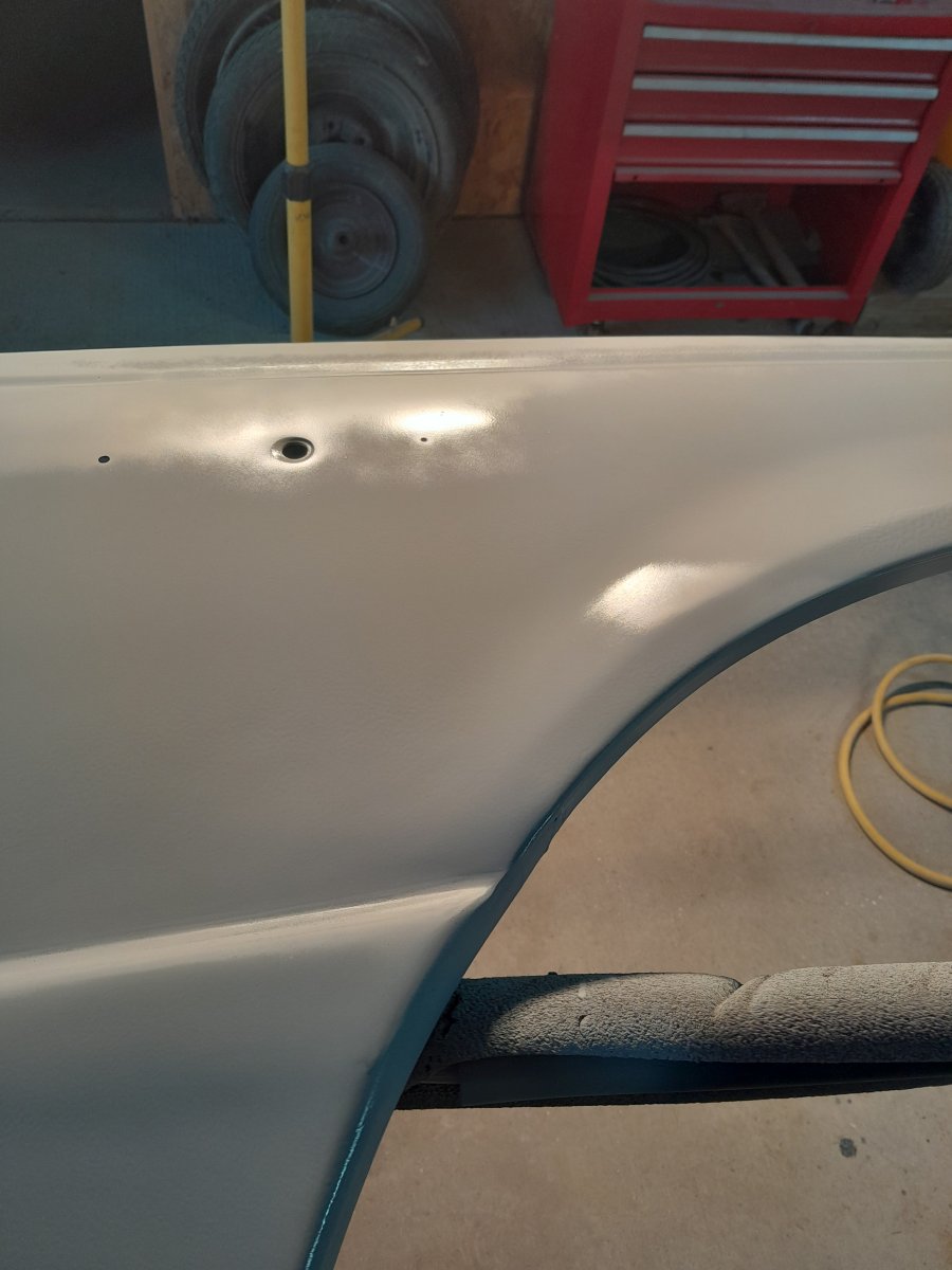

I sprayed down my primer and thought it was pretty good, but no, it was all orange peal. I thought OP was more visually apparent, like an orange peal. Turns out, we think my primer dried too quickly - for which there are a number of causes for another topic.
At any rate he showed me this:
He just lightly sprayed a flat black over the fender. Point being, that it helped define the orange peal. So when you sand it, the the low spots show the depressions...when they're gone you are, for the most part ---level. Lots of caveats here, but it was enlightening to me.
I'm a complete amateur at this and am enjoying every bit of it. I have the benefit of you guys and the SIL who's a body guy at (someplace dealer in Richmond, mi)) but I digress.

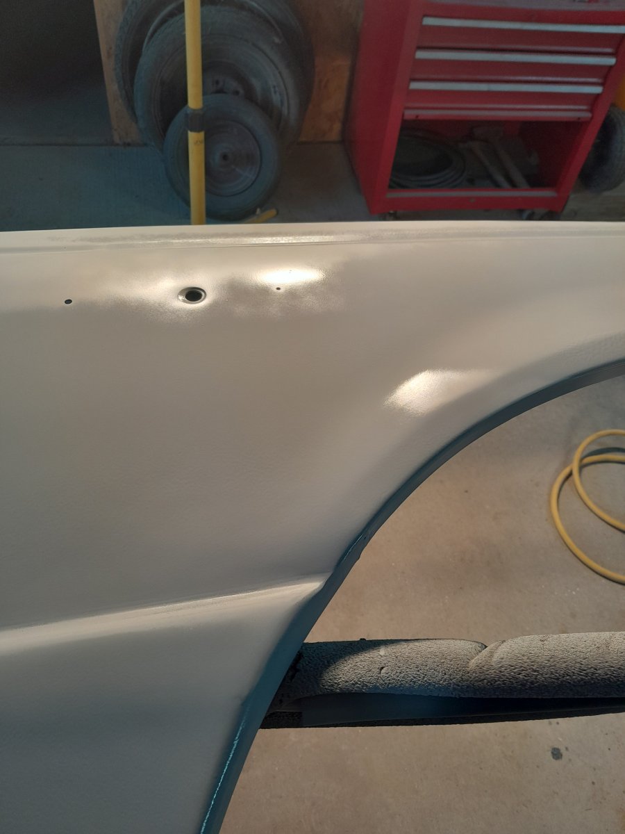

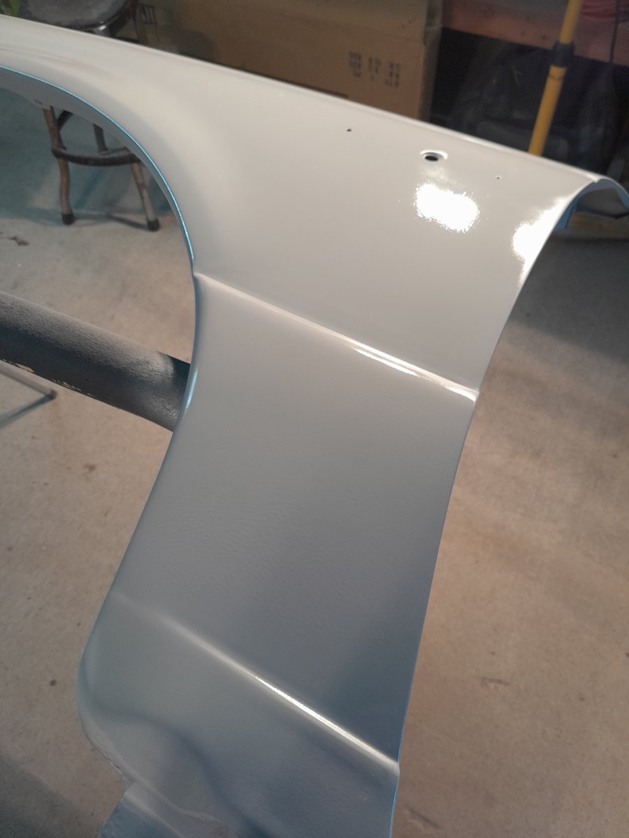

Learned a lot over the past few days about applying primer and orange peel (or is it peal). First is it's hard to avoid and second is how to get rid of it and third is "don't worry about it." HVLP gun set-up is squirrely. Combining air pressure flow and paint flow with the right pattern to get everything right is time consuming. I assume I'll get better at it as I gain more experience.
Anyway, I got the fenders knocked down and ready for the seal coat and then final paint. Here's a couple pics:
Seal coat:
It goes on kinda thin and wet then quickly dries flat - bout 8- 10 minutes depending on temp and humidity - both reasonable yesterday when I was doing this.

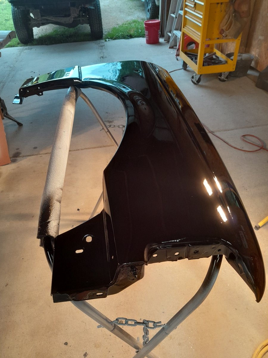

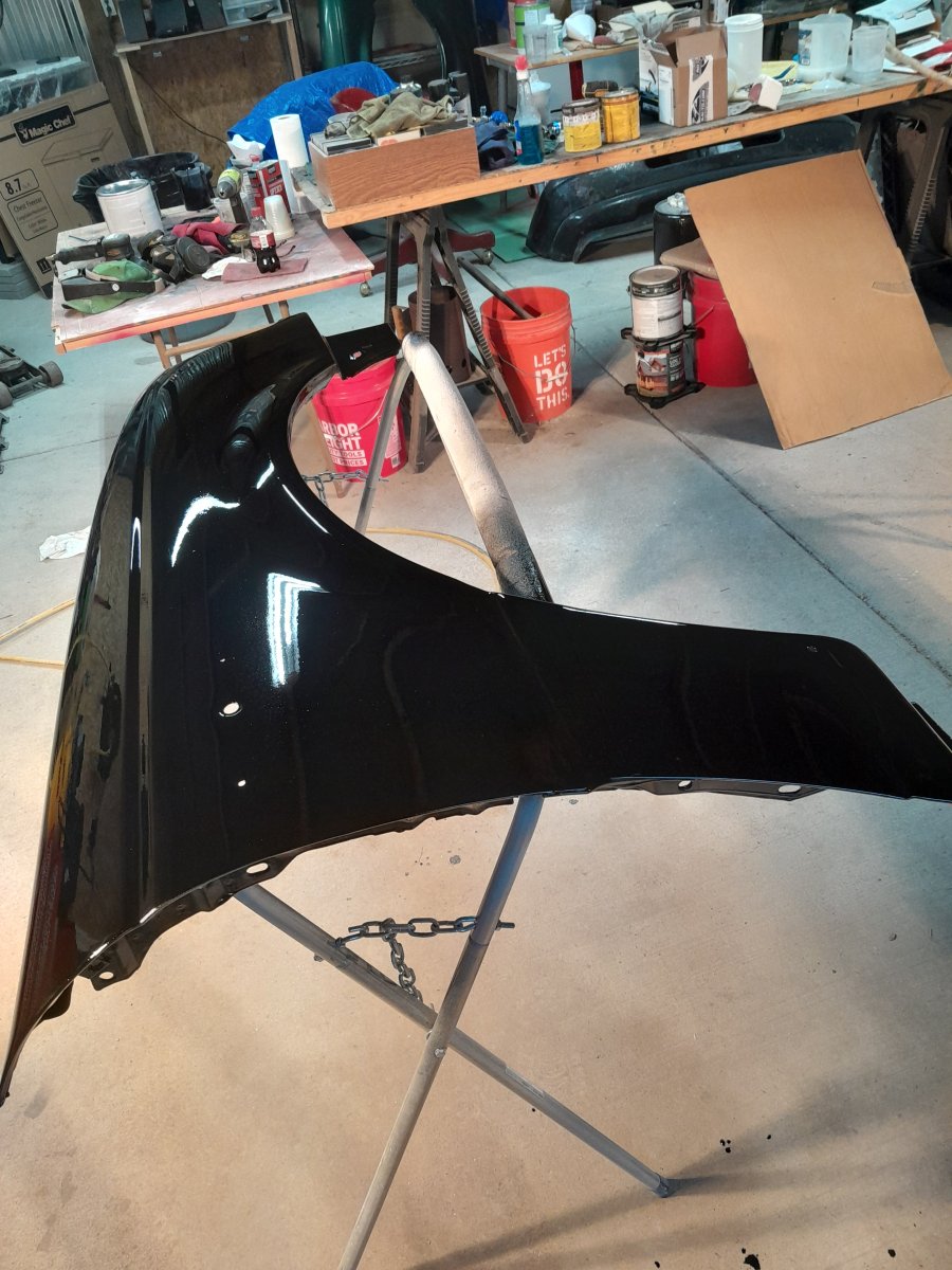

Here's a couple of the final paint.:
I'm really pleased with how it turned out for my first time. Not sure if I need to do another coat - not sure I want to screw it up. :unsure:
Wow, that looks really good. Black is the hardest to get straight. It shows everything. You did great on it. Paint/bodywork takes patience, but it is rewarding when done and it feels like a newer truck then when you are done. Great job!!!

I mentioned earlier about using a light over spray to help identify high and low spots (orange peal). This image shows that in action. Using 280 on a styrofoam block you can see how it works. Helps a lot.

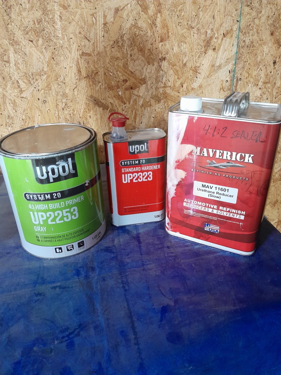

@Shran
I am using the same stuff I think:
Left is Primer, right is sealer. You can see on the can I noted 4:1:2. And yes running the sealer was quick. It flashed in about 7 minutes. Very thin. I painted the black over it after about 30 minutes.
