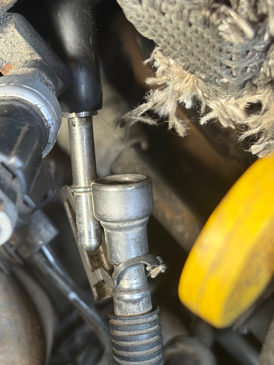

Is there something missing from this fuel connection? I feel like there is and it doesn’t want to stay together very tightly…

If you're swapping things around every now and then Ford switched between quick connect types or between 5/16" and 3/8"...

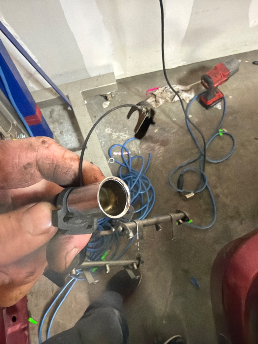

Yeah, it’s not swapped. I found the other one and there’s no way those two go together. They’re both female sides so with a different retainer clip.
  • Something missing?
Wasn’t missing anything. Just a weird connection

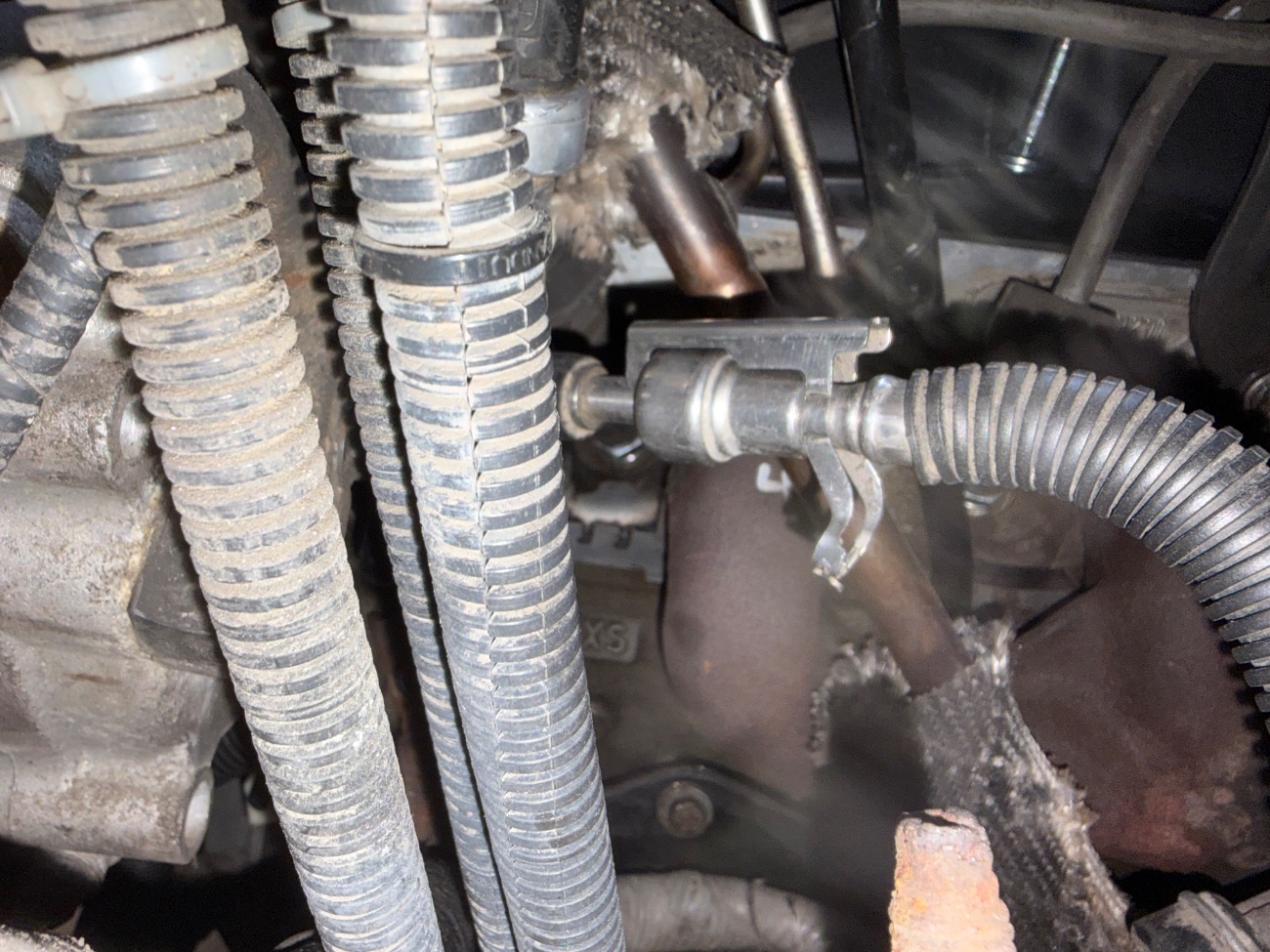

thats not whats on my truck the part i linked is for my truck
Ya my 2002 had one like yours, for some reason this 2006 had a diff style. I looked it up in the factory service manual and that’s how I realized it was fine and how I needed to join them.
So the male end is the style that goes into a plastic quick connection. It would have a white clip that pulls out to unlock it from that lip
