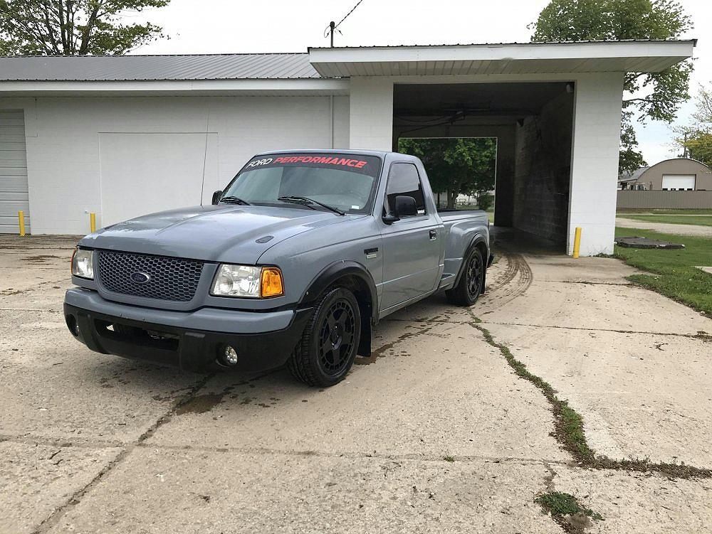

everything else you have to do for this swap is fairly simple, and I would encourage you to be unique with your build. For example, my beautiful front mount intercooler that replaces the grille.
in the shop
blue ford ranger
ecoboost swap
EcoBoost swap in a 2002 Ford Ranger
