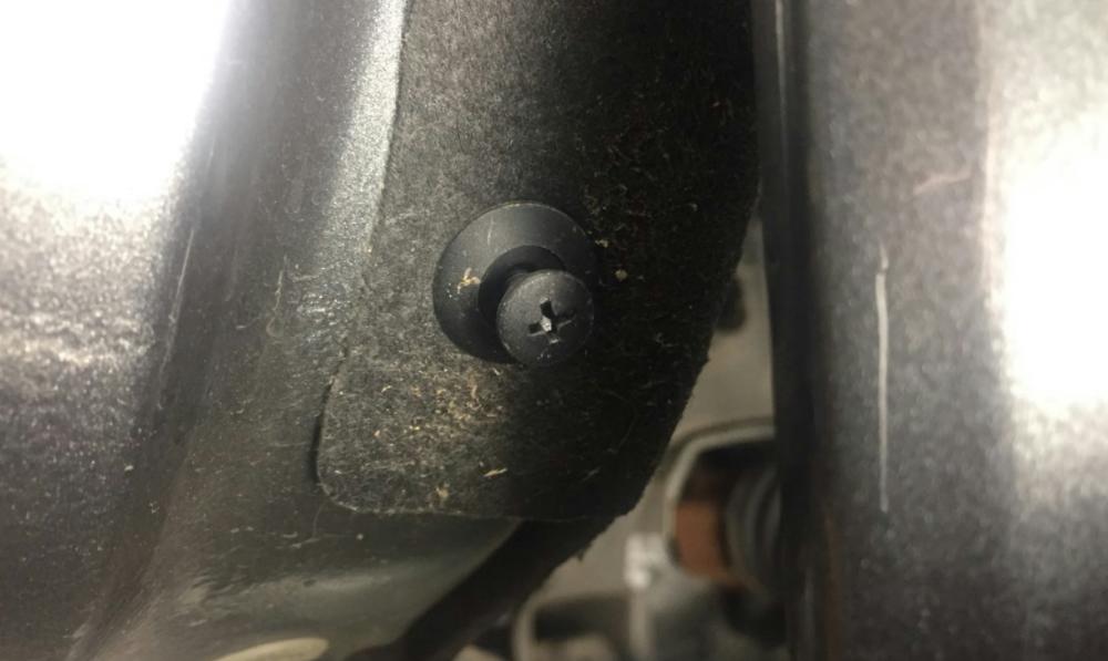

For the rear anti-intrusion beam, start by removing the 4 screw clips in the rear of the fender liner. It may be necessary to use a flathead screwdriver or trim removal tool to assist in loosening the screw.
Once the screw is loosened, pop the screw/ clip assembly out of the retaining hole.

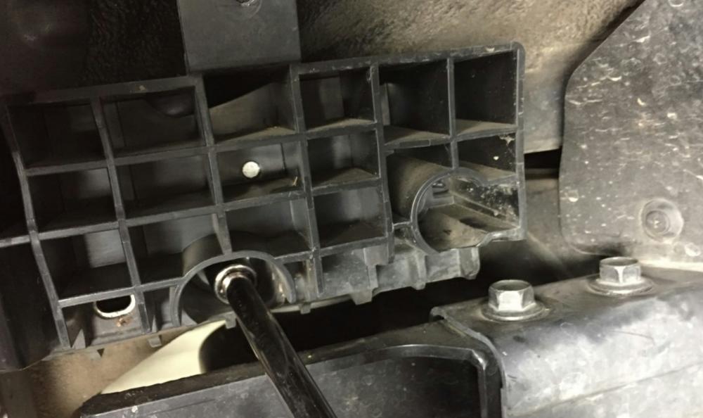

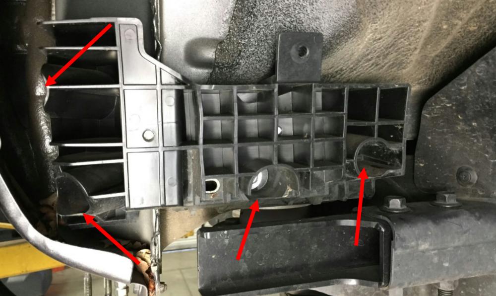

Carefully peal back the fender liner to reveal the four M8 bolts holding the plastic inner crash structure.
Remove the bolts and crash structure.

I struggled at times having enough space to cut the old intrusion beams. I ended up using my grinder with a cutoff wheel and a Sawzall.
If you try to remove the beams without removing the plastic crash structure, you’ll end up trimming the plastic so that you’ll have clearance to get one of the bolts out.
