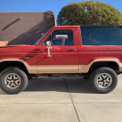

The Bronco II had about 88,000 miles when Peter bought it from a neighbor who was retiring from the Army and moving back home. The body was remarkably solid and largely rust-free, but the paint was badly worn and the truck had accumulated plenty of questionable repairs and modifications over its 35-plus years.
The power steering pump was making terrible noises. The air conditioning had been disabled because of a failing compressor — something that simply wasn’t going to work in Peter’s part of Arizona. The exhaust had been modified with the catalytic converter removed and a Cherry Bomb muffler installed ahead of the rear wheel.
There was also a partially disabled alarm system causing a battery drain, poorly installed roof lights, an unsecured aftermarket stereo and plenty of other evidence that previous owners had taken a less-than-careful approach to the truck.

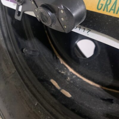

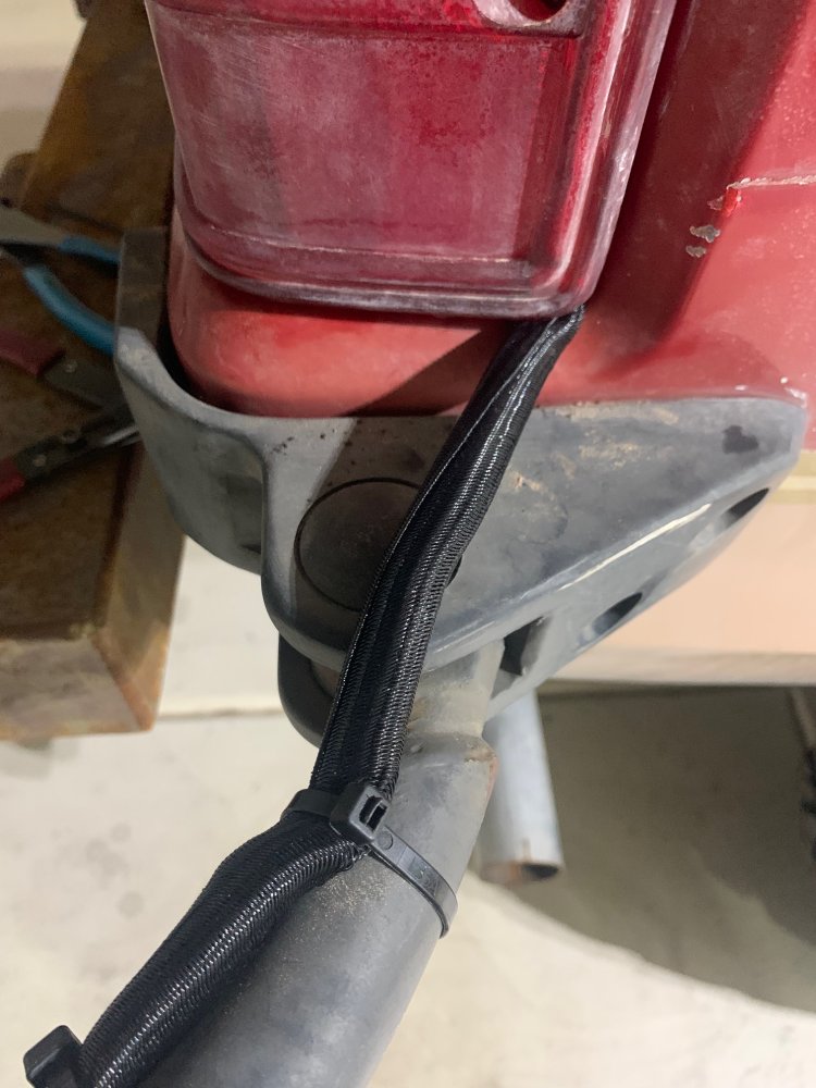

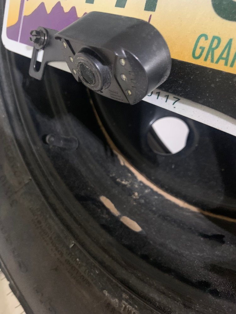

He also used one of Jim Oaks’ how-to articles when mounting a rear-view camera to the spare tire carrier.

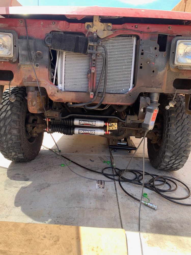

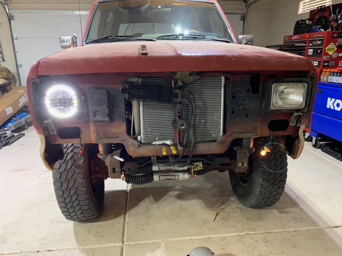

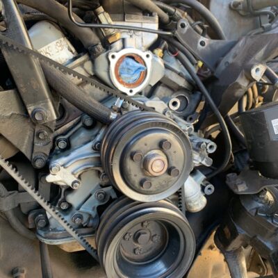

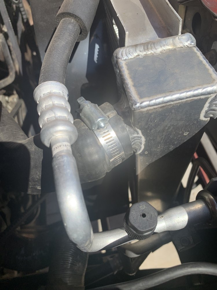

The truck had already been fitted with an aftermarket aluminum radiator, but Peter found a number of problems with the cooling system, including an incorrect or missing thermostat, questionable hoses and a cooling system that needed a thorough cleaning.

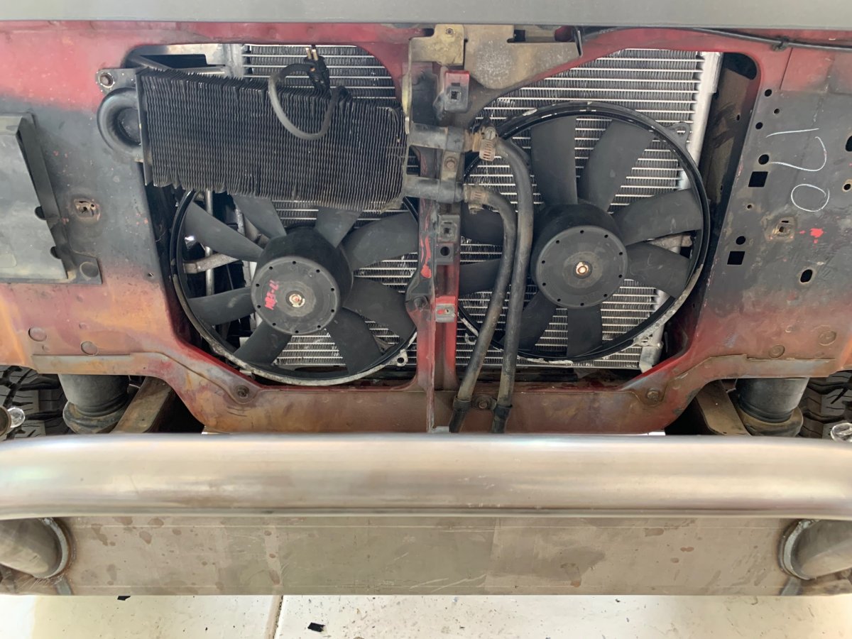

He flushed the system repeatedly, replaced hoses and the thermostat, installed another radiator, experimented with fan and shroud arrangements and eventually moved to a Dakota Digital fan controller and electric fans.
It wasn’t a straight line to success.
There were problems with the fan installation, temperature sensors, wiring and even the direction the fans were moving air. One fan turned out to be defective and was pulling nearly 50 amps. At one point Peter was chasing temperatures that climbed during extended idling while the A/C became increasingly ineffective.
But he kept working at it.
Eventually he found the combination that worked. With the defective fan removed from the equation and the remaining fan operating in the correct direction, the Bronco II could sit and idle with the A/C running in 108-degree temperatures while maintaining coolant temperatures around the thermostat setting.

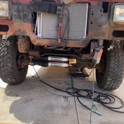

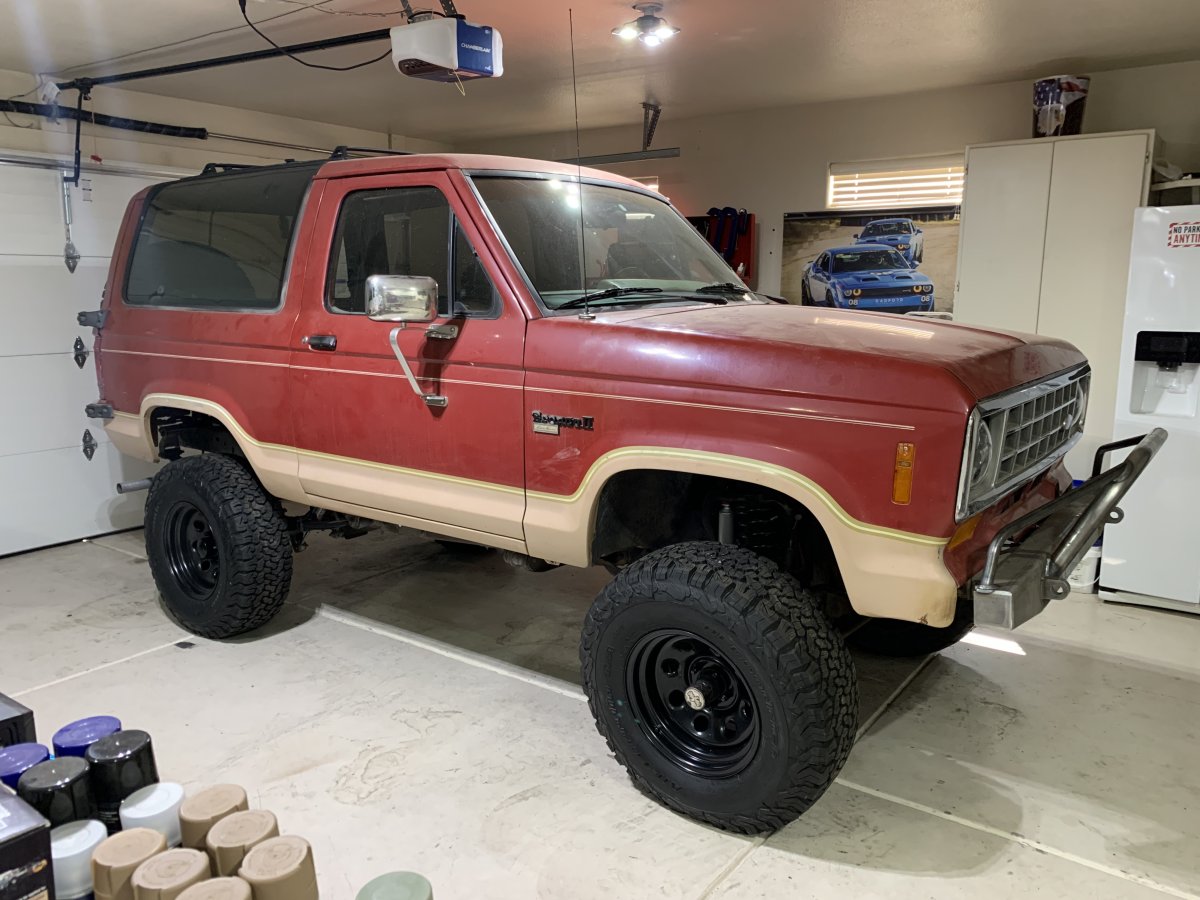

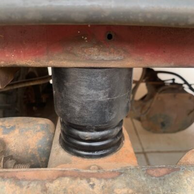

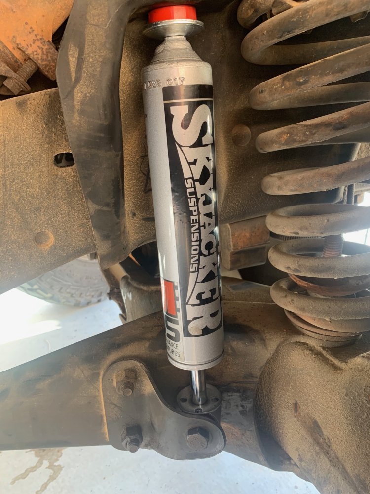

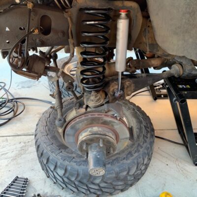

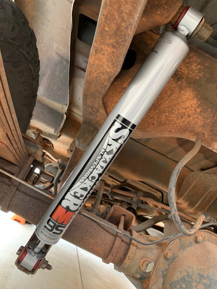

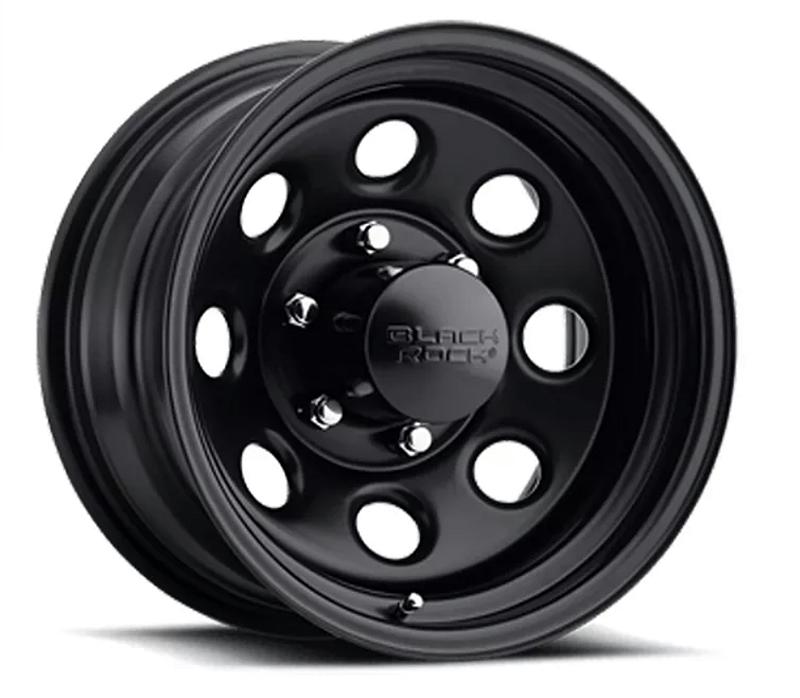

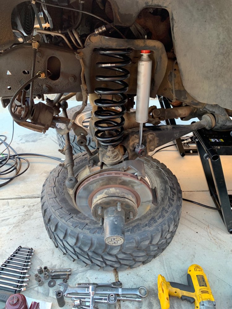

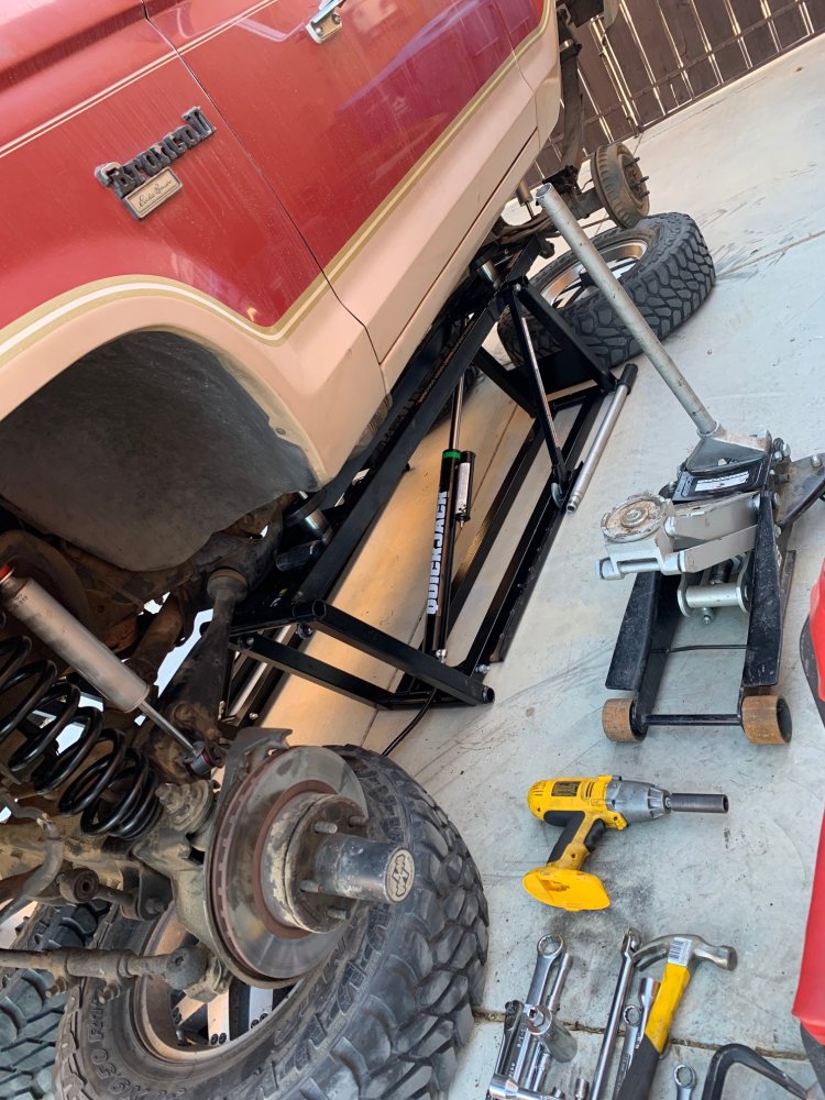

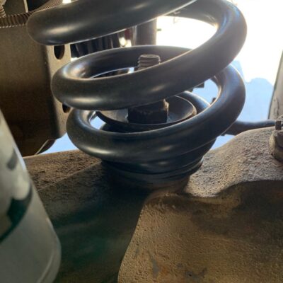

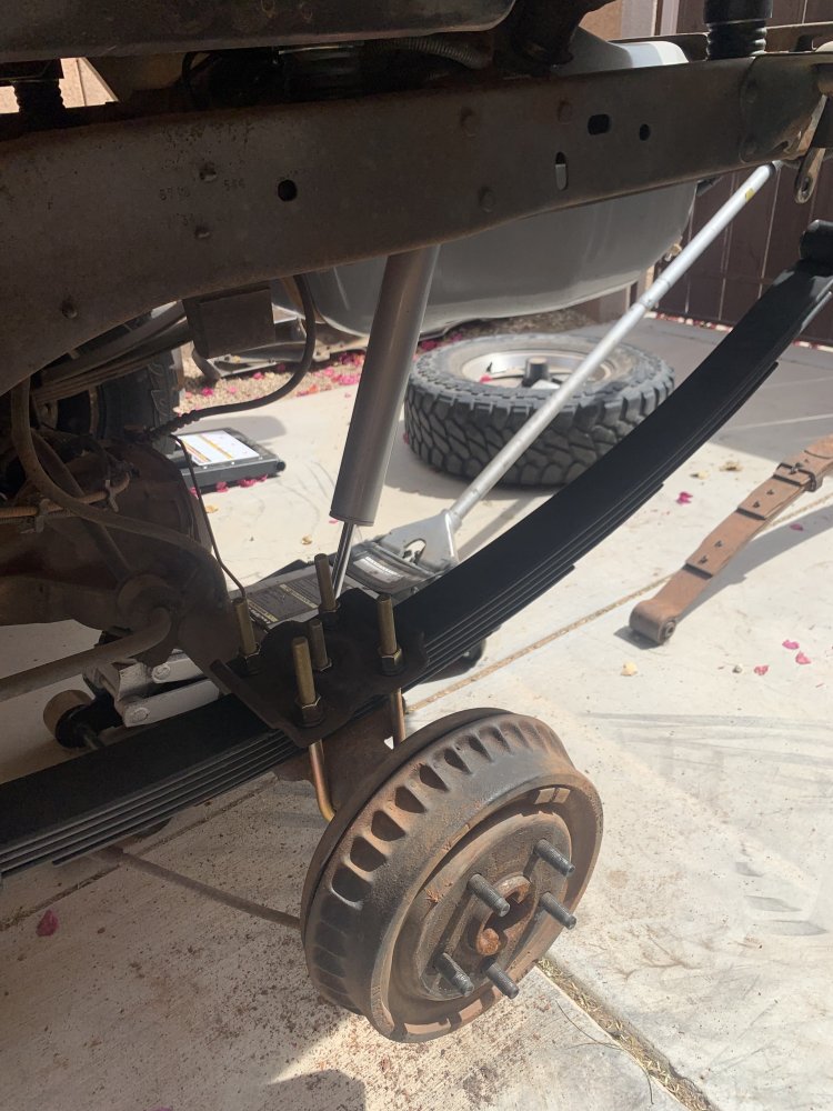

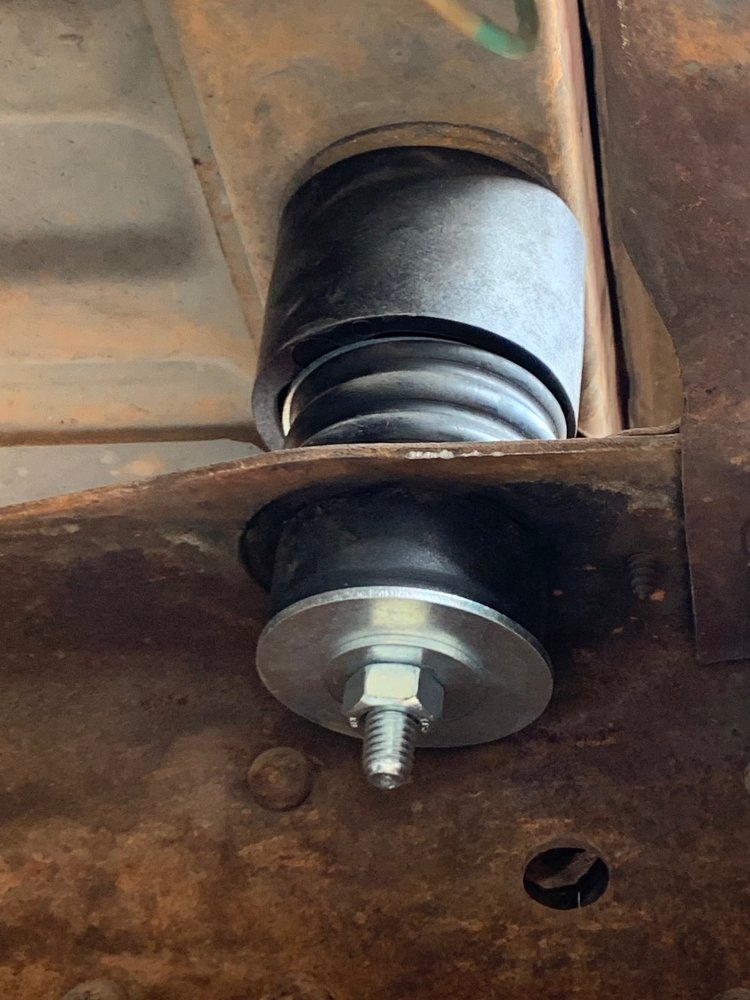

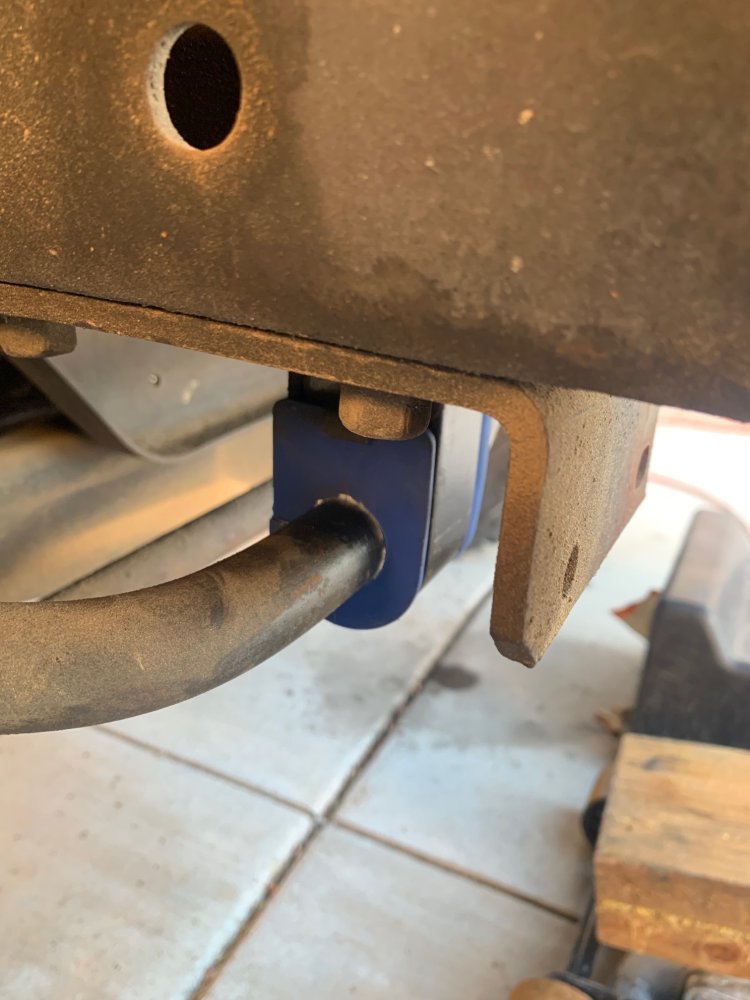

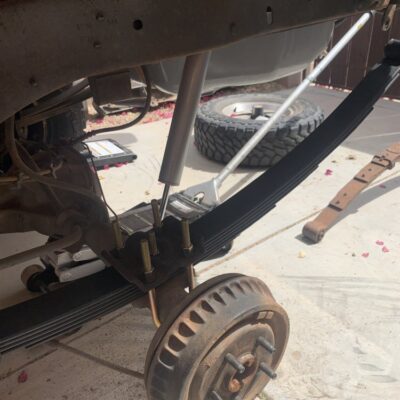

He replaced the original three-inch body lift with a two-inch lift and went through the suspension, using Skyjacker components and replacing worn bushings and other components. After dealing with some parts problems along the way, he eventually got the proper drop brackets installed and had the truck aligned.
With 31-inch tires, new wheels and the suspension sorted out, the Bronco II became remarkably stable on the interstate for a 35-year-old short-wheelbase truck.

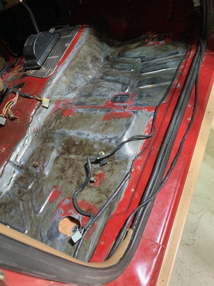

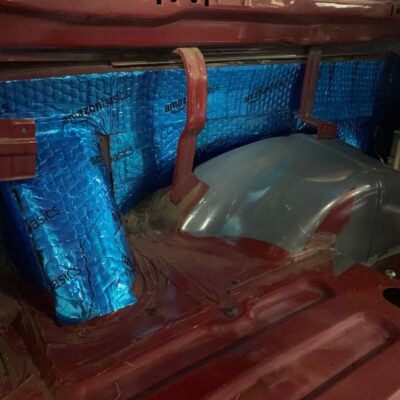

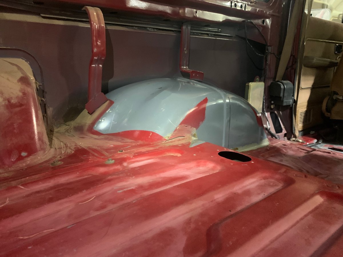

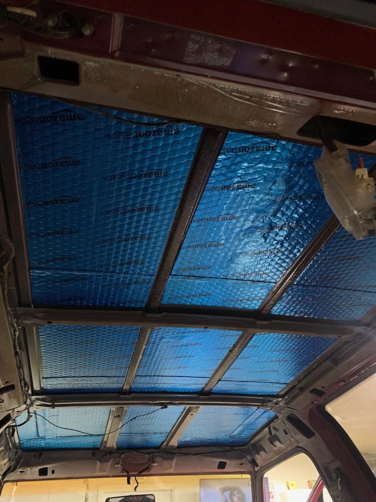

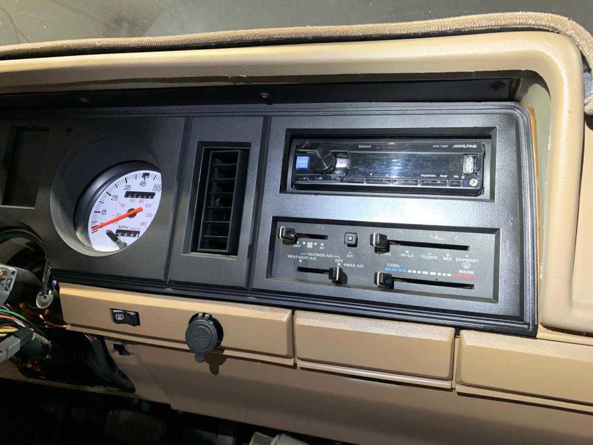

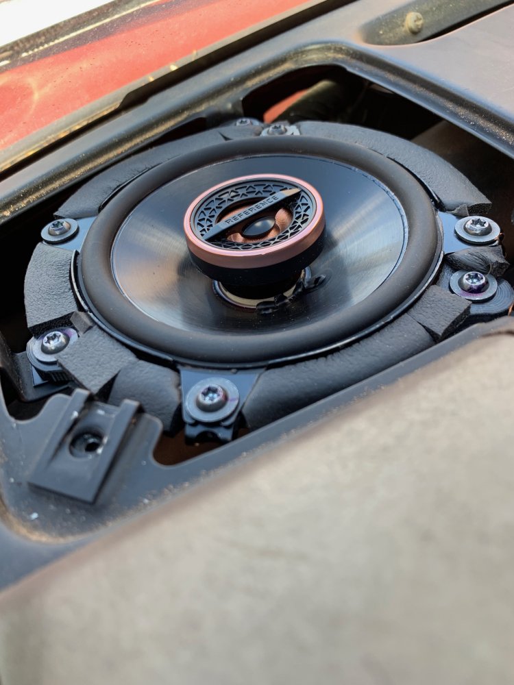

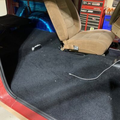

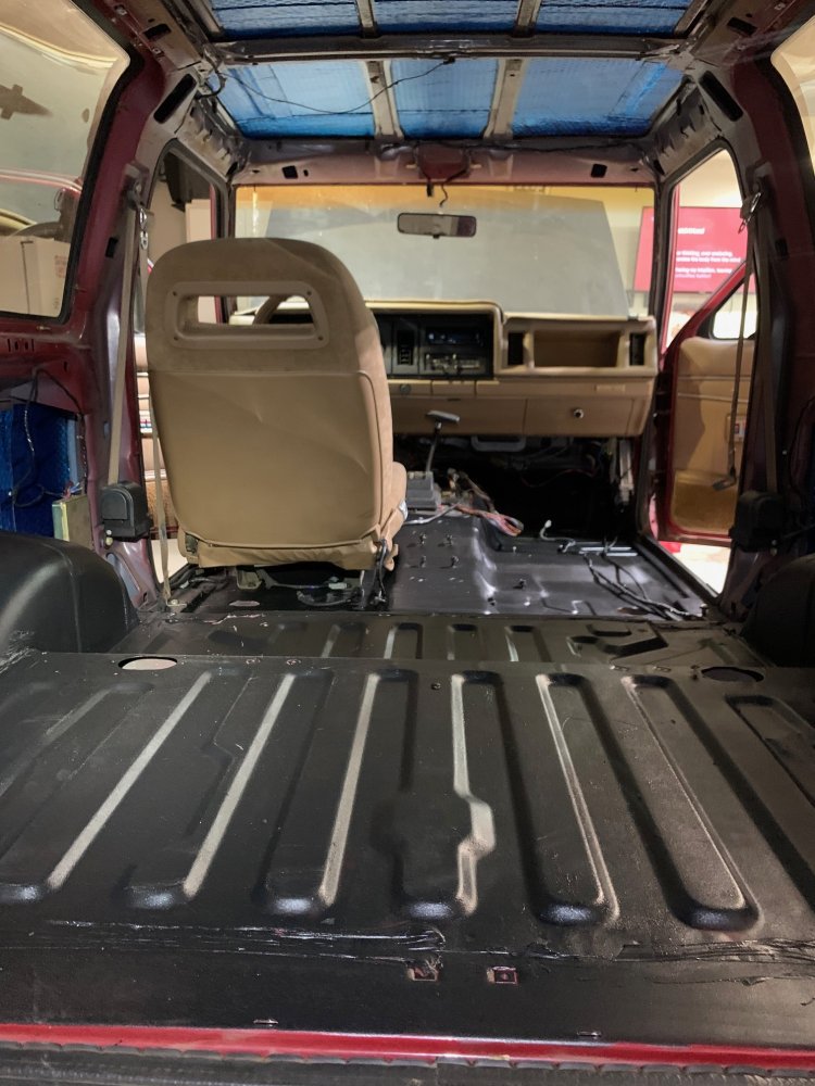

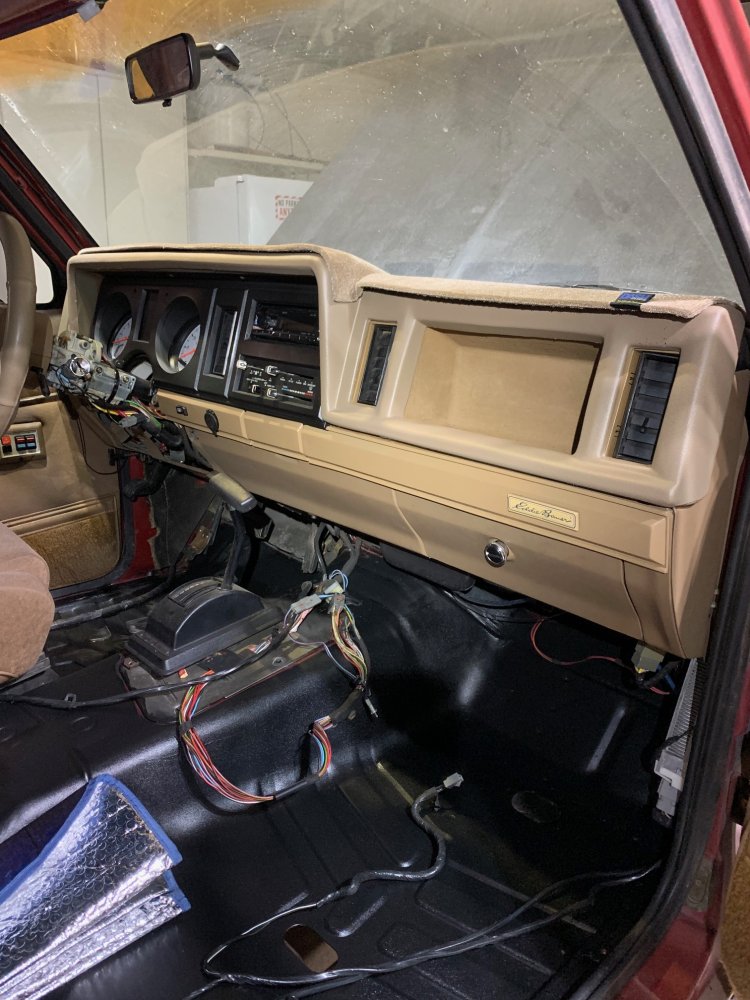

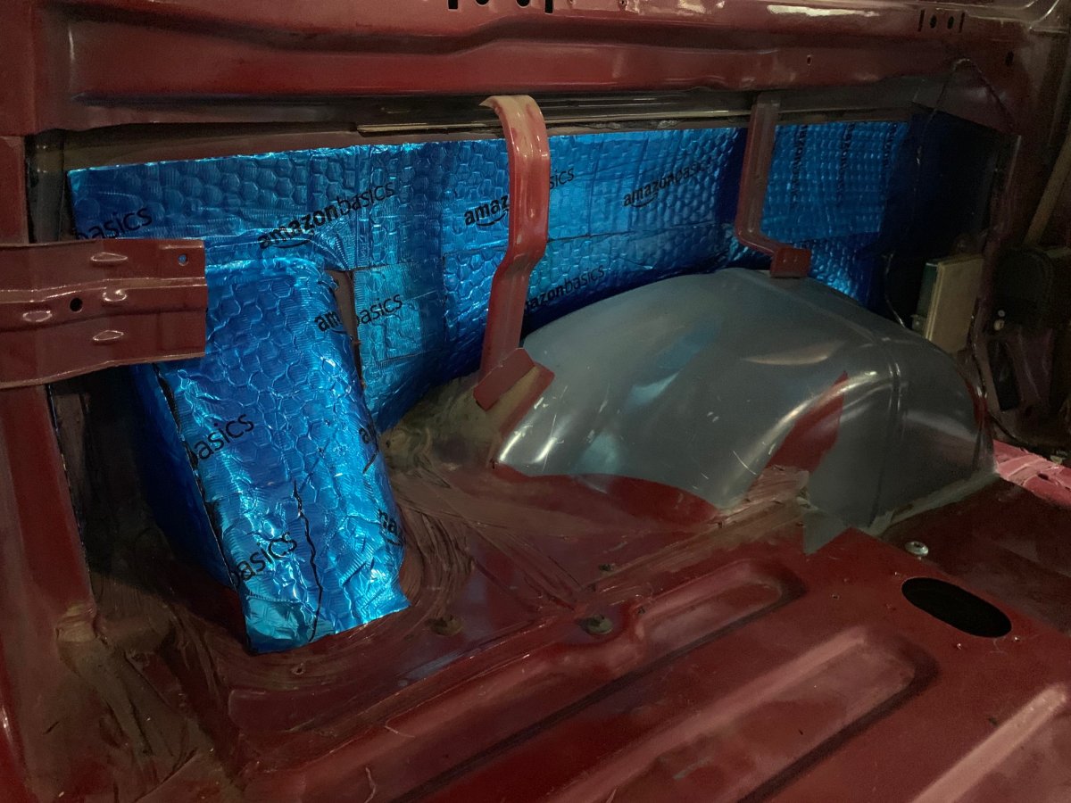

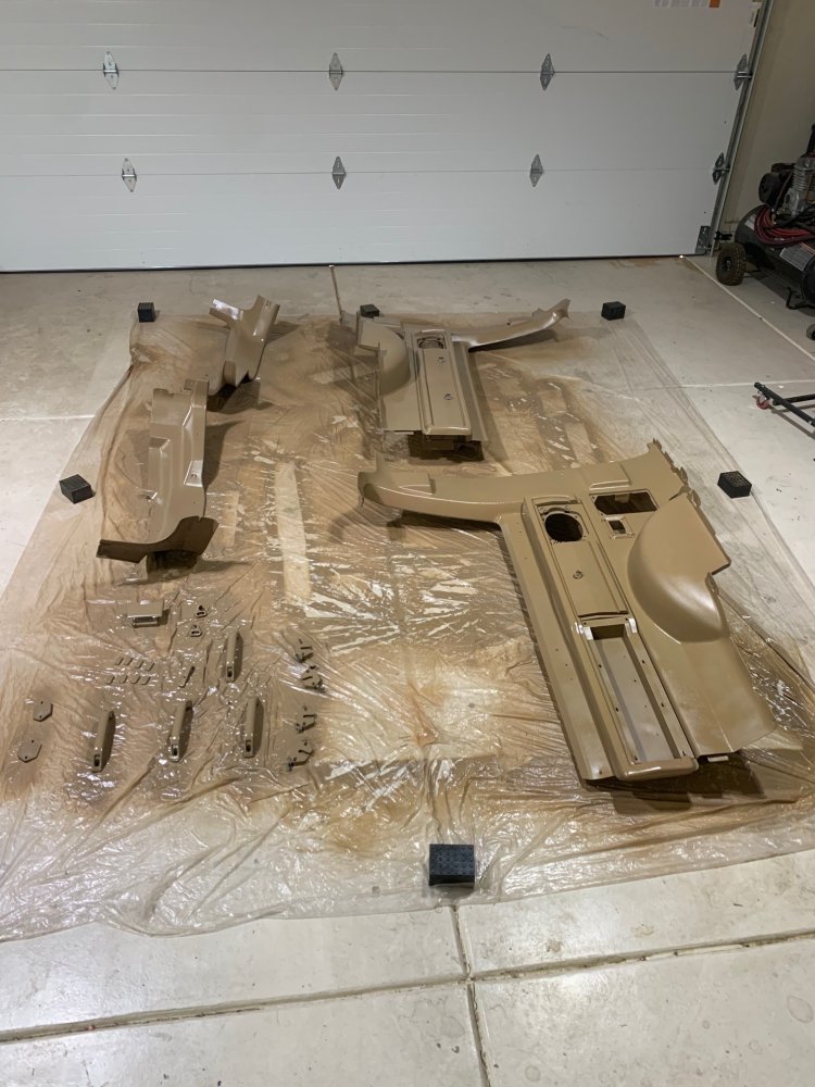

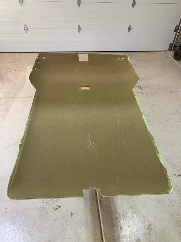

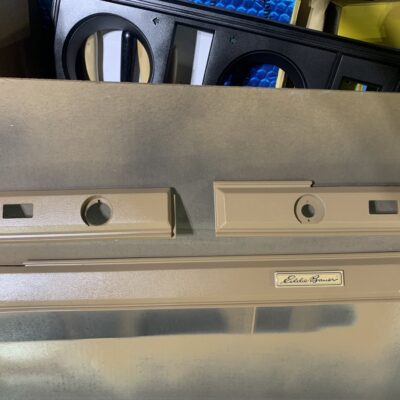

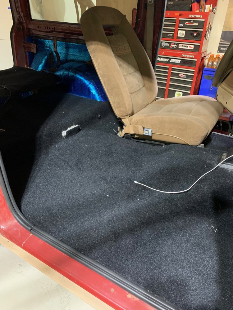

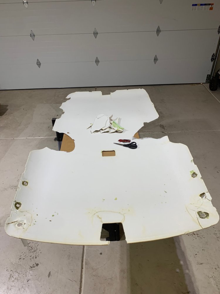

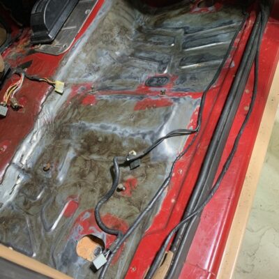

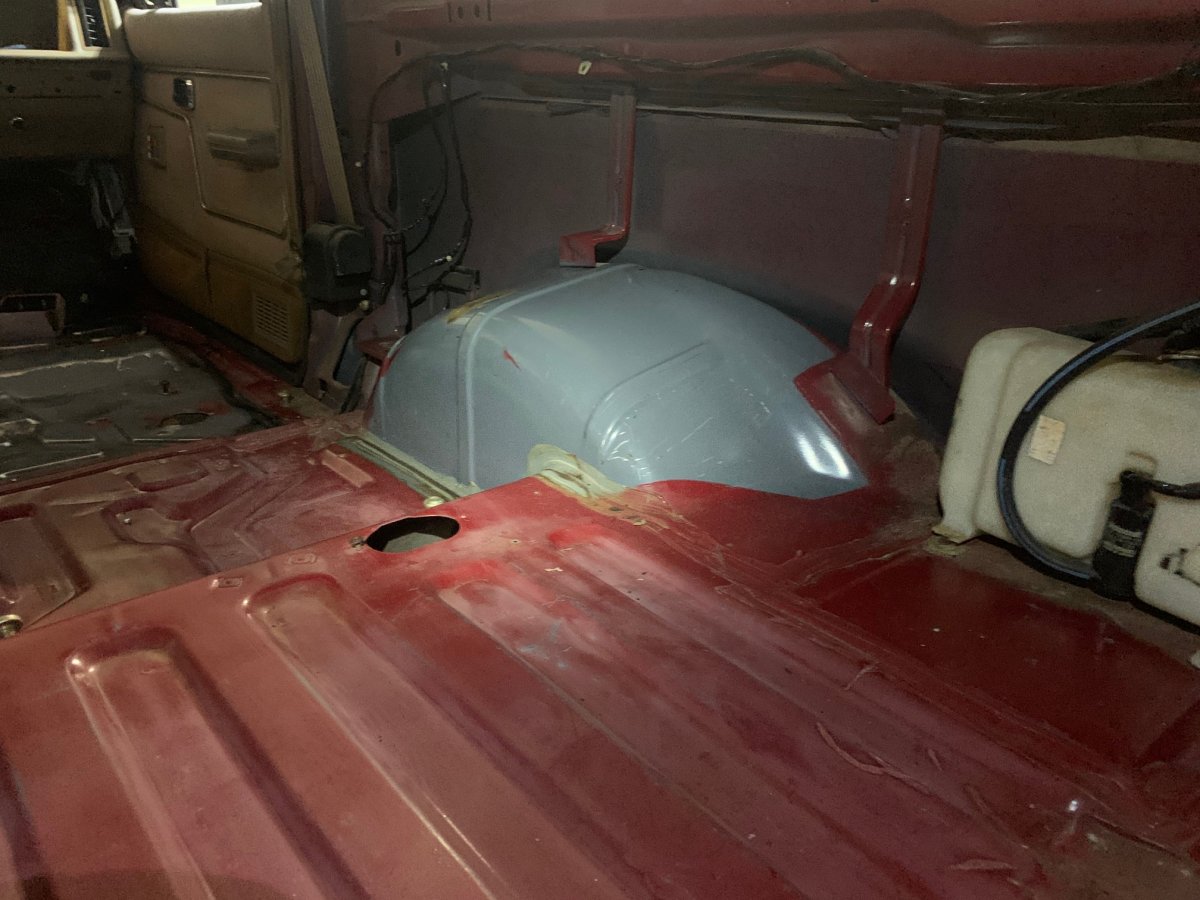

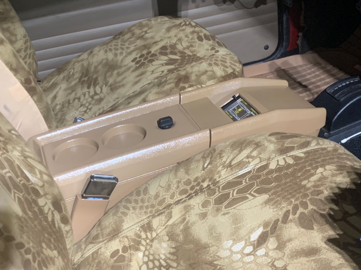

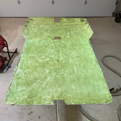

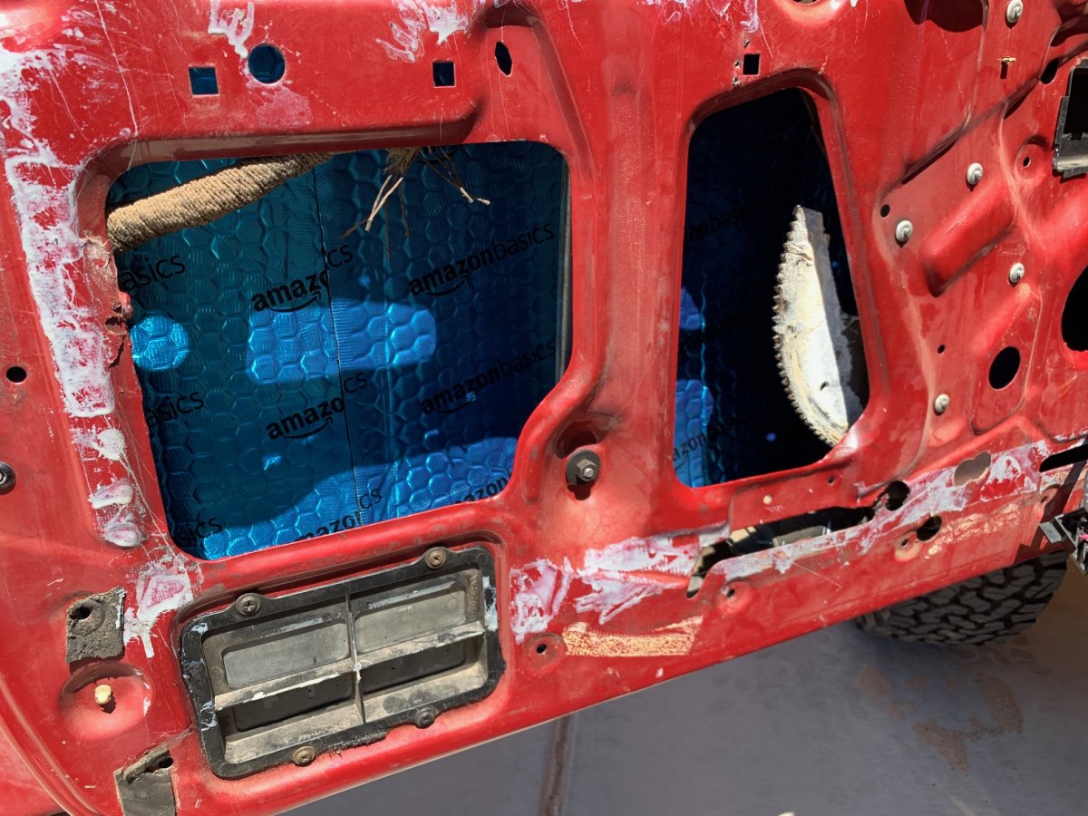

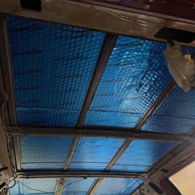

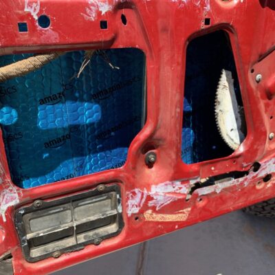

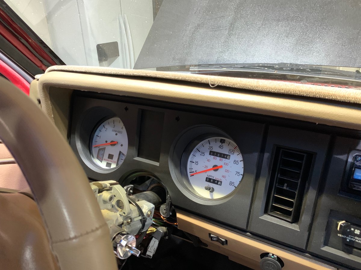

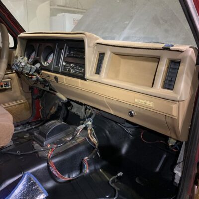

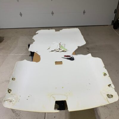

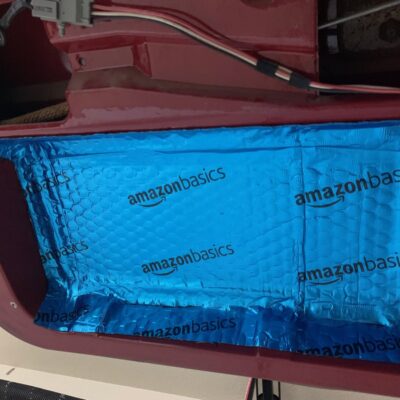

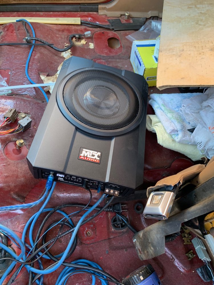

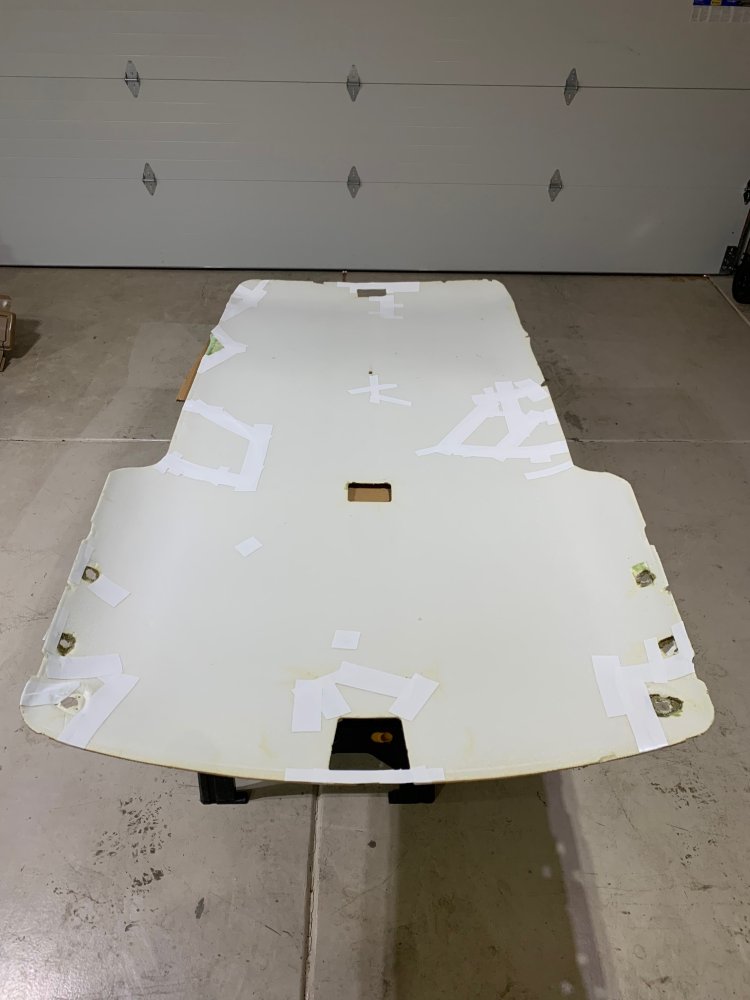

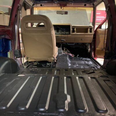

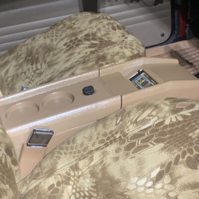

Peter stripped and cleaned the interior, treated the floor, added sound deadening and insulation, installed new carpet and headliner materials, refurbished the dash and installed Coverlay components. He upgraded the lighting, added an Alpine head unit and Infinity speakers, and installed a powered subwoofer.
1988 Ford Bronco II White Face Gauges

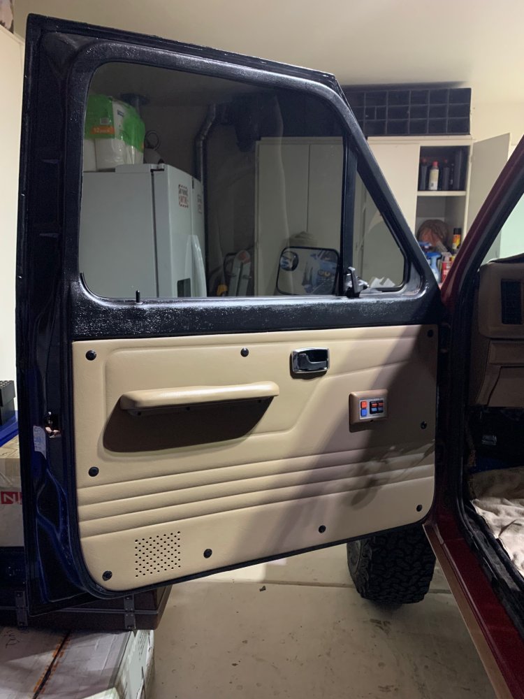

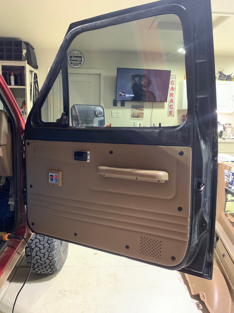

The doors were rebuilt with new glass, weatherstripping and wipes, and Peter spent hours getting the details right.

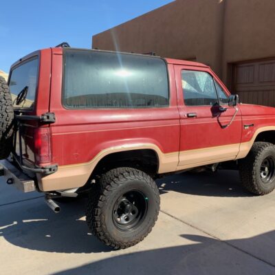

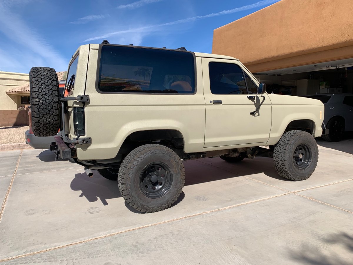

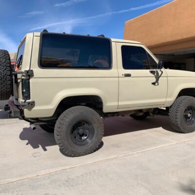

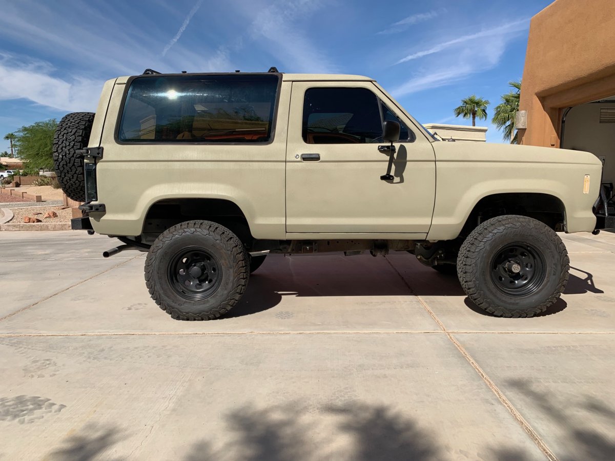

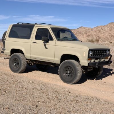

Outside, the truck received a desert-inspired finish with Raptor liner, black trim, bumpers and other refinements. The result wasn’t intended to be a concours restoration. It was a Bronco II built to be used.

Ford Bronco II Skyjacker Suspension

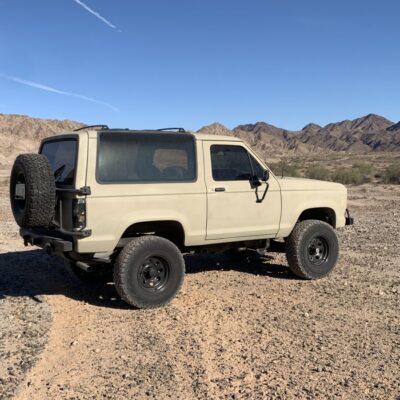

It was reliable, cool-running, comfortable, quiet and capable of handling the environment it was built for. Peter even took it back out into the extreme southwest Arizona desert to photograph it in its natural environment.
