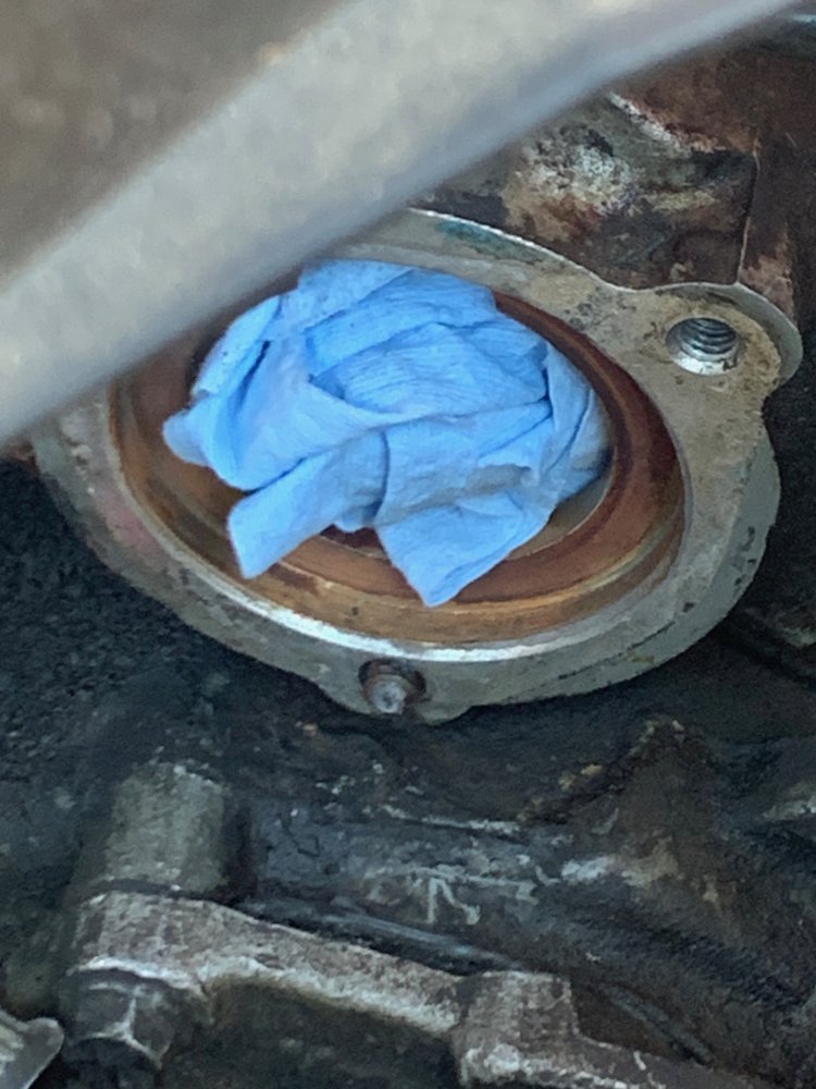

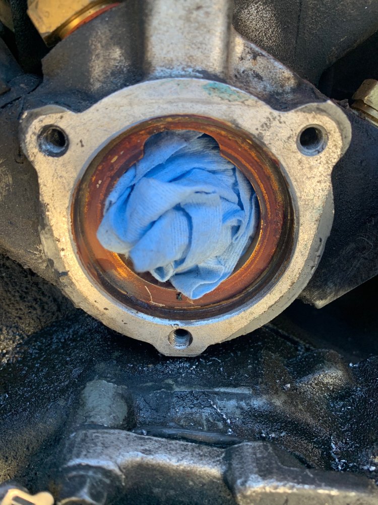

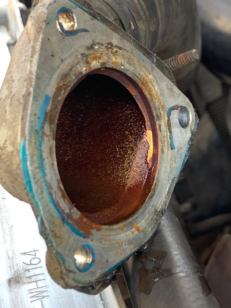

@Uncle Gump with our insane peak summer temperatures the cooling system (for the truck itself and the passengers!) is super critical. My friend/PO told me he thought it was weird that the temp gauge hardly ever moved, and although I thought the fancypants 3-row aluminum radiator might have something to do with, once I got into it I discovered it was one of the two things I thought it was...
...a "stealth" thermostat...! :ROFLMAO: Also stealth-like was the gasket which you can see was replaced with an insufficient amount of silicone gasket material...

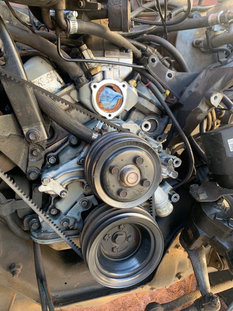

So thus began the flushing process, including a reverse flush of the heater core and MAN did some crazy stuff come outta there. While I was flushing it I decided to (1) leave the thermostat out and (2) likewise save the new gasket for when it was finally flushed out and cleaned and ready for coolant. While futzing with all of this I noticed the Motorcraft part number for the upper radiator hose match the part number...for the lower radiator hose. An image search of stock versus Alloy Works radiator clearly showed the radiator inlet/outlet were configured differently from stock. Not only that but the upper hose had to be pulled so hard to get the thermostat housing neck to line up with the block that the hose partially collapsed, by about 25% I'd say. New hoses were in order but since this was a custom application I went with the universal Gates style that are trim to fit. Getting ready to have it, what happened next was par for the course...

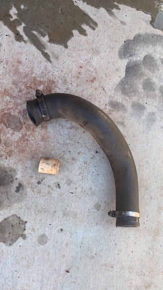

But wait! There's more... The crown jewel of the cooling system teardown was this:
...yes, your eyes aren't deceiving you, that's a chunk of PVC pipe that fell out whilst (yeah, I said "whilst"!) removing the lower radiator hose. The block end of the hose looked like it had been cut by the gnashing teeth of a rabid wolverine too.

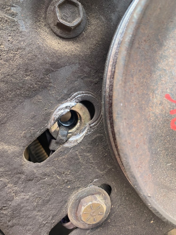

Spent a lot of time on it this past weekend and likewise will today. In the process of taking the power steering and A/C compressor off I found a series of homemade "spacers" that were basically stacked washers that were zip tied together and the tail of the zip tie was still intact, likely used to get it in position while threading the bolt. :rolleyes:
The A/C compressor had only 3 bolts in it which was rectified by a trip to the hardware store. To get as much fluid out of the steering box as possible I turkey-basted the reservoir to empty that and then saw a couple of good YouTube videos about flushing the system (although some were generic and not specific to the 2.9 Bronco II/Ranger). By lifting the front end and turning the wheel with the motor off I was able to get an additional 16-ounces out of the steering box, so I'm relatively sure it's as good as it's gonna get!
