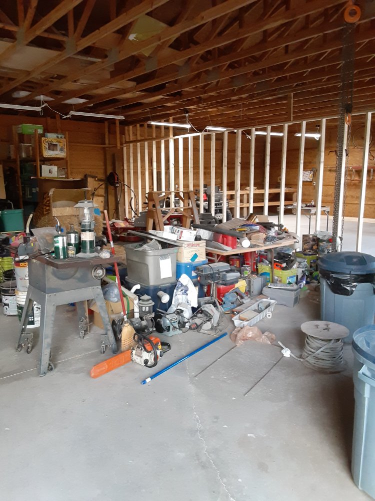

Some pics and a question for ya.
I was planning on walling off the work shop with OSB 3/8" or 1/2" but the cost is - as you may know -- triple what it used to be. For what I need it's almost $600. I just checked the price of drywall. 4x8x1/2" --- $120. What would you do?
This last one is all the stuff that has to picked thru and moved into the shop area.
As much as I hate to mud and tape drywall. I think I would drywall it and paint it white. It will make it brighter in there for sure.
I would wait until plywood goes back down, maybe a year or so.
Screw drywall and everything about it, I don't want it anywhere near my workshop.
If you need to create a patrician because what side of the wall will have A/C or heat, use some plastic tarps stapled to the studs.
You could drywall now. Skip the mud and tape. Then put osb or plywood over it later when price us reasonable.
It's definitely gonna be white gloss white - as bright as I can get it.
I agree 100%. It damages so easily, but the price difference is too much to overlook. Tarps would work though in the interim.
Yes. I wouldn't go through the trouble of mud and tape. I could pick up a piece of OSB here and there so it wouldn't be such a big hit all at once.
Thanks everyone for your input. Good ideas and stuff to think about. 👍
