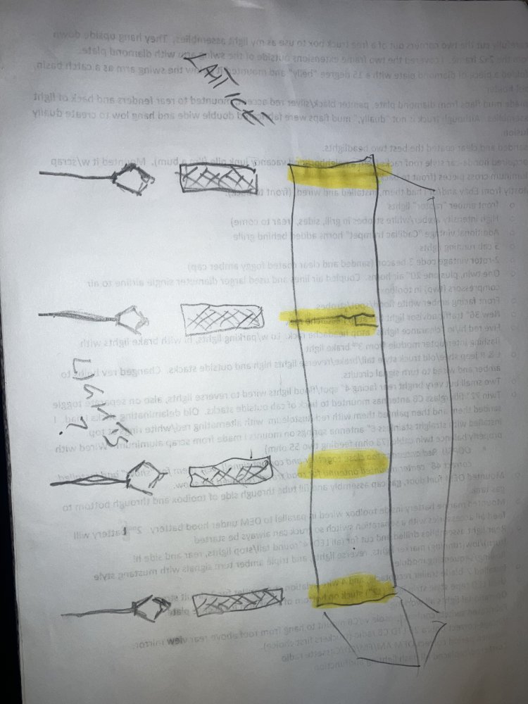

Get a sign shop to print this out 6 feet tall, and stand it up across the street from your shop.
No one will see your wall
I think I suggested something like this before. Find something you can put in front of the crack, and then put it symmetrically up and down the wall so it looks like it’s all supposed to be there.

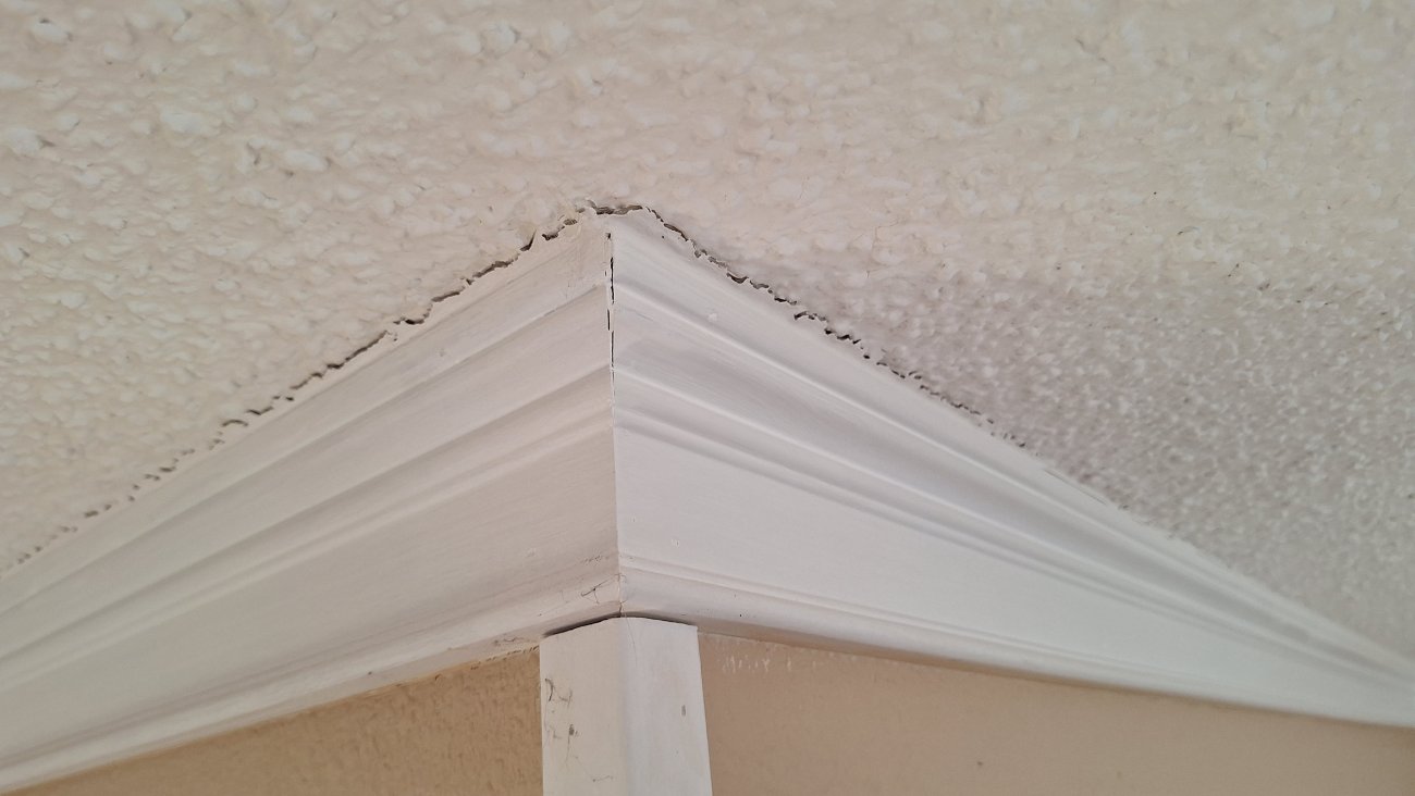

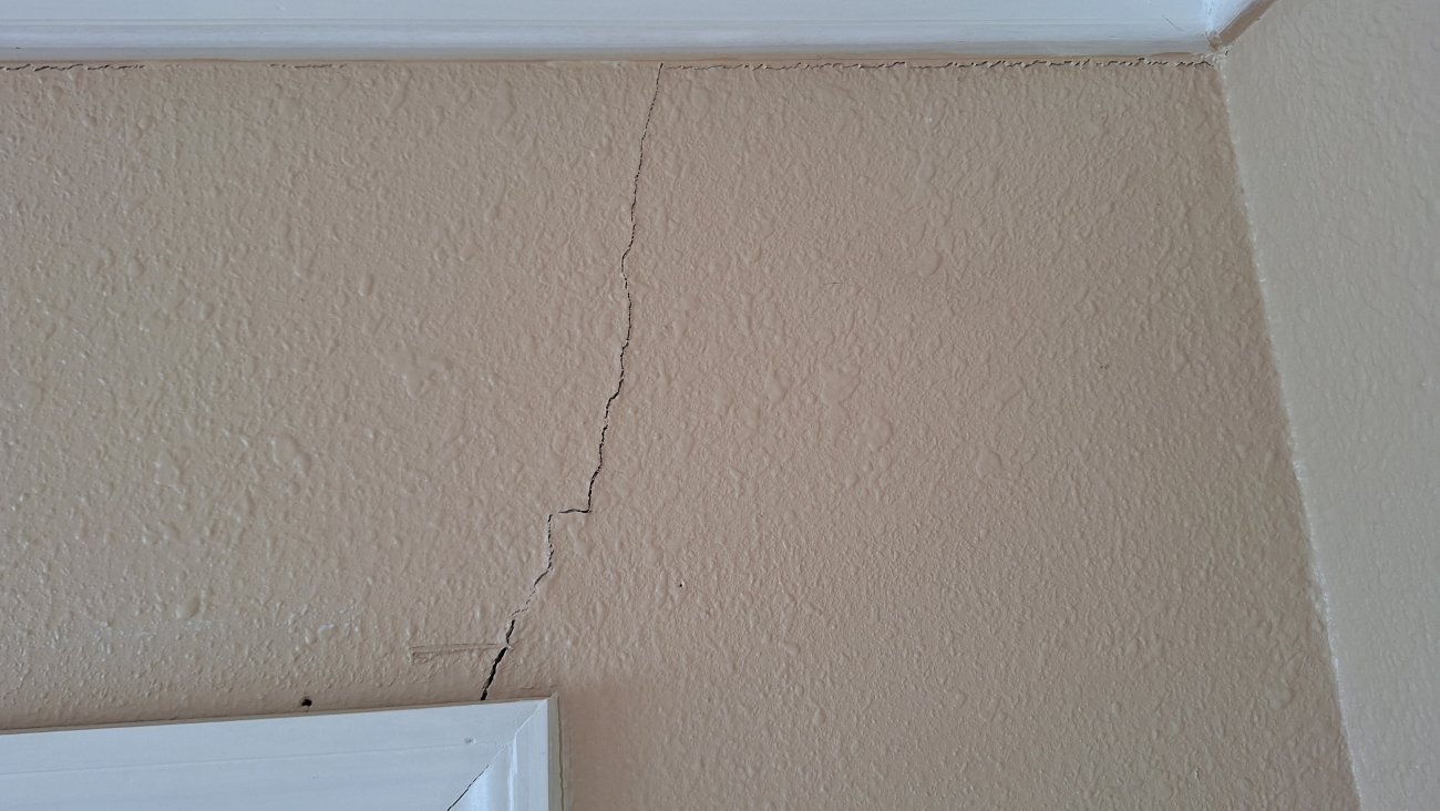

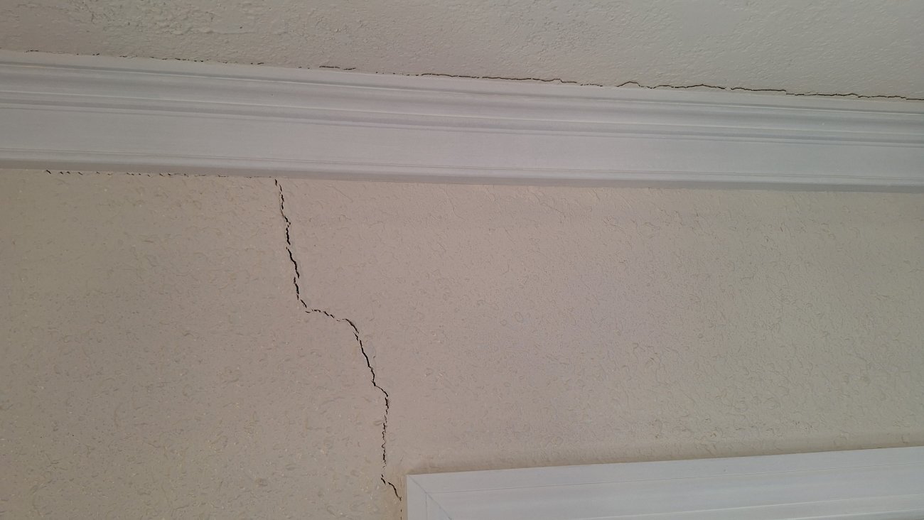

Here's one of the few things I don't like about Texas:
It's warm today and the sun is heating up the house. It's been cold but jumped up to the 60s. I've heard a few popping sounds telling me the house is moving. Here's a couple of cracks. I think one of these is new. I actually filled that last one before I painted that wall. I'm going to have to recaulk a few areas along the crowm molding.
The soil here moves a lot. Newer homes are all on concrete slabs. Mine has a foundation with floor joists. I dated a woman with a slab foundation whose house moved so much it busted a window.

On the cracks, I had the same problem in my house after I added the second floor. But mine wasn’t from ground movement, mine was the big piece of roof that was over the cathedral living room moved like a sail in the wind, and it would crack the walls underneath it at both ends and along the seam to the wall. The painters dug out all the sheet rock mud, and they put in about a 3/8 inch wide caulk seam. We did it intentionally with a little indent, like the mortar between cinderblocks. Nothing has cracked since in over 15 years.
If I didn’t tell you where it was, you would never notice it. But if you look, you can actually see the caulk lines. But they’re straight and square with the windows and the walls, and nobody ever notices it compared to a crooked crack at an angle.

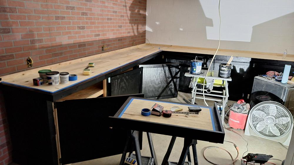

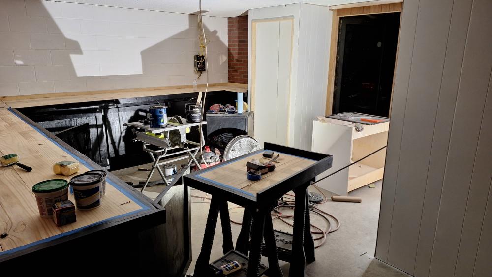

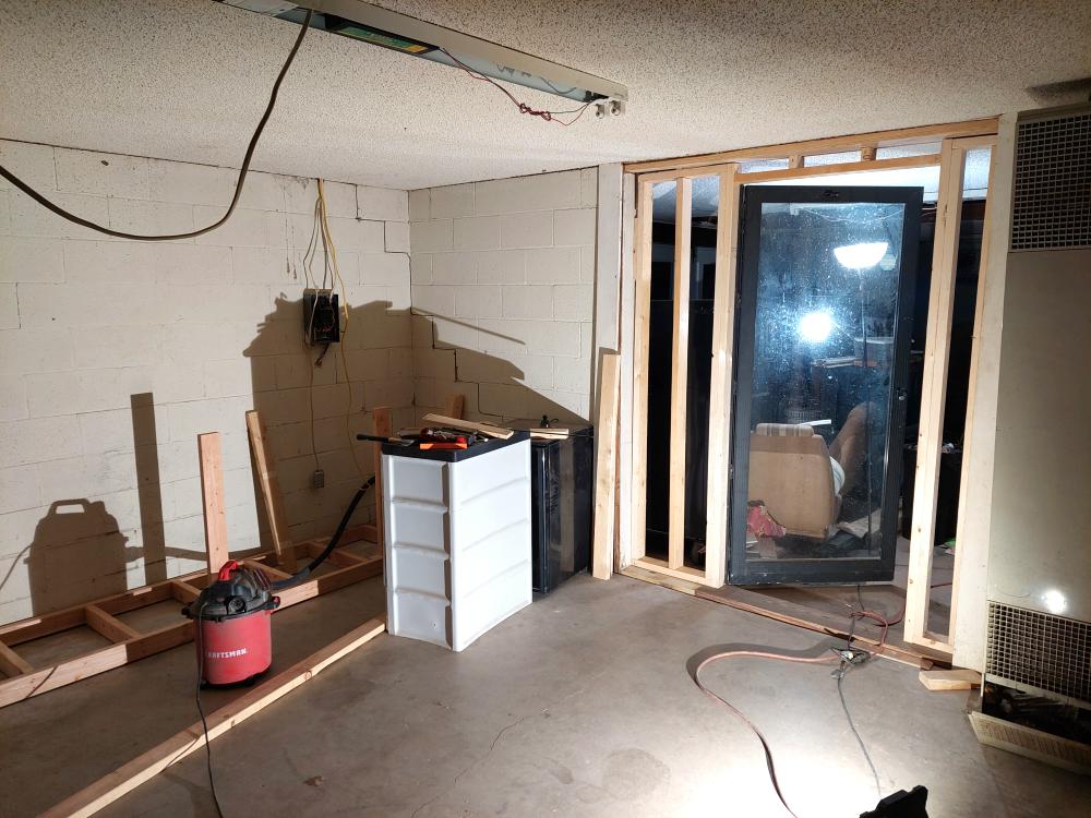

Here is the room in the mid section of the building:
The upright propane heater sitting to the right of the door was where you see the 2x4 framing to the left of the newly added storm door. Prior to that it was just open.
I built a closet / pantry where that heater was, and an L-shaped cabinet with a 2x top that's big enough that I can put (7) large plastic storage containers under it with a shelf that will allow me to store things above those containers. This will help me get rid of the storage containers sitting around the shop and make up for the lack of storage in my house. There's also a small fridge under the counter to the left of that closet so I can grab a cold drink while working out here. The white cabinet on the floor by the closet is a vanity for a sink that will slide back from where it's at and fit in the corner between that door and the bathroom door. You can see the top that I'm making for it on the sawhorses.

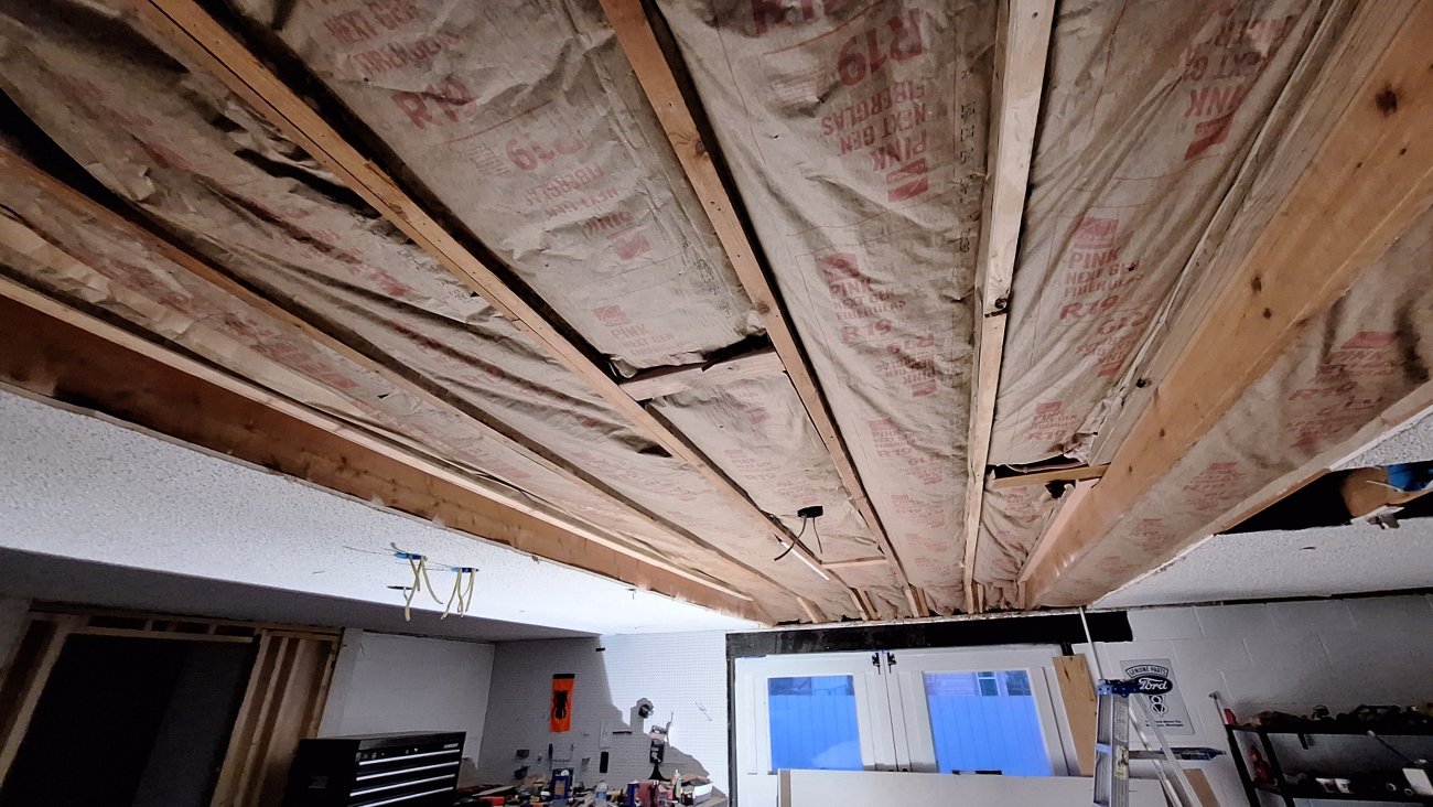

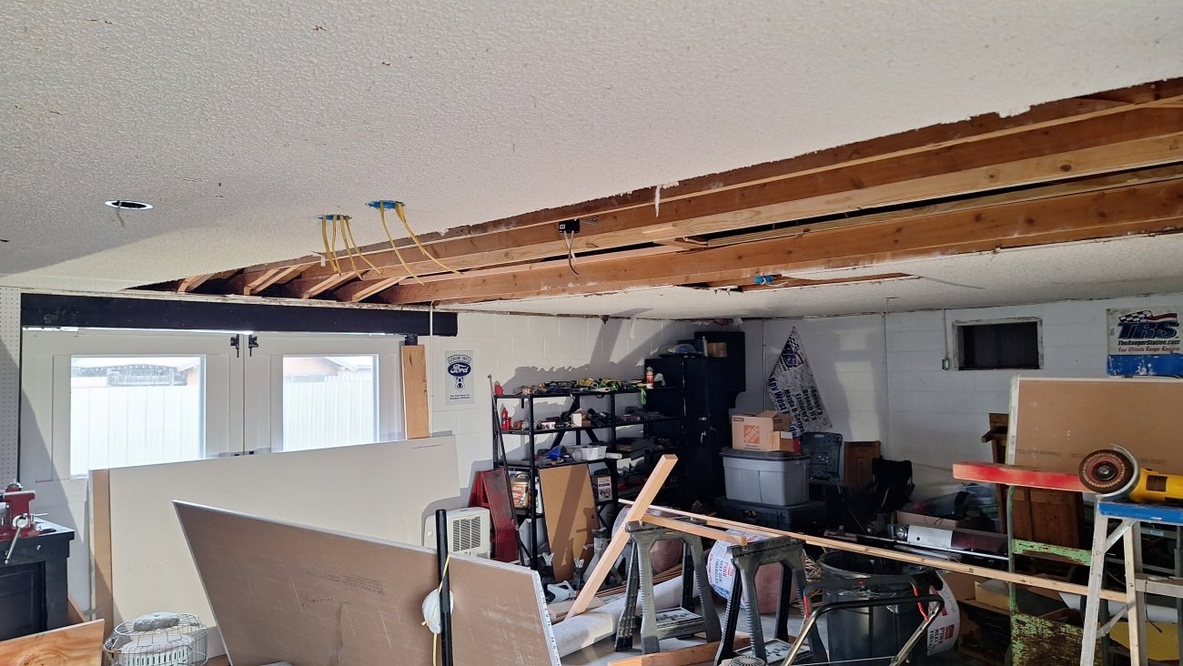

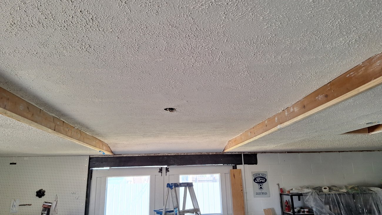

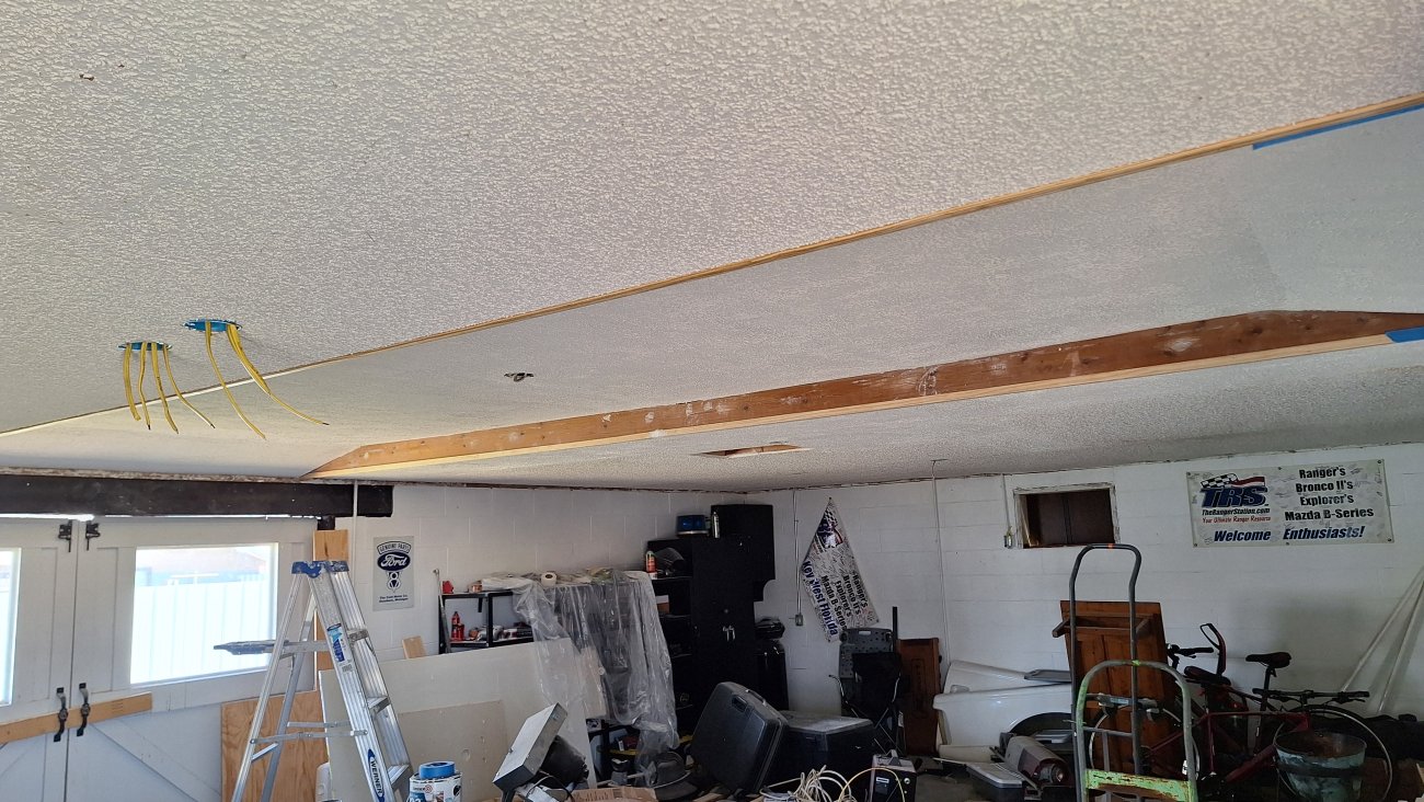

I actually had this area cleaned up and had built a Bronco II in here but never finished the ceiling. It got messed up when I moved all of the stuff from the middle room (above) to here so I could do that room.
I rewired this part of the shop and added some junction boxes. None of the old shop lights had been wired into a junction box, and I also needed to add (2) junction boxes with cover plates so I could access those connections without having to crawl across the attic. You can see them side by side in the pic below.
This I finally re-insulated it. As a reminder, I had moved the joists up in part of the ceiling, so I had more room to park my truck in here and put it up on jack stands.
Then I drywalled and textured the ceiling (it seemed easier to texture it to match the rest of the ceiling than to take down all of the texture and smooth out the ceiling.) I also primed and painted the sides of those joists and added corner trim to clean it up (not shown).
I left an opening to access the attic space to get to the (2) junction boxes that are up there. I still need to build a cover for it.
