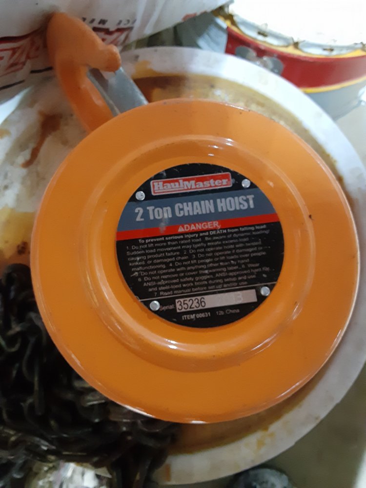

Probably cutting it pretty close with the weight rating there...
My bad...it's a 2 ton version - if that's what you meant by the weight rating.
