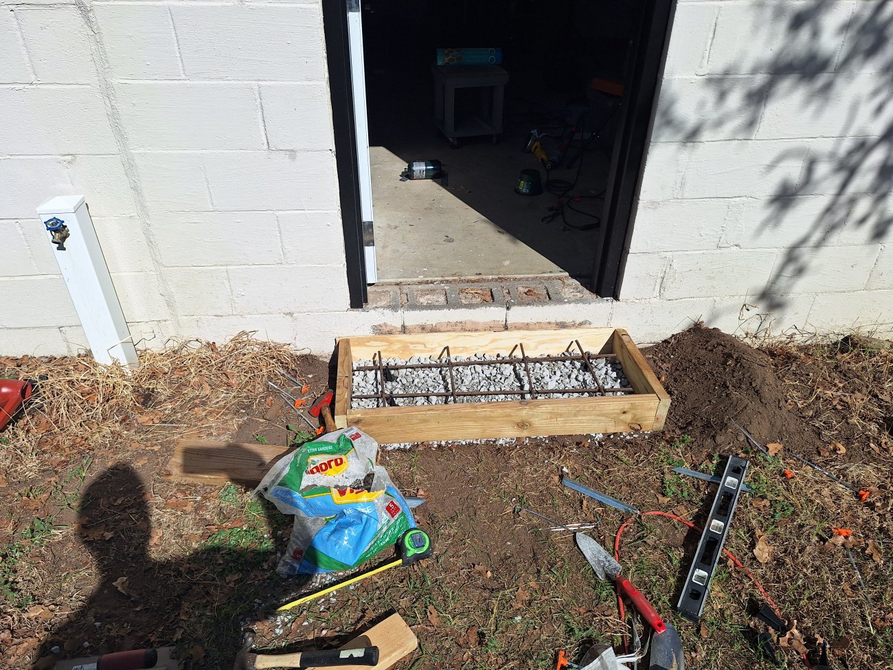

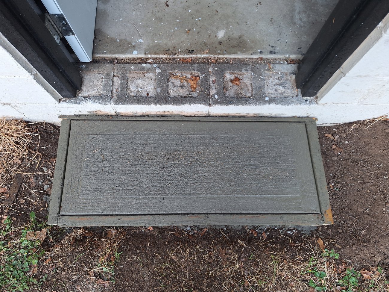

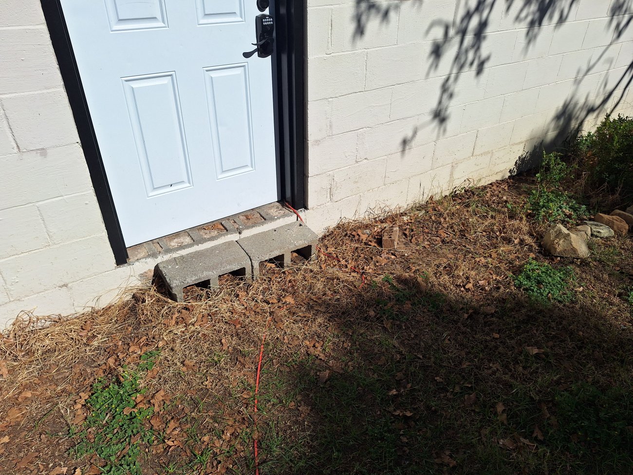

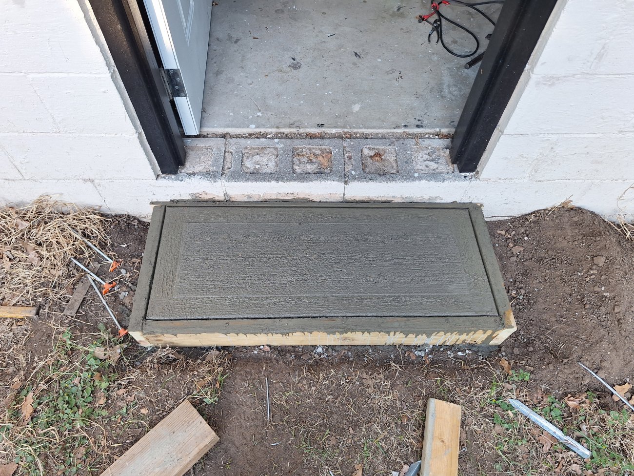

There's two cinder black that act as a step going into my shop. I've been saying for a long time that I was going to get rid of them for a concrete step / pad.
Today was finally that day.

Seriously though, I don't have that much rebar in my entire garage floor. Nicely done.

I got that rebar from the grassy alley behind the shop. It's been laying in the grass back there for as long as I've lived here. I swear the damn thing was like 12' long.
