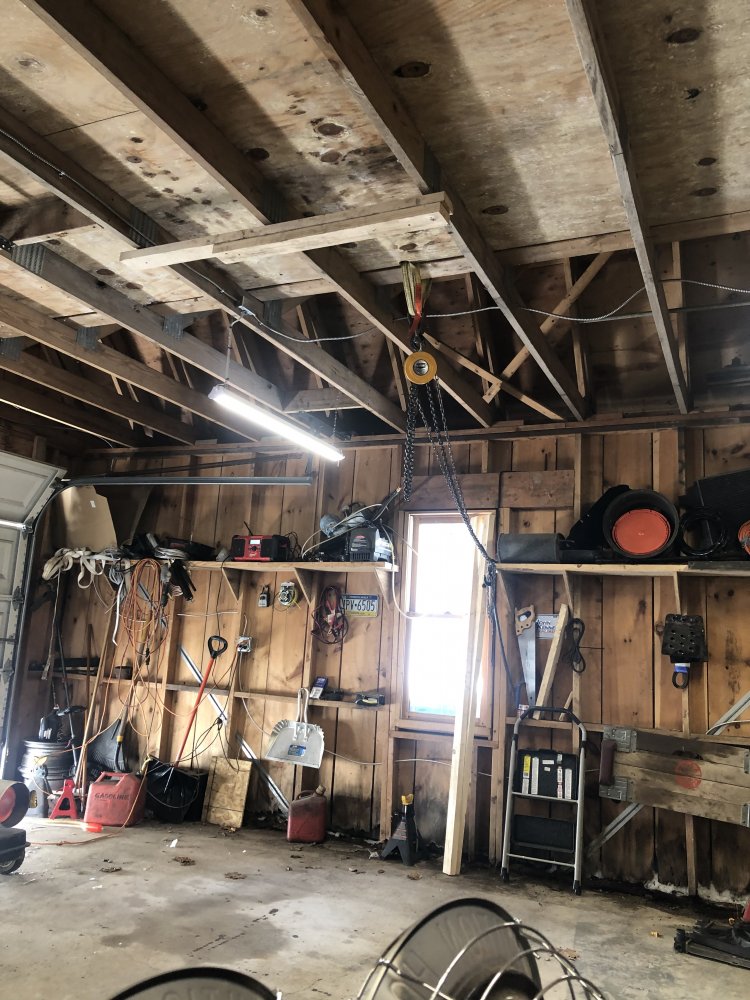

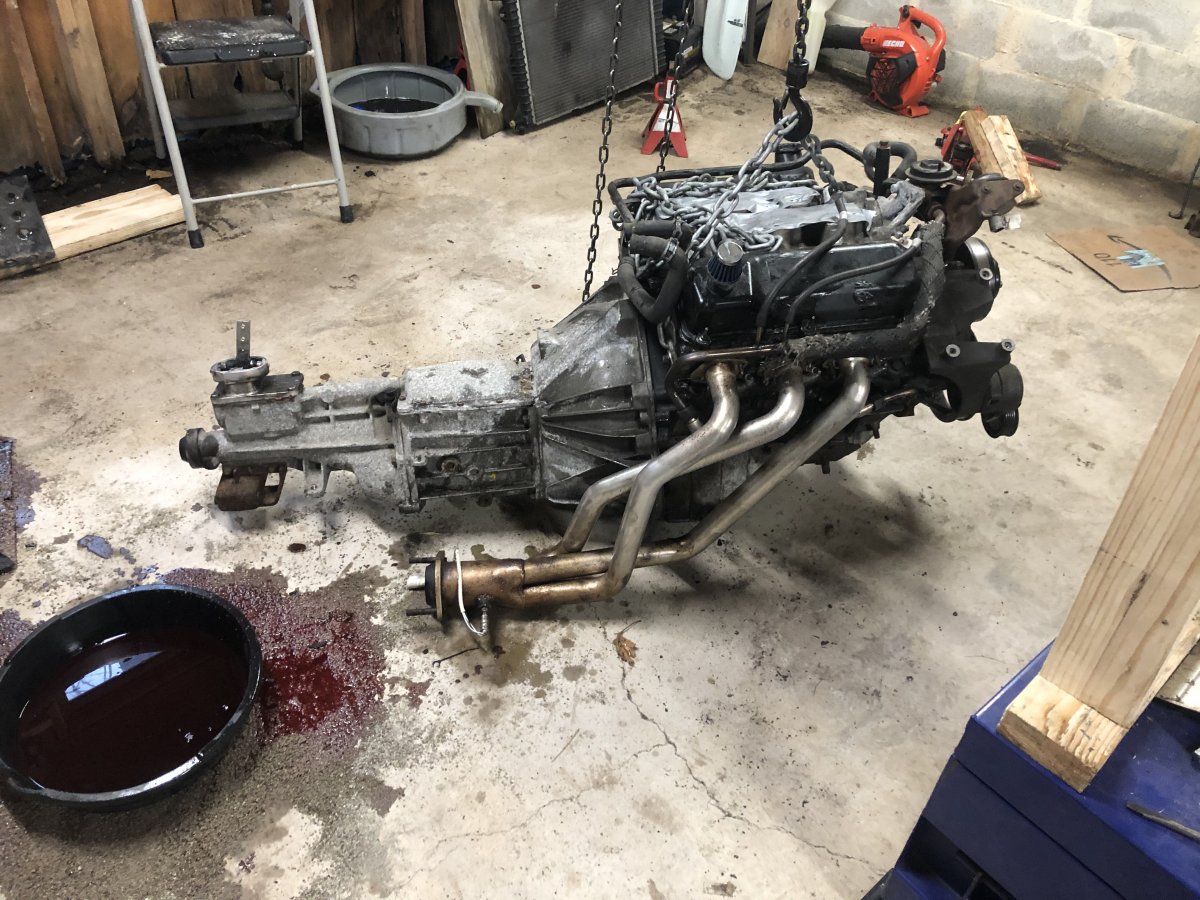

I don't have any good photos of the whole setup, but my engine hoist is a 1T chain fall strapped to a 4x4 laying across the rafters. Plus some 2x4s to help support the rafters in the center of the garage, since they do not go all the way across the garage.
I find it easier to push an empty car out from under my hoist, just open the door when your ready and slide it out, then to try and maneuver a cherry picker in a small garage without having the car hanging half way out the garage the whole time you are working on it. I would eventualy like to install an I beam so I can slide the hoist left to right like a small gantry crane.

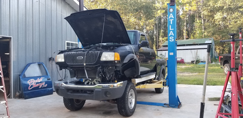

Our shop has the I-beam with a rolling chain hoist and a 2-post lift. The lift is only rated for 8k though. I wish it was a 10 or 12. We did have a bit of a scary moment with it trying to lift my '04 CC F-250 diesel. The concrete was still a little green and one post started to lean. It was a little stupid of us to try it before the concrete had cured enough, but we were also kinda testing its limits and were watching it closely. We figured if it could lift the 8k truck, it wouldn't have any problems with the normal stuff. We had to cut out the floor around the one post and repair it, but it's been great ever since.
Here's a pic of it lifting a lifeless form from its frame. We've since enclosed it so it's more comfortable to use in the Florida sun and rain. If you look on the right side of the pic, you can see the tall stands we use to stabilize the vehicle once it's lifted.

Ha! That's exactly the set-up I used to lift the hood off the ranger and put it back on. It's a 1,000 pounder from HF.
Probably cutting it pretty close with the weight rating there...
