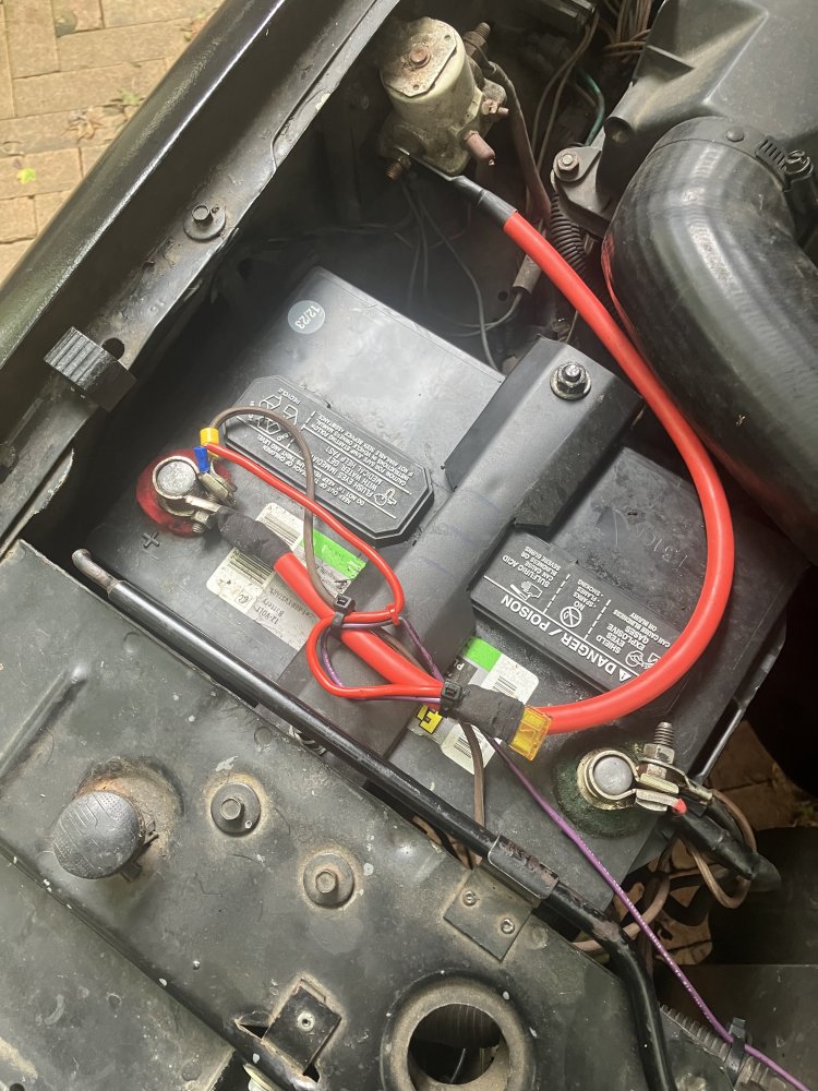

So I got in to move it out of the way for the F250. Turn the key, nothing. 😤
Almost brand new battery, dead as a door nail. So I got the smart battery charger, and when I was putting on the positive clamp, I heard a crackle and my strobe lights came on. I took a closer look, and the clamp had cracked. It’s one of those pressed sheet metal clamps, not the lead clamp. No big deal, I’ve got a box of cables and another box of clamps.
Once I started, I didn’t want it cobbled up, so I took a brandy new cable I had. I think I got it by accident and then they credited me, and I just made a new cable. I cut it the length I wanted. I cleaned up a pretty solid heavy duty clamp I had. I spread the wire out a little bit, and put soldering paste all over it. I crimped it over the wire. Then I dropped my mini butane torch and broke it…. 😤😤😤
I ordered a new little torch from eBay. I’ll solder it when it gets here. It never ends… 😤
so I ended the day where I thought I started…
