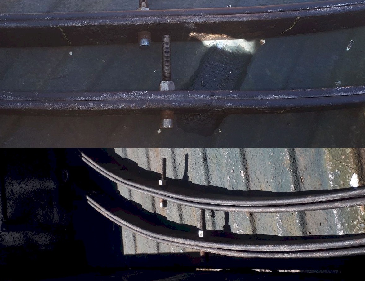

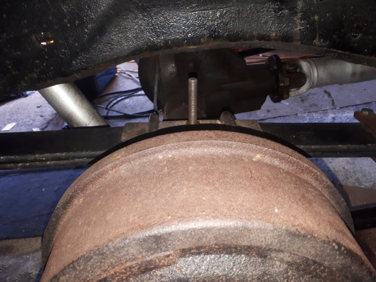

I have 5 bruises on both upper arms and chest in a 4½" bolt pattern LOL. Only way I could reach the U-bolts with the impact was to lean against the wheel studs. On the bright side I got my leafs re-arched - hopefully it will fix the ride height and bad pinion angle problems. Before(top pic) and after(below) comparison.
And this is what they looked like before with whole weight on axle stands - Pinion angle was +1.5° when it should be -4° and my rear shackles couldn't lean back any further.
That's a radical change in those leaf springs, good work.

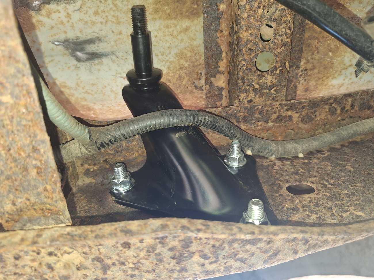

I recently replaced my leaf springs, rear shock mounts, and shocks in the past year or so on my 2000 Ranger.
It was a bear to get done but some of it wasn't too bad.

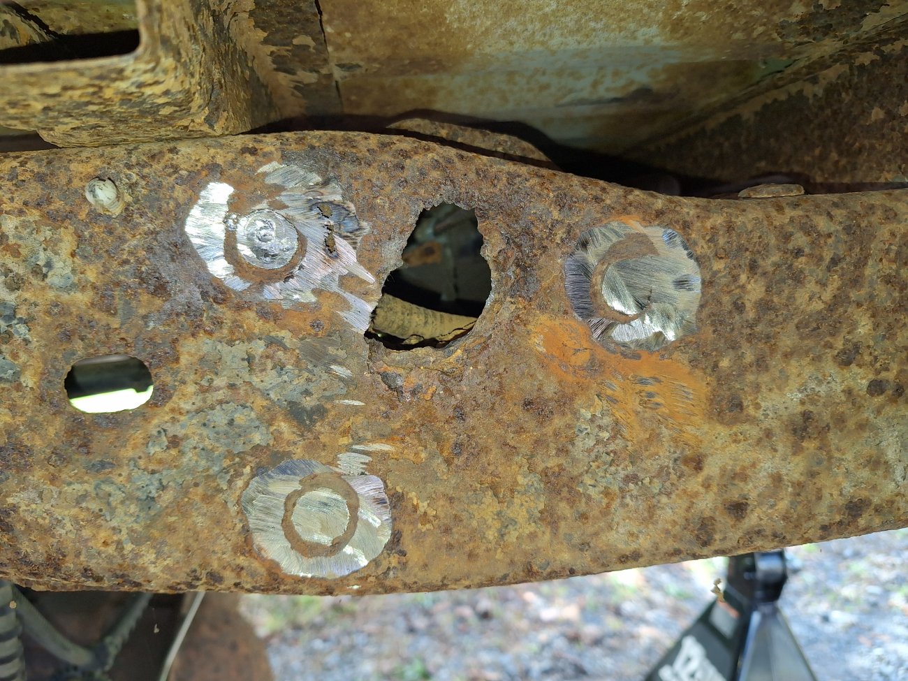

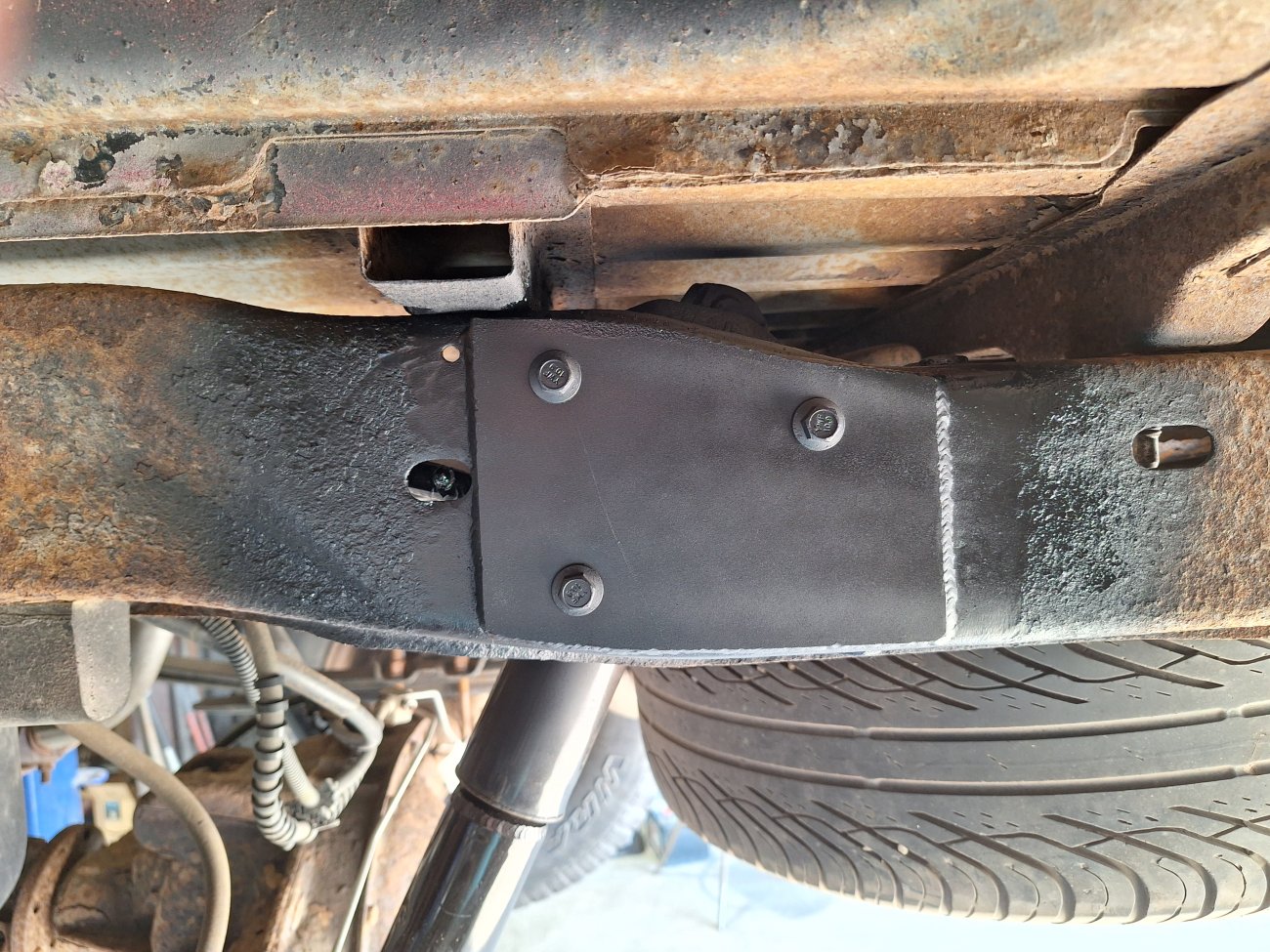

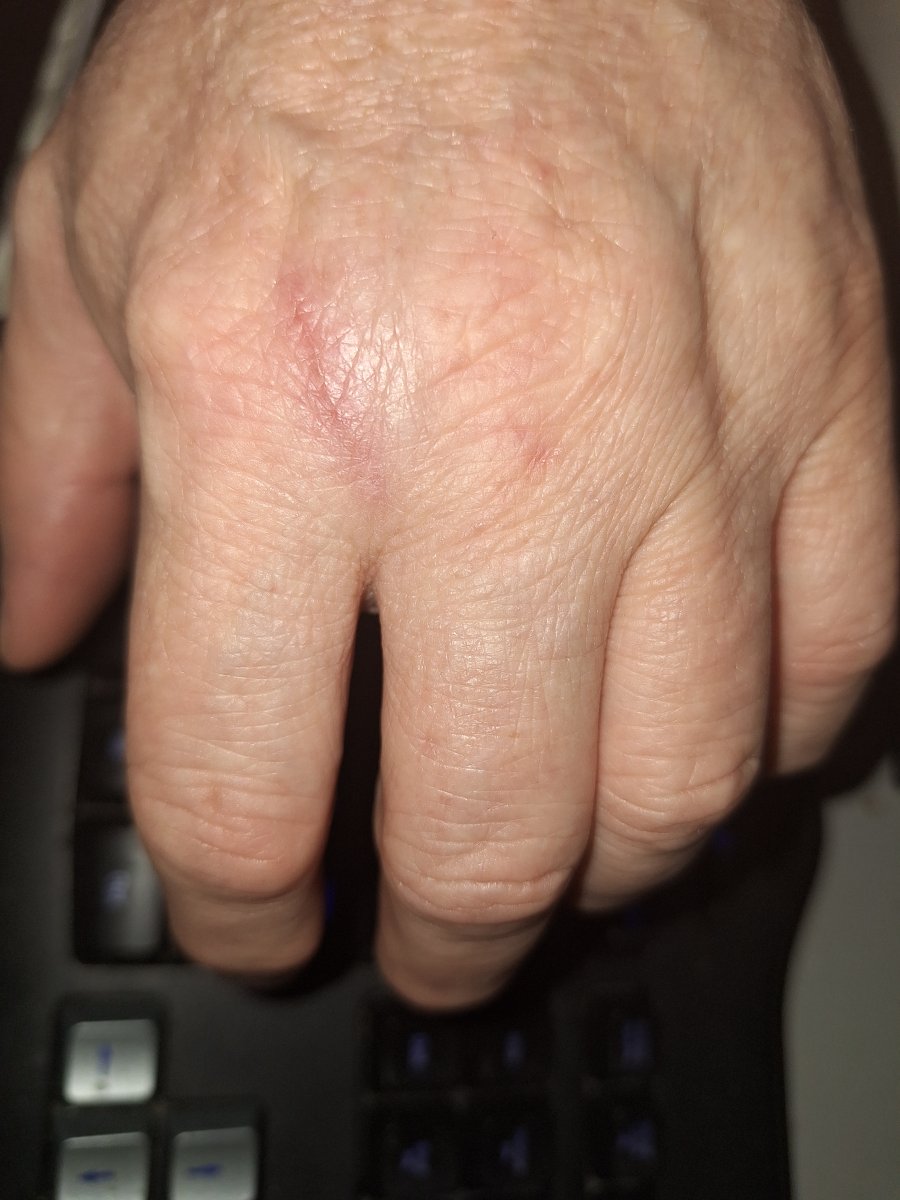

Although, while grinding off the rivet heads for the driver side shock mount that broke off right after I had replaced the shocks, I ended up taking a good chunk out of my left hand with my 4.5" grinder at full speed right between the index and middle fingers when my elbow slipped off the u-bolts I had it resting on. That was last year, it healed up but still hurts to this day. I never had it looked at, just squirted some iodine on it, grabbed a band aid and went back to grinding.
Then, when I got the grinding done and was pounding out the rivets a hole formed in the frame between the rivets the exact shape of the shock mount. As it turns out they're shaped like a cup, or vase, and fill up with moisture, rust, mud and dirt until the frame starts rotting.
I just had the hole patched last week for annual inspection. So both holes from that job are patched up now.

I where gloves when grinding. all that means is there will be shredded cloth in my cuts.
you're lucky by missing the tendons.
good work on the patch.:icon_thumby:
And that kind of thing is why I leave the shields on my grinders, most people hate them but I like my fingers... I mean it doesn't stop me from hitting myself with the grinder doing something dumb but it reduces the frequency... got a little grinder bite a couple weeks ago working on the boat grinding in a really awkward position...

I was wearing gloves, there's a permanent hole that matches my scar.
And the patch job was done by a local garage I go to. I don't have a welder and I doubt I could get one along with the consumables for what it cost me to have them do it.
They do good work and they're the only ones I trust around here. It's a small shop ran by a guy and his two sons. Sponenberg's Exhaust here in Berwick Pa.
They're great guys. The catch phrase on their cards is "No Muff Too Tough" since they do custom exhaust work but they also do most other repair work too.

In 30 odd years of welding I've either had or seen all kinds of grinder injuries, but your description is right up in the top 5 at least.
