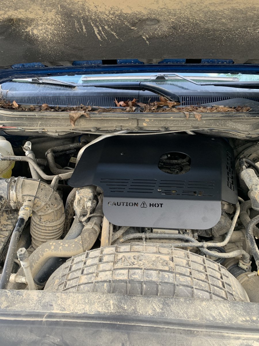

I installed the JCR Offroad engine cover I’ve had for way too long. It’s supposed to help with the water in the spark plug boot issue:

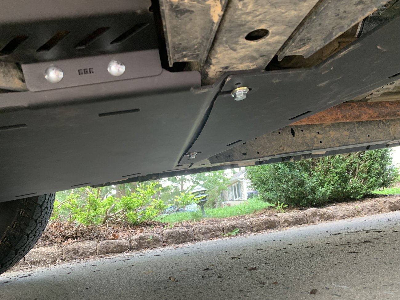

I also installed some more of the RCI full skid plate kit. I’ll finish that up tomorrow and post some pics.

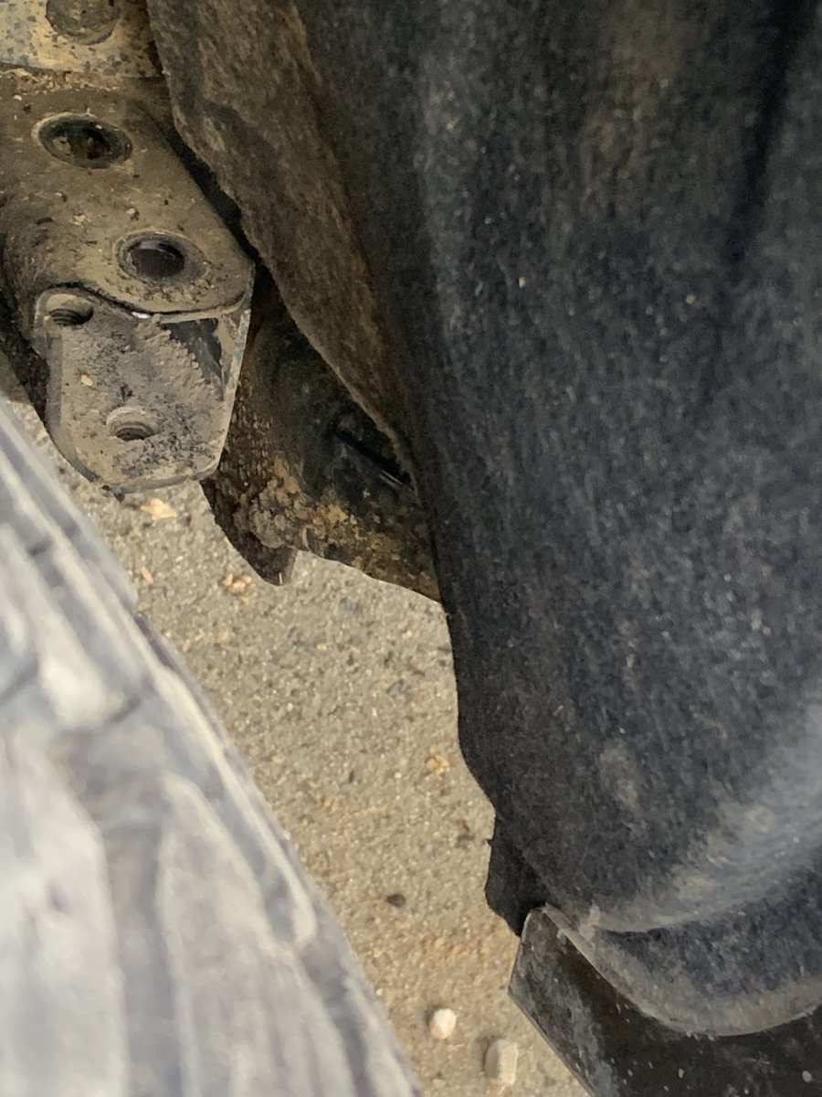

I removed the crash bars from behind the front tires. At the same time, I pulled the inner fender liner and removed the plastic panel from behind it. It trimmed about 1” out of the thickness and reinstalled it. I had to drill a few holes to zip tie the fender liner at the bottom, but it gave me a good amount of extra clearance for when I go to bigger tires.

I already removed the front ones when I installed the TJM bumper. I don’t know why everyone talks about having to cut them to remove either the front or rear. If you take everything out of the, they just come right out.

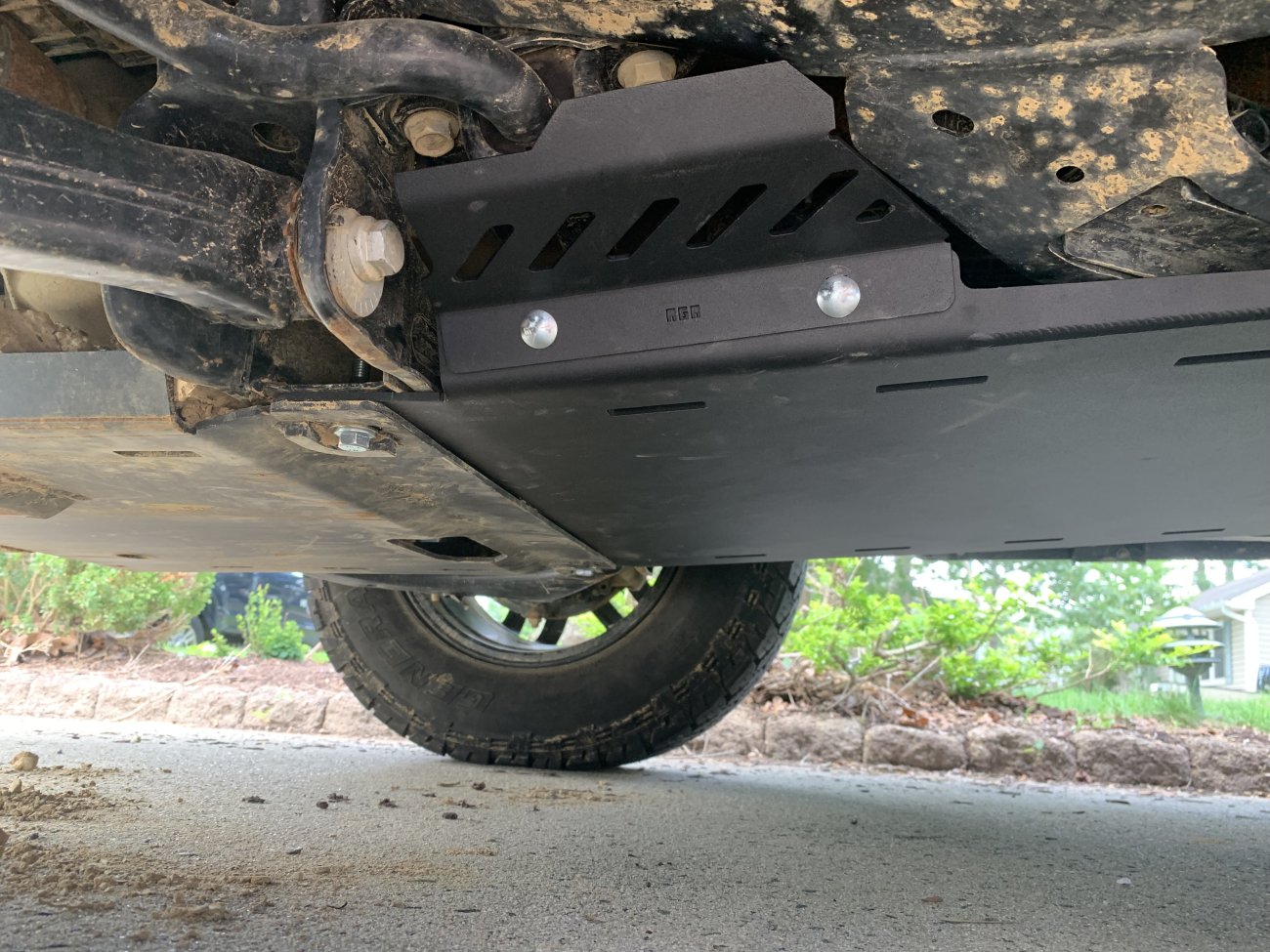

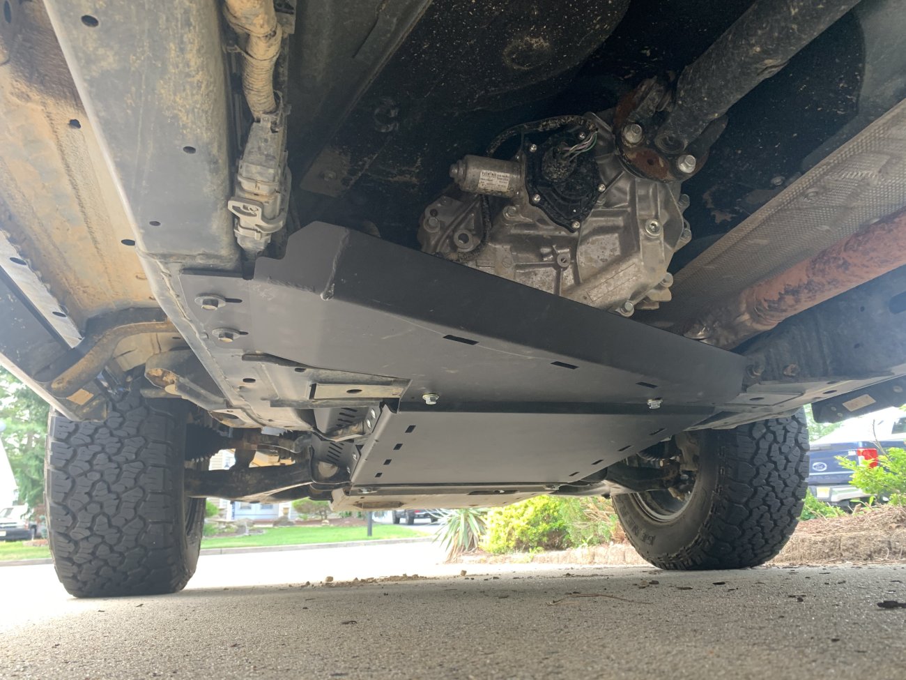

But before I did all that, I finished up the skid plate set install. I added the trans, transfer case, and “catalytic converter protectors”. (They’re supposed to make it harder to steal the cats.)

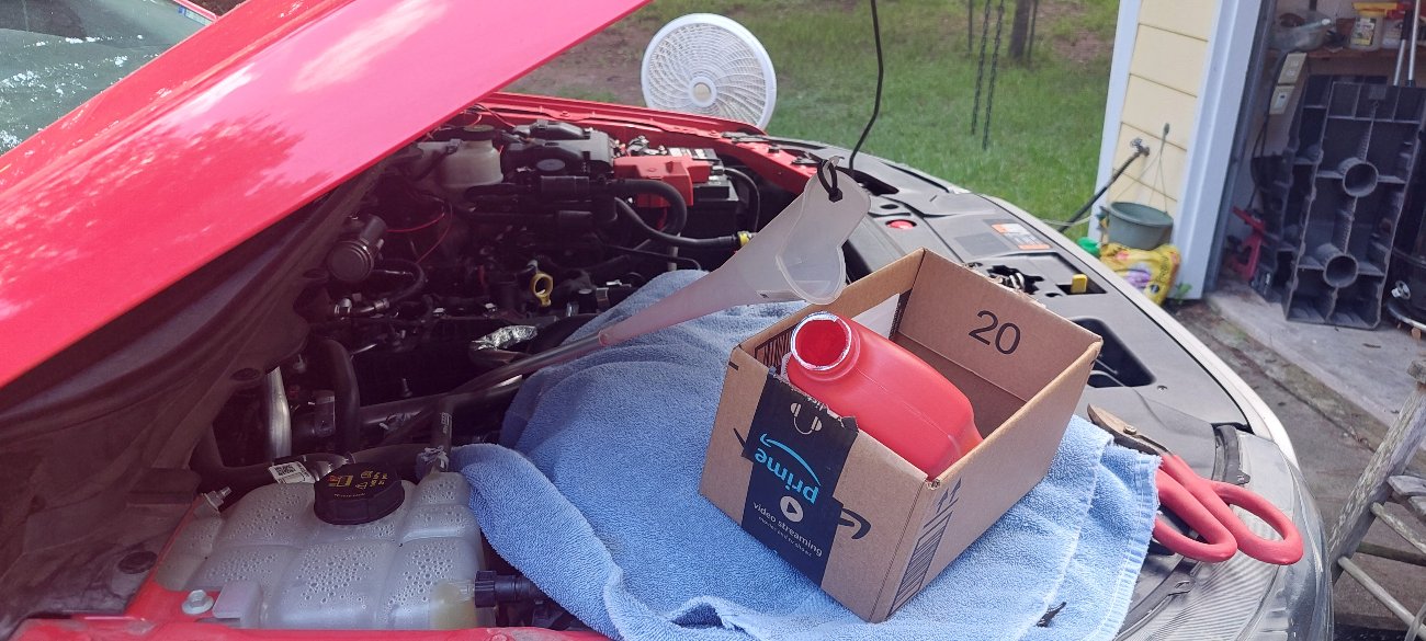

Transmission service and new PPE transmission pan.
A few points in case anyone else is doing this:

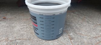

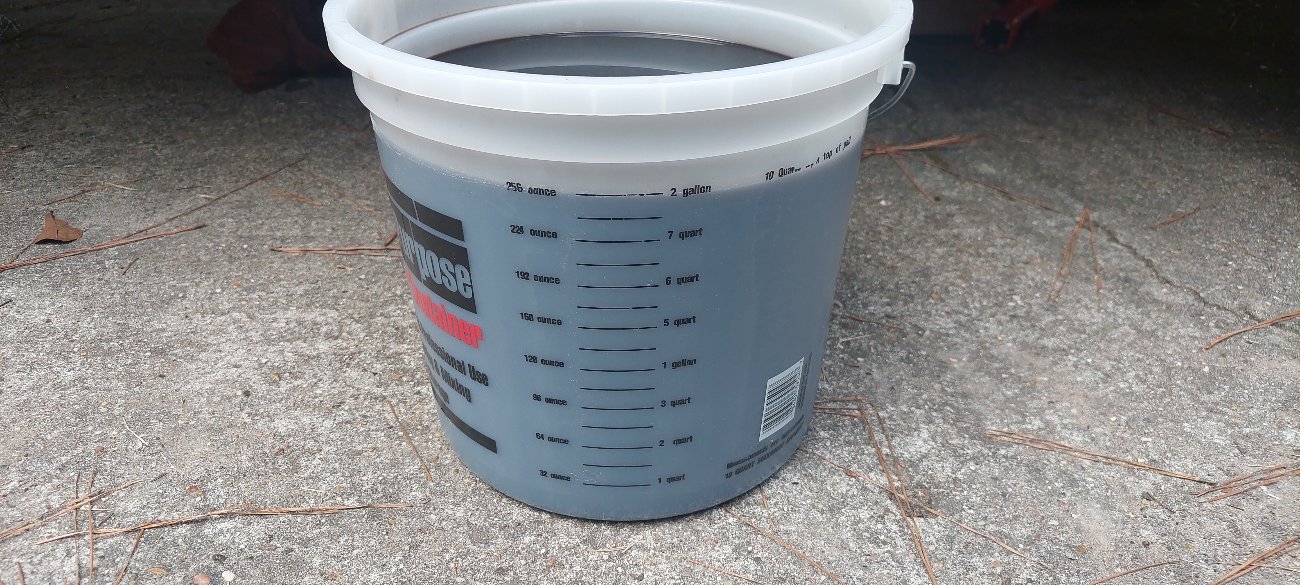

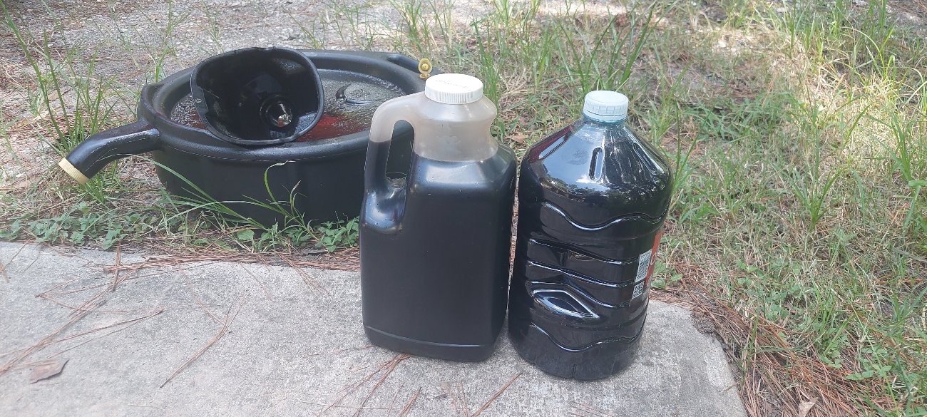

1) If you're going to trash the OEM pan and replace with an aftermarket pan, don't drop the OEM pan by pulling the bolts (it's a mess) - drill a small hole in the bottom and let it drain overnight. Worked great. I got a full 8 quarts out of it. I used a bucket with measurement lines to measure it. See pic below.

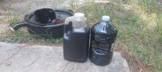

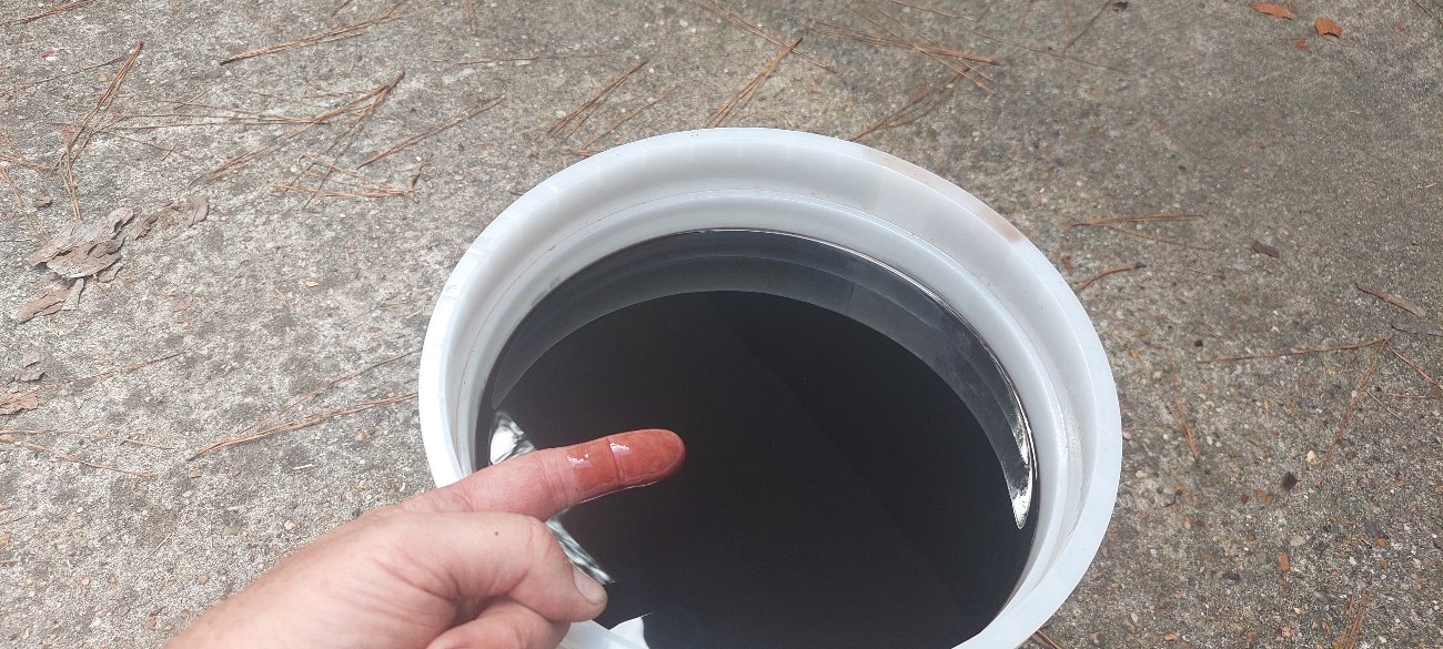

2) Considering that Ford recommends a tranny service and 150K, I was surprised at how dark the fluid was at 65K on my truck. See pics below. From this point on, I will drain and refill every 35-40K.
3) I filled the tranny from the engine bay with a 1/2" OD clear tube with a funnel attached. Very easy.
4) Getting to the tranny dipstick cover fitting is a b!tch. Need to do this on a cold truck otherwise you're going to fry your arm on the CAT.

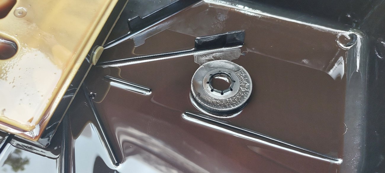

5) I had the normal amount of powder-sized metal particles on the OEM pan magnet. The PPE does also have a magnet
The PPE pan is of exceptional quality. Great fit and I like the heavy gauge heat dissipation fins.

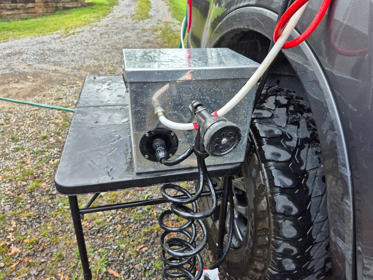

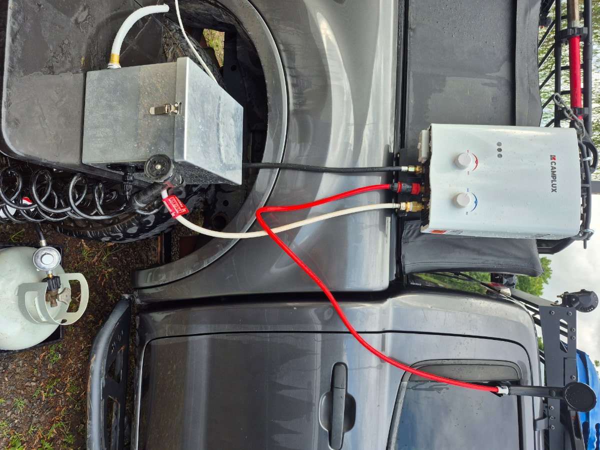

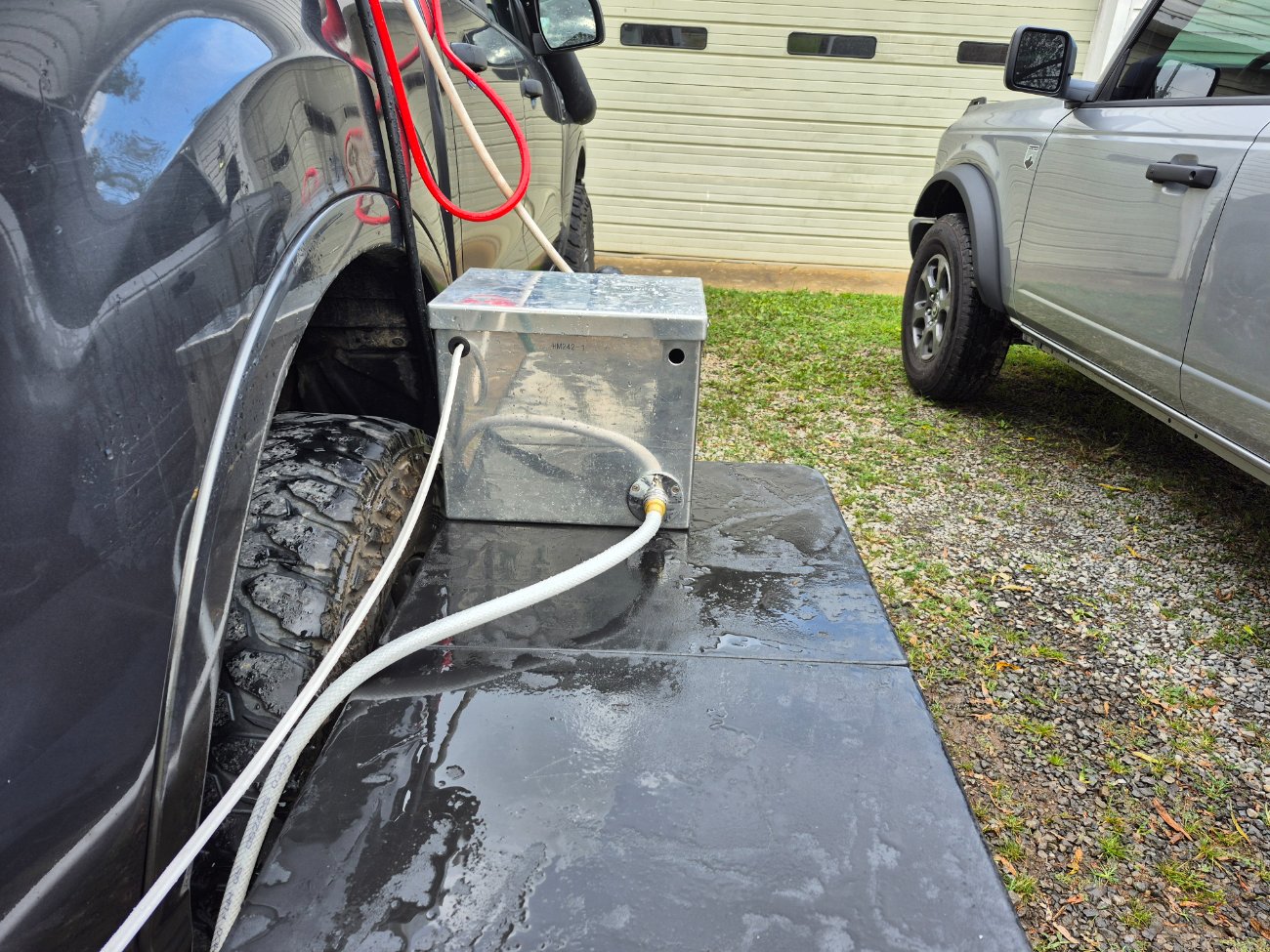

I did at little bench testing on my DIY pump box. Worked pretty well. Go a small leak on the water heater input I need to address. Be sides that it turned out to be a successful test. Now to figure out how to incorporate it into the 5ft bed haha
