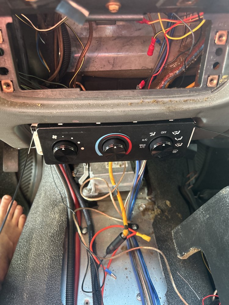

Switched out the dated plastic nibs for a set of aluminum universal ones meant for guitar/music amps on Amazon. Wish I had a 3D printer to of just made nicer ones though

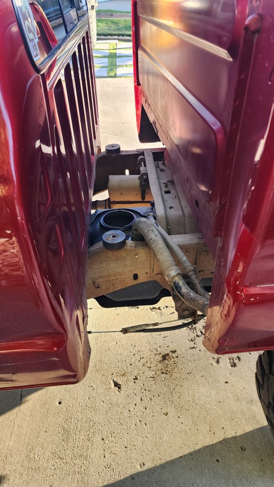

I was driving down the road the other day when I felt a couple quick surges and the engine quit. It would start up and immediately die. I checked all the connections but could not get it to stay running. After a tow home and a fuel filter change, I checked the fuel pressure and noticed how little there was. I guessed it was time to put in a new pump. Thankfully, Youtube reminded me that I just have to move the bed back a little to access the tank.

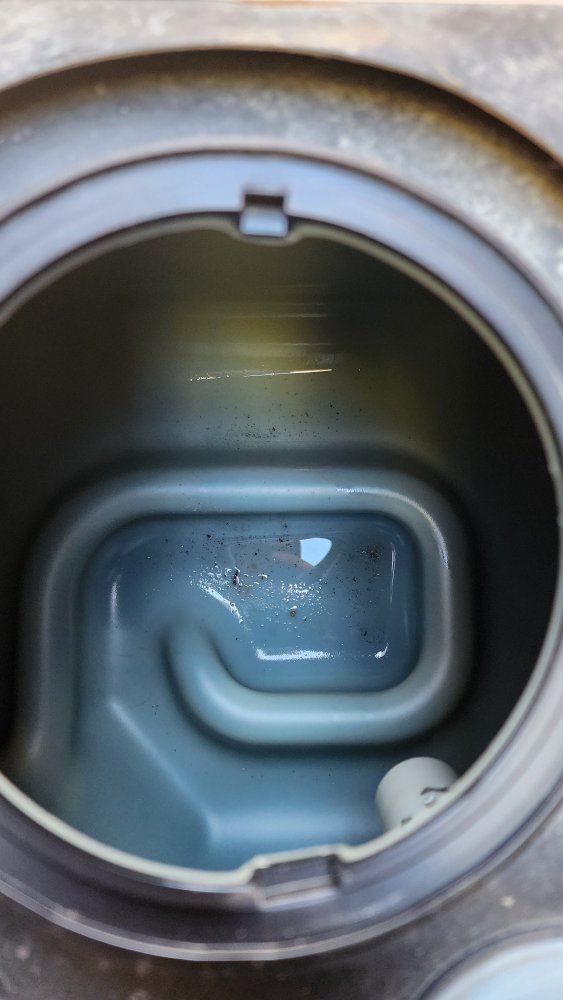

The ring came off and the pump out without issue. I looked in the tank and was relieved to see only a little debris. However, that is when I noticed another issue. Tell me if you can see the problem. 🤦‍♂️

Looks like a hole in the tank...
Also looks like I can see daylight through a scrap
I'm not seeing the hole, but the daylight looks like a reflection to me.
I'm assuming that he thought there was a bunch more gas. IMO dropping an empty tank would have been easier than moving the bed. That would probably point to a bad/inaccurate fuel level sender.
