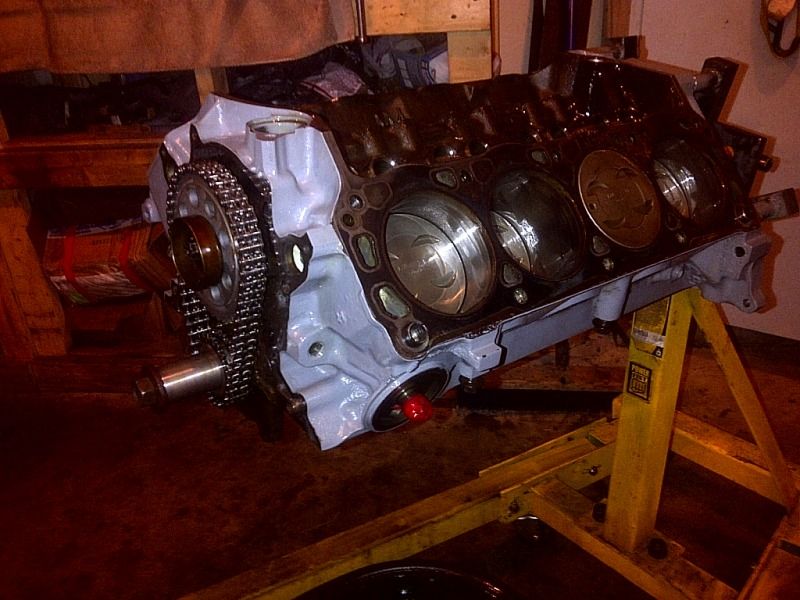

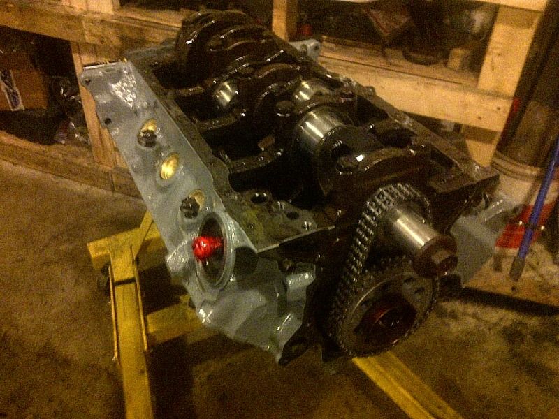

New cam bearings in, new freeze plugs in. Got block, main caps, crank, cam all nice and clean. Checked tolerances with plasti-gage, all is within spec. Installed cam, crank, and timing set. Spins really smooth.
Rangebe...version 2.0
Shortblock. waiting on my Ford Racing oil pan to show up from summit.
:icon_surprised:
looks like you've gained an extra 4 cylinders since the last time I checked this thread.
Badass!:icon_cheers:
New oil pump and Ford Racing oil pan and pickup. Rebuilt the heads, and gave them a mild port job as well as lower intake.
