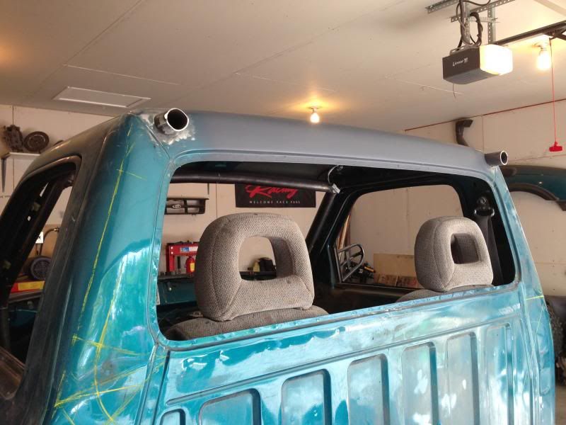

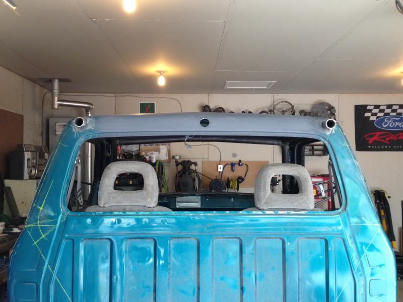

This picture may not seem like much, but it was a fair amount of work. There was a 3rd brake light in the middle of the back of the cab, but it was covered by the cage main hoop. I needed to pass a tube through there to connect to the cage, so I made a filler piece, welded it in, and did the body work.

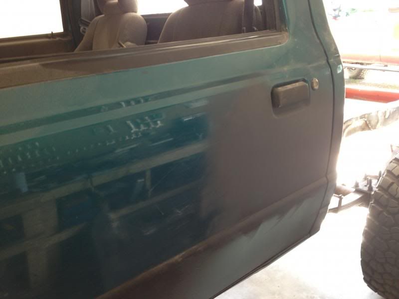

Fixed some dents in the driver door
And did the final body work on the shaved antenna hole

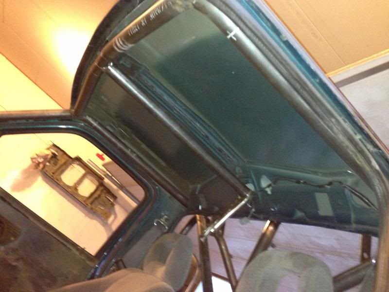

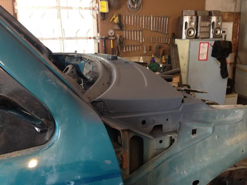

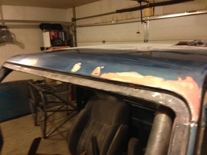

Did some more rust repair around the windshield, this is before I primed it.

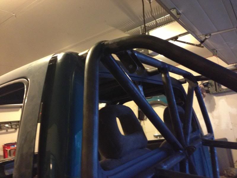

Cut another hole through the middle of the cab
Middle tube
And it all 3 tubes go through the cab into the main hoop

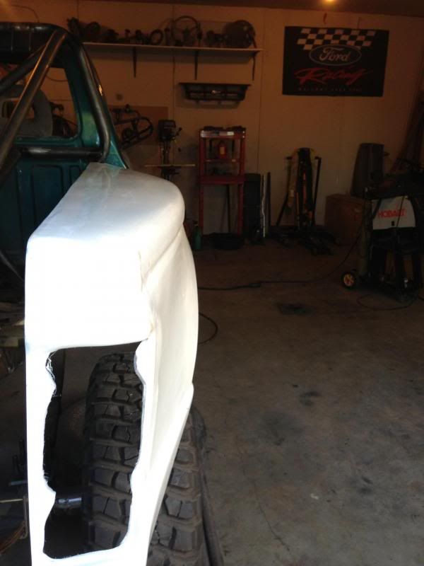

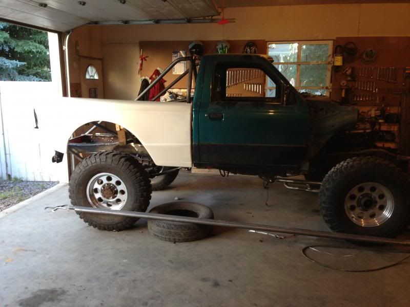

Small update, got my McNeil 6" bulge fibreglass bedsides. Just threw them up on the truck to see how they'd look. Rear is sitting high right now because the spare/fuel cell/batteries aren't in.

Those fenders look sick. Did you see the fiberglass Raptor conversion for the Ranger?
