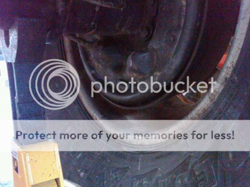

Oh, figured Id take a pic and show something I forgot to add.
Ruffstuff 3/8" u-bolt plates, and 5/8" u-bolts...this also shows the leaf pack I had made and tweaked ages ago, 5 leaves and an overload, and they flex quite well.
