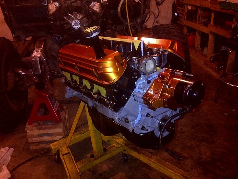

Engine is coming together....

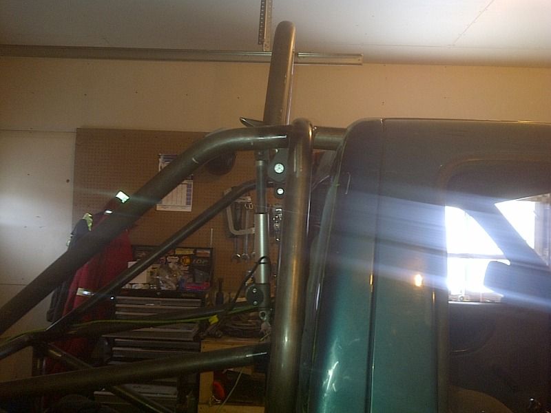

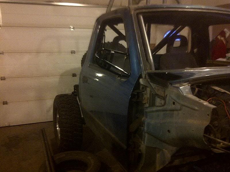

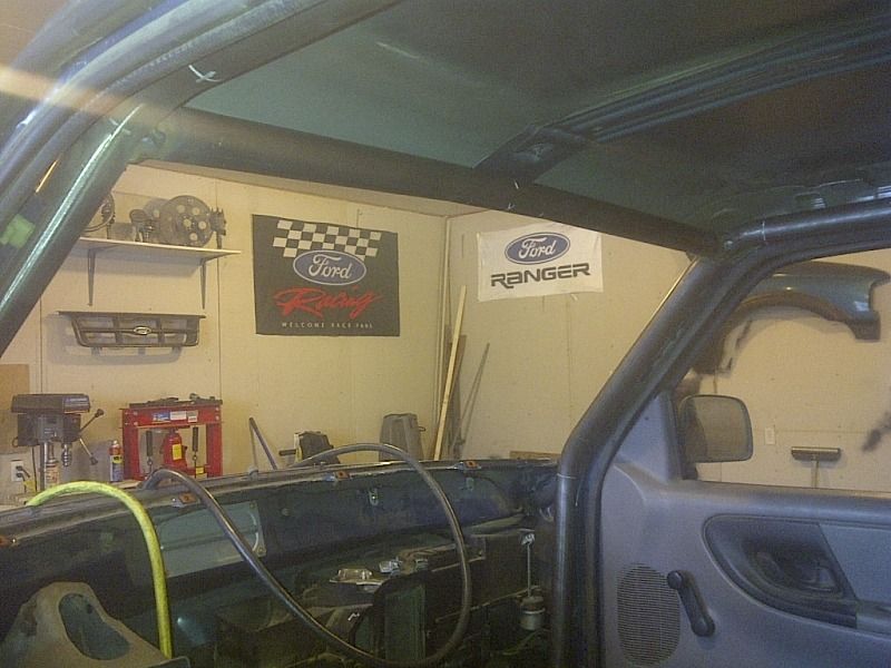

Worked more on the cage. Got the passenger side pillar bent up and in place, new body mount made and everything installed. Also got the A-pillar cross bar in place. Need to do the roof cross members next, then dash bar and engine cage.
