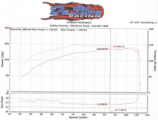

In general, lower RPM typically does mean better fuel economy, but with our trucks and their tuning I've found that below 2500-2750 these trucks are tuned really poorly and dump fuel.
Based on this graph from Da Silva racing from a long time ago, on a mostly stock 3.0. As well as my own driving with a basic OBD2 scanner monitoring fuel volume. This graph is old, and I had to find a lot of the information about the vehicle by reading forum posts, but it's a 3.0 manual, with an indeterminate axle ratio, but combined with other graphs made for the 3.0 vulcan, it shows the fuel mixture leaning out around 2750-3000 just before/during the peak power band.
Generally speaking however I get my best results keeping the truck as low as possible within the given range of 2500-3000 RPM.
Out of the two options you listed, 2200 RPM is probably more efficient, but there's so many other variables you'll get a better answer from doing some fuel economy testing yourself.
If speeding isn't a concern for you, by going a few MpH faster you might actually see some improvement in fuel economy by raising your rpm to the lower side of that range.
actually, that graph says more fuel per unit of air is being used above 68 mph.
Ah shit you're absolutely right, that's the stoichiometric ratio. Thanks for letting me know so I can stop using that graph when I talk about fuel economy lol.
I know that on my handheld scanner I was getting less fuel volume at cruise between 2500-3000, compared to 1800-2500ish, I'm imagining a dyno-pull isn't going to give you an efficiency focused fuel curve.
I really need to just get something to log average fuel economy.
