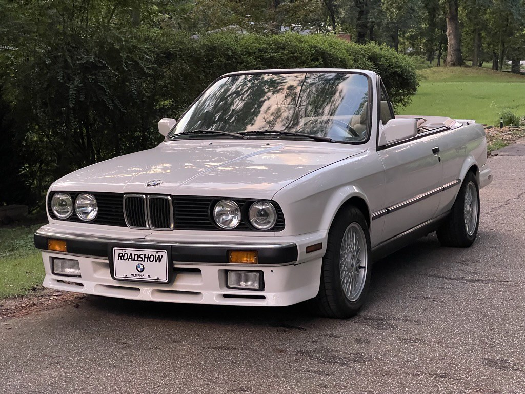

This is the factory ones we put on our bmws

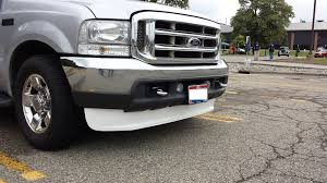

Definitely not going with a scoop of sorts, something closer to what's being used on a lot of modern trucks like this:
But in reality it's probably going to look something a bit more like this, but probably not as long/ugly... I hope:

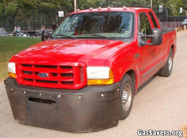

Both of those, you can make with the black garden edging (garden trim)
