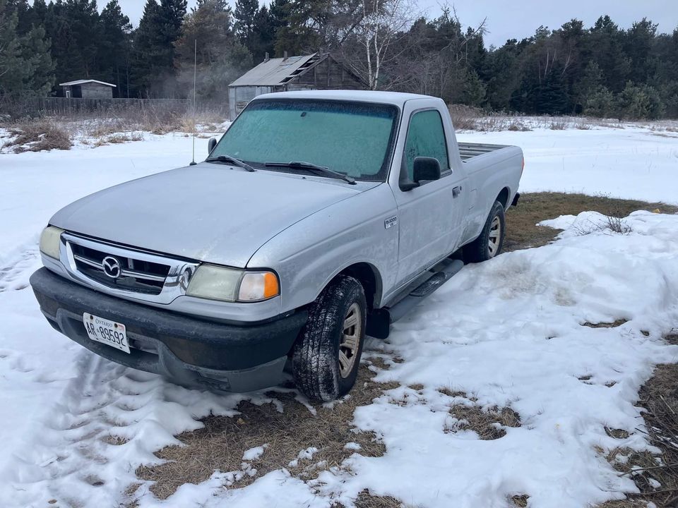

Howdy folks!
I’ve always been frustrated by just how many people drive gigantic vehicles, mainly trucks, that are beyond their means, and beyond their needs. Massive road couches that ruin our pavement, injure pedestrians, and generally cost more than their worth in financing, and at the pump. But these days, I DO in fact need a truck, or at least, a vehicle with some amount of utility. So I’ve purchased the most REASONABLE truck you can ask for, a Ford Ranger, well, Mazda’s version anyways. Let me introduce you to MAB3L! (get it, Mazda, B-Series, 3 Litre!)
The goal of this thread is to help me document, receive advice, and provide guidance and documentation to folks undertaking some of the pretty classic 98-11 Ford Ranger mods, as well as some more strange ones.
The specs:
-2003 Mazda B3000, Dual Sport
-3.0 Vulcan V6, Automatic Transmission
-Standard Cab, Standard Bed
-RWD
-Limited Slip, 3.73 7.5 inch rear axle (F6)
-Despite the door sticker, it's actually Limited Slip, 4.10 7.5 inch rear axle
MAB3L was a pretty good deal, she’s been living the last 8 years on a farm, doing a weekly run to dump garbage. Prior to that, we’re not sure. I bought her at 76 600KMs for 2600$ CAD in early 2024. It's spent pretty much its entire life running garbage to the dump on a farm.
A screaming deal if you ask me, but here’s the caveat. It was in an accident, and deployed its airbags. Still, for Northern Ontario no rust is best, and this truck has very VERY little, and for the most part was put back together quite well. Evidence by the not original steering wheel airbag, the beeping on startup (and quietly every 30 minutes after), and the fact that one fender says B4000.
So what’s the goal with this build? Reasonableness, to the point of being absolutely unreasonable. Given the low miles, and substantial life left in much of the truck, I’m looking to make this little truck the most cost effective utility vehicle for regular truck tasks, commuting, but more importantly long distance cross country road trips. So what we’re looking for in roughly this order is: fuel economy, low cost of operation, comfort, and utility.
There will be no lifts, big tires, drivetrain swaps, 4WD conversions, v8s, or, god forbid! Forced induction.
What we will be looking at however goes from the mundane radio swap and tune ups, all the way to electric power steering conversions, lowering, and maybe even an alternator delete if we’re feeling freaky.
I’ll be providing some updates on fuel economy, overall performance characteristics, and costs as we go to help other folks decide what’s right for their trucks.
Here’s what’s been done so far:
  • Reasonable Winter Tire selection, 215/70R15 Blizzak WS80s on Stock Wheels (Feb 2024)
  • Android Head Unit Installation (Feb 2024)
  • 12V Power port on/off switch (I didn’t like how the port stayed powered the whole time, Feb 2024)
  • 12V cigarette lighter port reinstall? (There was a blank in the space it was supposed to go, and when the radio unit was removed, I found the wired plug and cigarette lighter itself simply sitting behind the unit.)
  • Used Truck Cap (March 2024)
  • Custom license plate! (March 2024)
  • New Key, cut and then programmed via Forscan (March 2024)
  • Remote Power Lock Installation (40$ CAD kit from Amazon) (March 24th, 2024)
  • Mazda OEM Tri-Spoke Alloy Wheels with 205/70R16 Firestone Destination LE3 Tires (April 3rd, 2024)
  • Deleted side steps, trailer hitch. (April, 2024)
  • First oil change, installed oil drain valve. (April 11th, 2024)
  • NGK Iridium IX Spark Plugs gapped to 0.065 (April 13th, 2024)
  • 10.5MM JDMSpeed Spark Wires (April 13th, 2024)
  • MSD Street Fire 5229 Ignition Coil (April 15th, 2024)
  • 2.3L Ranger E-Fan and shroud + Thermostat kit install, clutch fan removal (April 27th, 2024)
Here’s what’s on the docket for upcoming repairs/mods in 2024, in no particular , definitely not going to get to ALL of these:
  • New Key, cut and then programmed via Forscan.
  • New Air Bags, RCM, and dash cluster installation, including Odometer swap
  • Summer Wheel and tire installation
  • Summer weight reduction, uninstall side steps, trailer hitch.
  • Drivetrain tune up, Engine oil and Trans fluid change, spark plugs e.t.c
  • Electric Fan conversion
  • Anti-theft Kill Switch
  • Cruise Control retrofit
  • Redneck Aero Package Stage 1: Front Air Dam, partial grill blocks, Cab to Cap smoothing. (thanks garden edging!)
  • Rear Traction Bars.
Bigger/more costly Modifications:
  • Low Rolling Resistance thinner tires: 205/70r16 or 215/70r16
  • Potential swap to 3.45 or 3.55 LSD axle for lower revs at higher speeds.
  • Rear Disk Brake Conversion, SN95 Mustang calipers/disks
  • Overall Lowering, 3-4 inch drop all around.
  • Interior overhaul, sound insulation, new seats.
  • Custom intake and exhaust, (maybe new headers if the current ones aren’t so crusty and awful that I can’t take em off)
  • Redneck Aero Package Stage 2: full front end undertray, partial rear undertray.
  • Lithium Ion Car battery
  • Electric Power Steering conversion, power steering pump delete.
  • Electric Air conditioning Compressor installation, compressor delete.
  • Electric engine water pump conversion, total belt driven accessory delete.
  • Alternator Delete, with supporting wiring and fuse overhaul, charging port installation, potential dual lithium battery setup.
  • Solar Panel installation for charging accessories, camp utilities, and vehicle’s batteries.
  • okay if you read this far maybe I will actually go insane and do a 3.0 SHO swap and document it for posterity
I'll be happy to take advice on any or all of these mods, and I'll do my best to keep you folks updated along the way.
Here's a little bit about the first long distance haul:
1136 KM March 16th-17th, 2024:
This weekend we went down to the city to pick up some furniture, some sweet OEM 16 inch Mazda B4000 wheels (and some old, surprisingly massive 255 width tires), and a family event. The trip totalled 11 hours of travel, and approximately 1100 KMs of highway driving.
Overall the truck performed very well, comfortable, controlled, and surprisingly efficient!
With some slowdowns, the average speed was just over 110 KpH.
Observations:
-The trip down was done with effectively an empty bed, and a bit slower, with a passenger weight of approximately 400lbs. We achieved a truly surprising 10.2l/100Km (Nearly 23 MPG),
-The Return Trip was done with an additional 400ish lbs of weight in the bed, and at higher speed overall. The truck still impressed by achieving 11.19l/100Km (21 MPG). This was impressive considering a majority of the journey was done above 115KpH, with one and a half hour stretch at a little over 140 KpH (approx 87 MPH). This also included WOT passes and accelerations, and on the flip side, some neutral coasting.
-The truck settles in well with the bed cap over 100 KpH compared to without, sitting just under 2500 RPM, handling uneven pavement quite well. Under that speed however, we see some lateral movement that can be frankly scary.
-Above 120 KpH, there's significant wind noise coming from the driver’s door seal, and some from the passenger side. At that speed the door is clearly being pulled open slightly, resulting in some truly grating high pitched wind noise. It was helped partially by slamming the door after stopping, but that only raised the threshold before the sound reappeared.
-Wind conditions affect the trucks ability to track straight, the thing is basically a brick on wheels so this is expected, hopefully some basic aero and lowering will help the truck track better in high wind conditions.
-We encountered some inclement weather, the temperature was just above freezing but we still saw hail, snow, and some rain. The 215/70R15 Blizzak WS80s performed really well, traction was solid even at high speed.
-The truck is clearly limited to a top speed of approximately 145 KPH, I’m assuming the limit is actually 90 MPH, it seems that the limit is a fuel cut off based on how the engine clearly bogs at that speed. Annoying, but frankly reasonable considering after all, it’s a truck.
Overall Mab3l is doing great! Excited to see improvements!
