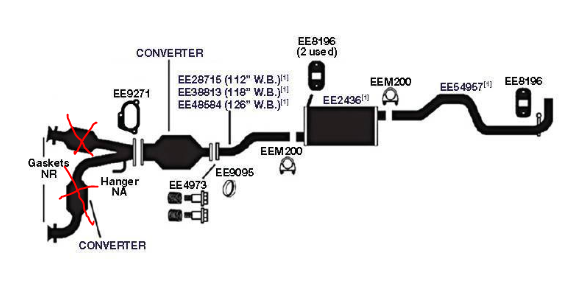

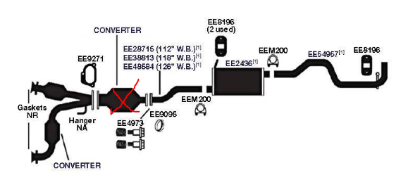

I'll most likely have to fab that y pipe+CAT setup though if I want to reduce backpressure over stock, I haven't found too many premade ones online.
You're definitely right that either the front Y cats, or the rear cat could be clogged, or restricted and changing them could improve all the things above. I'll most likely have to fab the CAT sections if I want to reduce backpressure compared to stock, I haven't found too many flow cats for these trucks yet.

check for parts availability, the Y pipe for a 2000 3.0 without cats is no longer in stock anywhere.
and when you break the seal between the Y pipe and the main cat rust 'n deterioration will
probably prevent it from being reassembled.

getting back to the original issue of manipulating the exhaust system.....
If I couldn't find the Y pipe my idea was to scavenge the flanges, or new ones if they're too crusty and weld them up to a couple small cats instead.
