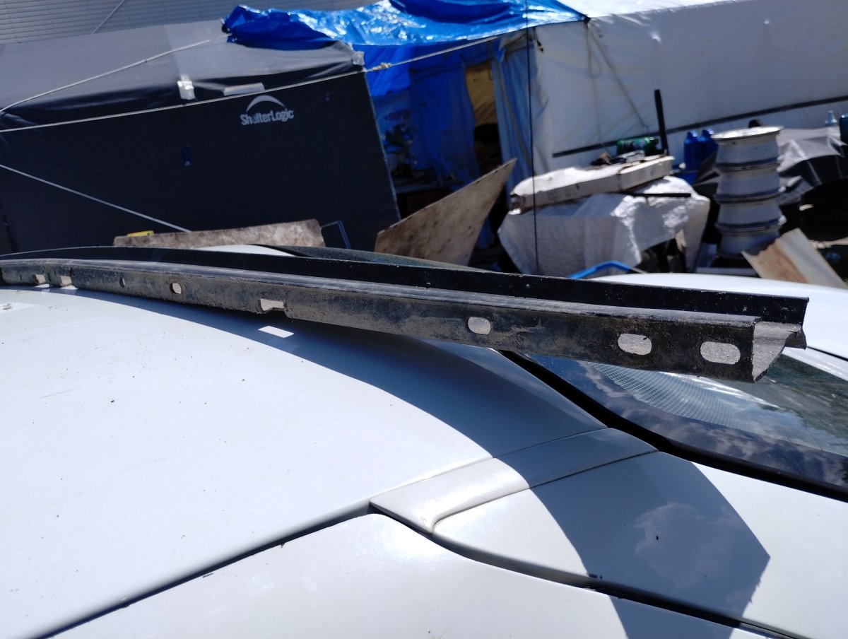

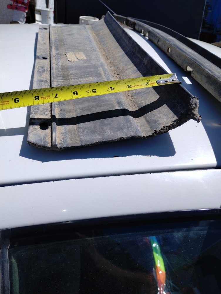

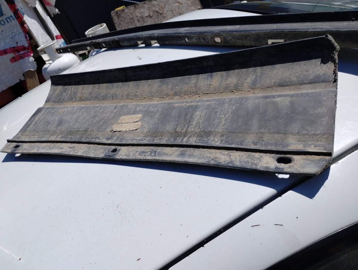

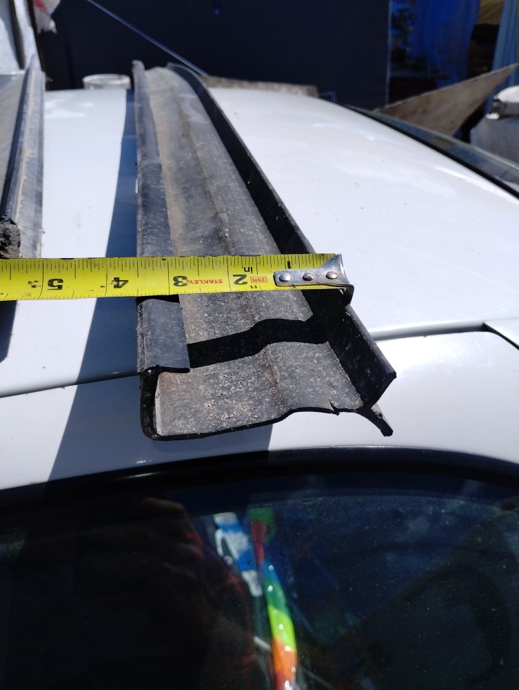

I'll take some pics and post them.
Pics;
The 7.25" wide one mounts on a horizontal surface, probably good for bumper.
The 3.5" mounts on horizontal from underneath, good for side under rockers.

Pics;
Ay these are awesome! I'll definitely be interested in coming to pick those up in Calgary this september if that works for you?
Don't want to make you go out and measure them again, but would you say the 7.25 inch is the same width or longer than the front bumper of a ranger?

I'll see if I can get more. Right now I'm not sure if I have enough of the 7.25". What I have would be 2 piece to cover the front of a truck or car.

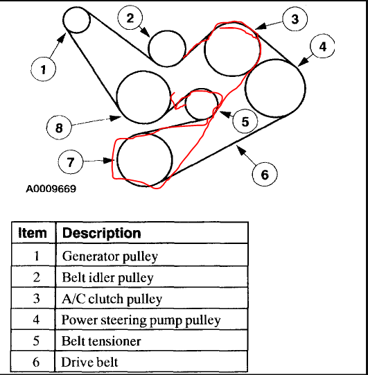

1. Power Steering delete only. I'm mainly concerned with the belt coming down from the AC compressor to the main crank pulley. To my eye in vehicle and in diagram, it looks like it'll rub against the tensioner as you can see from my terrible diagram.
Am I missing something? I know the ribbed side of belts can run on smooth pulleys like idler and tensioners, but I just can't think of a way to get this to work with existing pulley locations short of it clearing the idler?

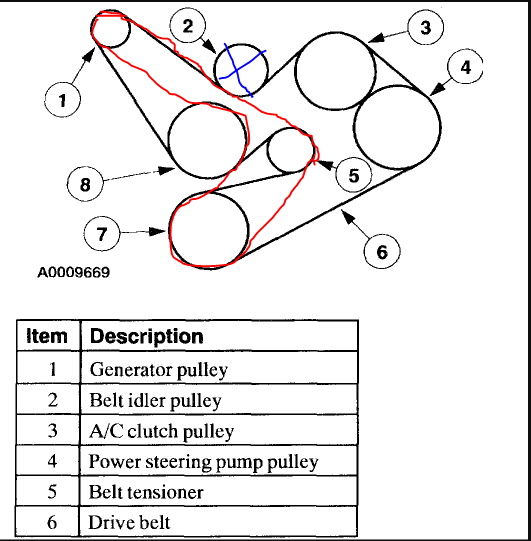

2. AC and Powersteering delete:
The only way I can see this working with stock locations is by using a double sided ridged belt, which who knows if they make them in the length I need. I could delete the Idler pulley and just have the tensioner (With a ridged pulley) using the following routing.
Question is, am I missing something? Am I just a part away from being able to use standard single-sided belts?

I think the best approach is to see if you will need an idler pulley for proper belt routing or if you will need to change out a pulley so ribs are facing where they should and the back of the belt where it should. Once you figure that out, you should be able to take and old belt and cut it to length to figure out the size belt you need to fit and run what is left.
Stock belt routing for reference:

if you end up deleting stuff though, you can get stretch fit belts so you could also delete a tensioner
I had heard of stretch belts but I've been pretty wary, I'm the kind of guy to always bring spares of things like belts, plugs and plug wires on big road trips.
What's the lifetime of these belts like?
i googled them but i cannot remember that. the video made me laugh because the way to install them looked just like the way you could put an alternator belt on an old air cooled vw that was running, with a screwdriver.
Honestly, a stretch belt might just be the way to go for both situations, I'll need to find the length I'll need for either scenarios and go through a bit of trial and error, but gates at least does in fact make 6 rib stretch belts in lengths up to 40 inches, which could be sufficient for my use case.
