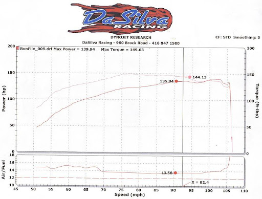

Question for you about fuel economy. If I'm on the highway driving about 55 mph I have a choice of using 4th gear at 3500 RPM or so, or I can use 5th gear at about 2200 RPM. Which is a better choice for fuel economy? I assume it depends on the engine to some degree, but I wonder if there is a rule of thumb that lower RPM = better fuel economy?

In general, lower RPM typically does mean better fuel economy, but with our trucks and their tuning I've found that below 2500-2750 these trucks are tuned really poorly and dump fuel.
MAB3L, the most reasonable truck on the road!
Based on this graph from Da Silva racing from a long time ago, on a mostly stock 3.0. As well as my own driving with a basic OBD2 scanner monitoring fuel volume. This graph is old, and I had to find a lot of the information about the vehicle by reading forum posts, but it's a 3.0 manual, with an indeterminate axle ratio, but combined with other graphs made for the 3.0 vulcan, it shows the fuel mixture leaning out around 2750-3000 just before/during the peak power band.
Generally speaking however I get my best results keeping the truck as low as possible within the given range of 2500-3000 RPM.
Out of the two options you listed, 2200 RPM is probably more efficient, but there's so many other variables you'll get a better answer from doing some fuel economy testing yourself.
If speeding isn't a concern for you, by going a few MpH faster you might actually see some improvement in fuel economy by raising your rpm to the lower side of that range.

This is the right take if you can't go anything but 55. However, if you can keep the revs between 2500-3000 RPM in either gear by safely modulating your speed, you'll get better fuel economy. Just remember you're not saving if you save 5$ at the pump, and have to pay a 100$ speeding ticket.
One of my best fuel economy runs at the start of the project was done at an average equivalent speed of 68 MpH, with large sections being done at around 89 MpH. I wasn't aiming for fuel economy then, but that run made me investigate what was actually happening with my fuel consumption.
On that run we got 10.2L/100KM or 23 MpG, which obliterated all the other results I had before starting the thread, and that was with winter tires in February, and no e-fan, ignition upgrades, or anything.
